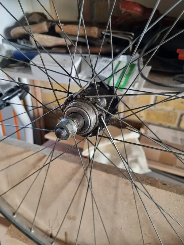

So the spacing between the dropouts is 120mm, and I managed to get the 3 speed freewheel off of the BHC defiance hub. So hopefully I just need to find a 5 speed hub that fits.
In accordance with what @Guinessisgoodforyou said earlier I assume this should mean I need to find a 3/32 chain 5 speed freewheel.
How would these typically be listed on eBay or such? (Mostly as I don't fancy trying to mess with the Harden Hub in case I can re-use that for the CB.)
Unless of course someone has a 5 speed hub that would fit they'd be willing to sell on (price dependant)
