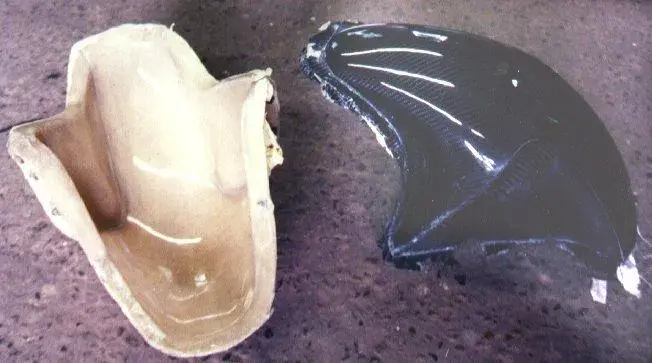

Here's my first mold and a guard pulled from it, multi part molds
are often best and if you don't have lot's of draft it can be difficult
to get parts out of a mold. The mold is three piece, the seams are
where the original guard had lines molded in so any marks didn't matter,
this comes out of the mold relatively easy.

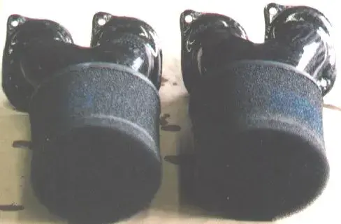

Someone mentioned carb trumpets, I did make some for a commando, no pics of
them. I have pics of the filter inlets I made for a ZXR, they were needed as the
frame and tank meant he couldn't have an air box. I carved them out of styrofoam,
molded over it and then melted the foam out with thinners.

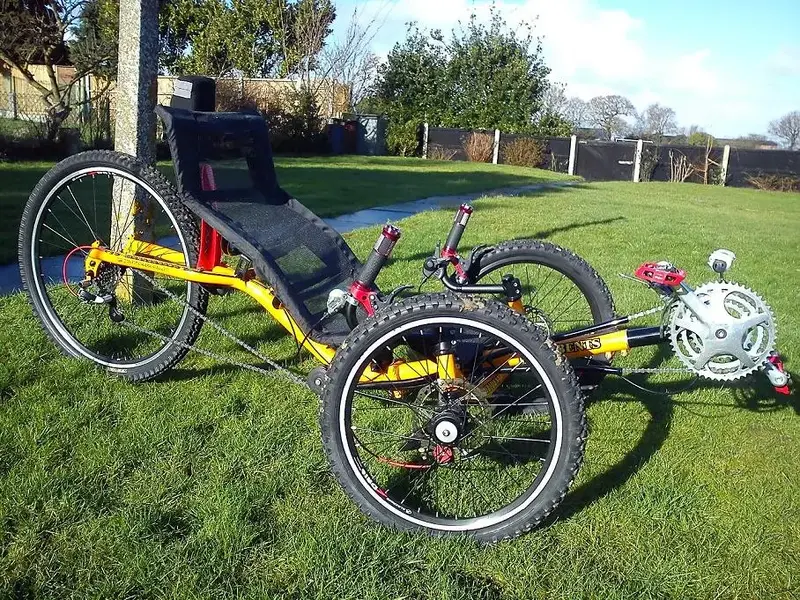

a really cool carbon moulded seat thingy for my recumbant////oh pleeeeease...my present one lets the look of the bike down

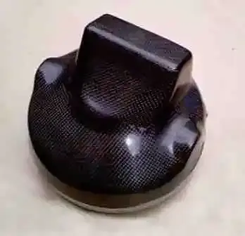

Day1
Hell of a lot of theory, followed by a couple of hours of laying up 8-plys of prepreg sheets..
1st sheet down
Got the other 7 plys down with a lot of effort and manipulation.. Tomorrow we're autoclaving it 8)

Re: Carbon Fibre.... Inspiration required.
GT-Steve":2makq4uq said:
Day1
1st sheet down
Looks good stuff to work with. I could only dream about cut edges like that with wet lay up.
I never had a go with prepreg.
