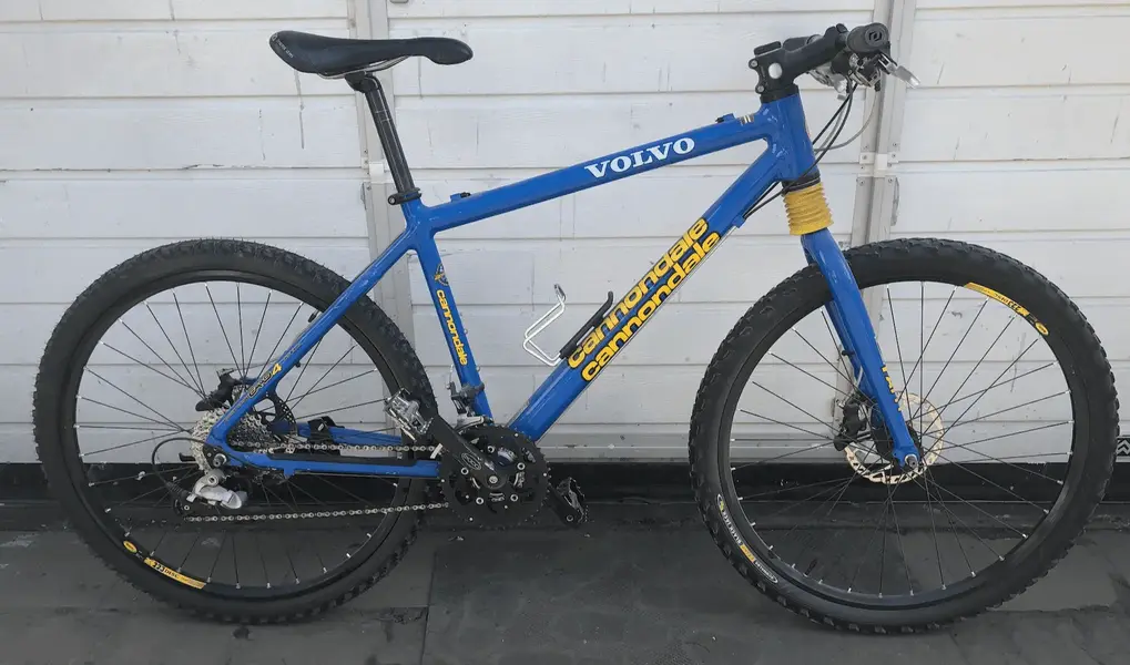

Hey,
recently I bought Cannondale CAAD4 in Cannondale Volvo team colours. I thought it will be easy to figure out which model it is... no, it isn't, at least for me..
Short spec of the bike:
- Fatty SL
- CAAD4 frame
- frame and headshock for disc only (no pivots and cable routes)
- frame has weird cable routing for rear disc brake, it is on the top of the top tube, and have two specific grommets.
My doubts come from this:
- 99 frames had pivots
- 00 frames had different rear disc brake routing
Any help is appreciated.
2001 Cannondale F700
Got exactly the same bike here -
viewtopic.php?f=21&t=397449
Ditched the Coda hubs and Magura Julie disc brakes as the were rubbish and impossible to get spares for. The discs/ hubs are 4-bolt which means nothing else off the shelf is compatible.
Rebuilt the wheels myself = Mavic 321’s on Gold Novatech hubs with black spokes from eBay. New rotors/callipers/ disc adapter/ shimano Deore levers - pre bled box set. Saved loads of hassle.
Cheers
boy"O"boy
It's a bit different than yours. This has Shimano XT disc brakes (M755), 6 bolt Coda hubs and different rear brake cable routing. And it has Fatty SL not Fatty Super.
characteristics that are complied with production in '99:
- rear brake cable routing
- it has Fatty SL installed. Fatty SL production was terminated in '99 (I'm not sure)
characteristics which aren't complied with '99 production:
- all frames I've seen produced in 99 had rim brake pivots as far as fatty's
characteristics that are complied with production in '00:
- brakes were introduced on the marked in '00 (it could be modified by the dealer)
- 6 bolts Coda hubs
- no rim brakes pivots
- cable routing is different than in '00 frames
- I think in '00 there wasn't Fatty SL, only Ultra and DL
I had the 99.5 F3000 Disc:
Caad 4 disc only frame
XT/ Yellow Sachs Wavey
Coda Tarantula cranks
Mavic Crossmax
SL fork
Coda discs
Volvo colour scheme
Volvo saddle
IRC tyres
Thanks @legrandefromage. Thank you very much. I think we have it. Mine has bit different gear but it might be a dealer job.
The bike I had was the shops demo bike, it had never turned a wheel so got it at a huge discount when the year 2000 models came out. I have never seen another one since.
The original Coda hydraulic brakes were AWFUL!! Should have got some Hope fitted straight away.
Spec & colour-wise it's a 2001 F700, but with mongrel V-brake cable stops to the top tube, hence the additional hose adapters.
Looks like something in between. Main Cannondale double logo is from 99. It has closed "c" There was a logo redesign from 99 to 00. Seems they were doing a lot of weird inbetween models. If you remember those NOS cannondale frames that poped up on ebay while ago.. some of them were also quite diferent from catalogue.
I doubt its 2001. Looks to me as disc specific 2000 CAD4 frame fited with last years decals that they still had and didnt want to throw out.
Thank you for comments.
I checked the serial number, it states: JG -> 1998 / July.
Do you know whether it is possible to decode more information from the serial number?
Logo, it has double C logo, as per vintagecannondale.com used from 1997 till 1999.
I'm wondering if it is a demo bike...
