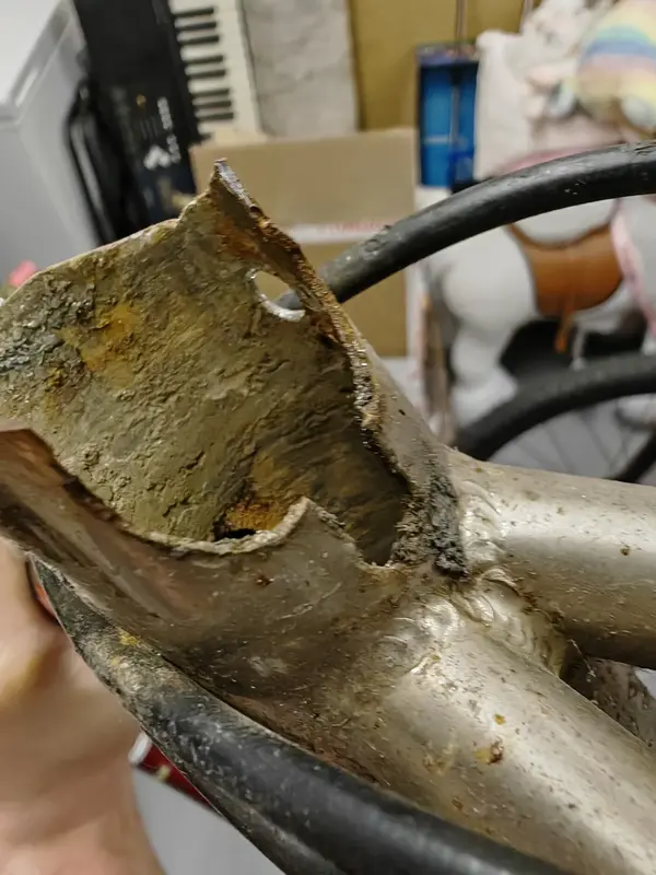

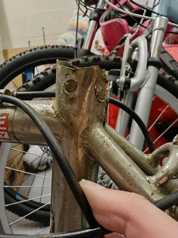

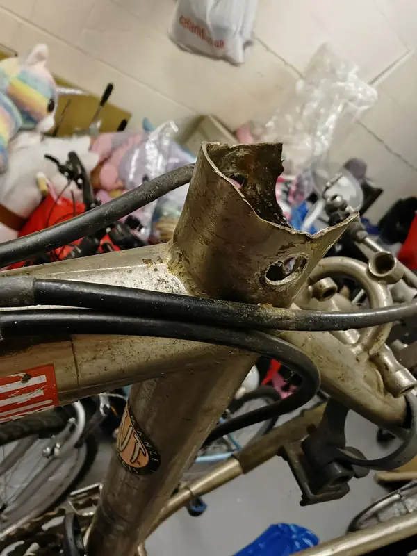

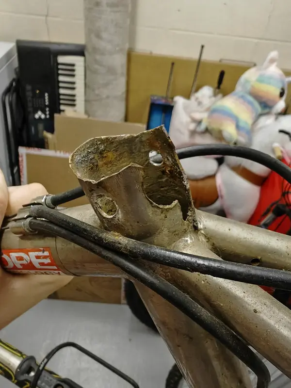

Apologies, I know I'm going off the original topic. I've taken a deeper look at the saddle post situation and it doesn't look great. I've taken some more closer photos of the frame with the seat removed. There's a little meat left but not around the full circumference.
I'll attempt a new collar in the mornimg. The remaining lug was already split and just fell off then the seat was removed.
Is it possible to get seats with posts that can be clamped further down the frame as opposed to the top? I get this means more stress at the top where the collar used to be. Any suggestions?
Thanks

You can glue in a sleeve and use a narrower post - I've seen it done a couple of times- often taking a 27.2 post down to 25.4.
Should be easy to find a tube with 1" internal diameter, and if the od is something standard, you can glue it in and fit a seat collar to that, then a USE post.
Gotcha. This parts all new to me but I know what you mean. So find a length of tubing that has an outside diameter, the same as my current internal diameter-27.2mm. Slide into the frame, coated with something like eproxy (assume this is what you'd use?) leaving 2 or 3 inches at the top where I can then get a 25.4mm seat post plus a new collect and use that.
Just to add, I tried measuring both the internal diameter of the frame (not very accurate as damaged), along with the outside diameter of the existing seat post, and I got 29.8mm on both.
Having already looked for collars etc, this didn't stand out as a common size.
Nearly always inch equivalents.
Of course the epoxy has fantastic gap-filling properties, so it can be smaller.
Nearly 30mm you could use 1&1/8"od, 1"id, with 28.6 seat collar👍
