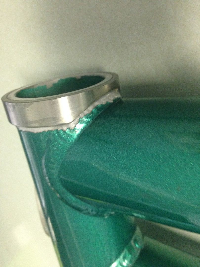

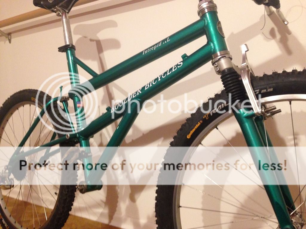

Re: Boulder Intrepid AL (REPAIRED)
After weighing all the options (and my wallet) I decided to ship the frame over to Vancouver and have Chris DeKerf do the repair. He epoxied titanium rings on the top and bottom of the head tube. Because there wasn't very much tube extending beyond the welds he had to scallop the rings around the welds. I think it turned out really great and I am now confident to continue this project. Chris has done this repair on the aluminum Yetis with great success, and I have faith that the frame is now ready for years of riding ahead.
I actually think the titanium rings complement the Gazelle head badge, and I am going to leave them bare.
Next step is to match the paint for touch ups.

Re: Boulder Intrepid AL (HEAD TUBE REPAIRED)
He didn't offer, and I didn't ask...
I've got a pretty good paint match now, and will do my best to touch up myself.
Wow...pretty impressive repair. Especially to fashion the Ti around the welds.
Can't wait to see her built up!!
I so pleased for yah, would heve been such a shame to leave it as it was
Your right the repair doesn't look out of place, and with some sensative touching up in the paint dept it will quite a stealthy job.
Looking forward to seeing this one built up now

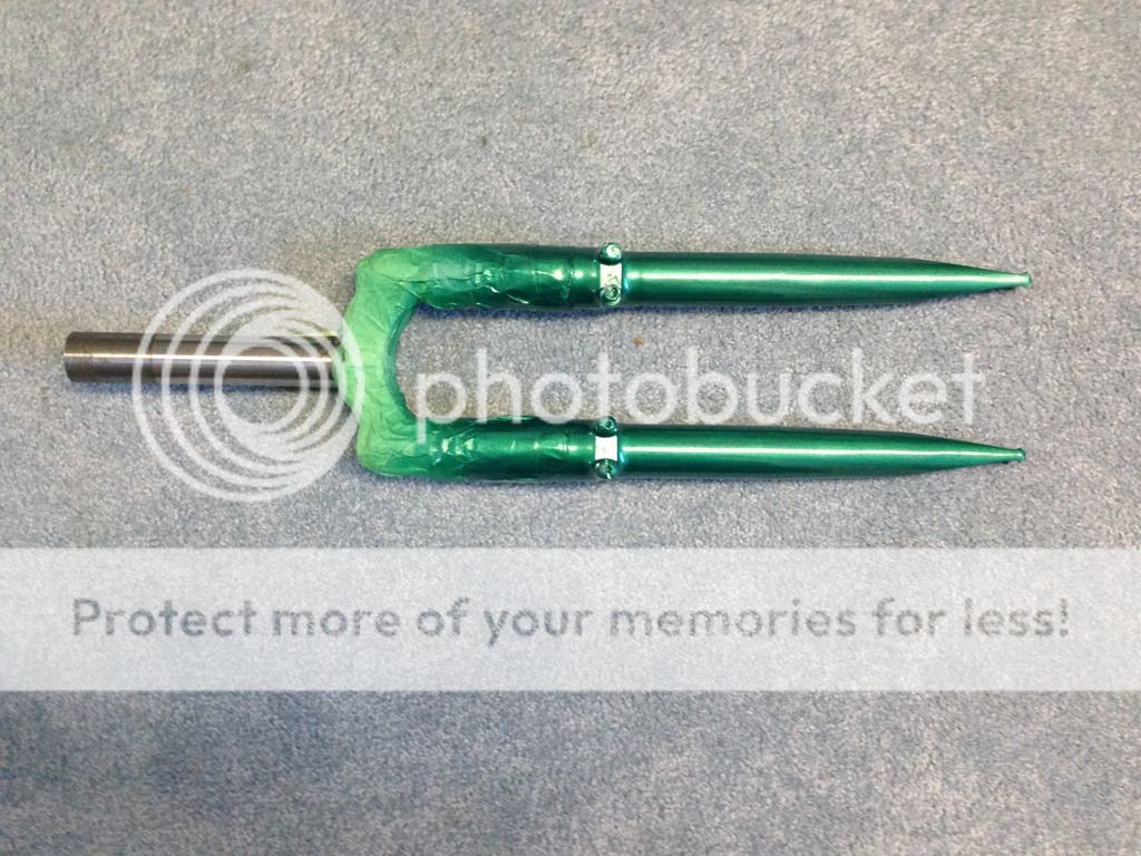

I had the paint colour matched quite well by a local auto detailer, and did my best to touch up the areas where the paint had been chipped back to allow for the rings to be installed. It went all right, but because I was brushing on the paint the colour and finish were not perfect. I was using paint out of a spray can that I sprayed a puddle of then painted on with a small brush. Because of the metallic paint the colour varied a bit. I didn't want to tape and spray the head tube entirely in case the colour wasn't a perfect match, which it isn't, quite. I sanded, wet sanded, and used polish to get the finish to match, but the metallic ended up being a bit 'swirly' due to the brush strokes. But unless you are squinting it is hardly noticeable...

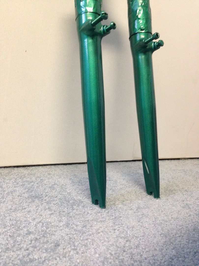

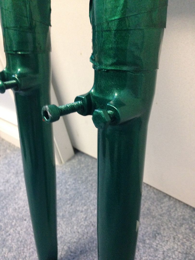

Once I determined that the colour was a decent match I decided to do the forks, since I didn't really like the original colour of the Rock Shox Mag 21s with this frame. Plus most Boulders tended to have forks matching frames.
So I peeled off the decals and stripped the paint with stripper. Easily done. Then sprayed 5-6 coat,. and hand polished. I think it turned out well...
