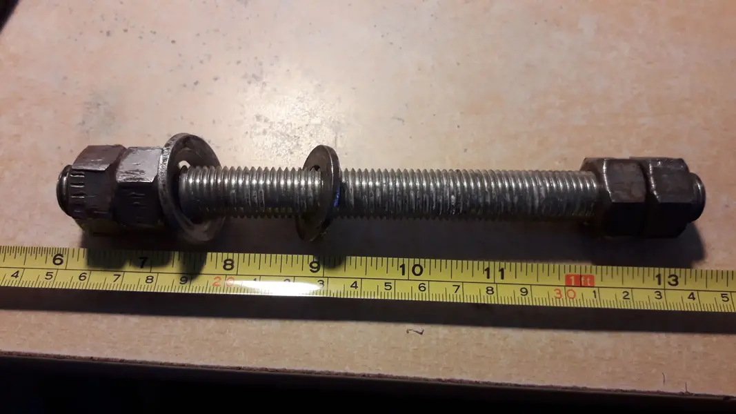

Having given up trying to source a specific tool I opted to go with some of the suggestions here and set about with various punches and a hammer. After getting nowhere fast and having hit my hand a few times I went for the bigger 4lb club hammer.

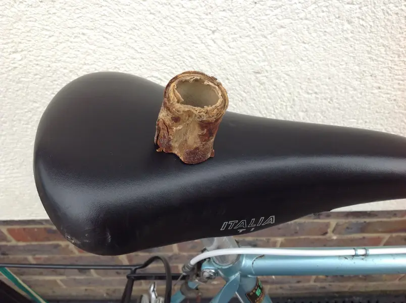

Well, it was not going to budge and I had to regrind the burrs off the punches a couple of times but eventually it started to shift. Would you believe I had to use the punch right until the last thread as there was no free movement at all. With the adjustable side off I was able to remove the axle and bearings and a funny cardboardy type sleeve (photo attached). I then went with the long bolt and two nut method as suggested.
I made the mistake of using some washers first but just couldn't get it tight enough for friction to work so dropped the washers and proceeded again, this time with success.

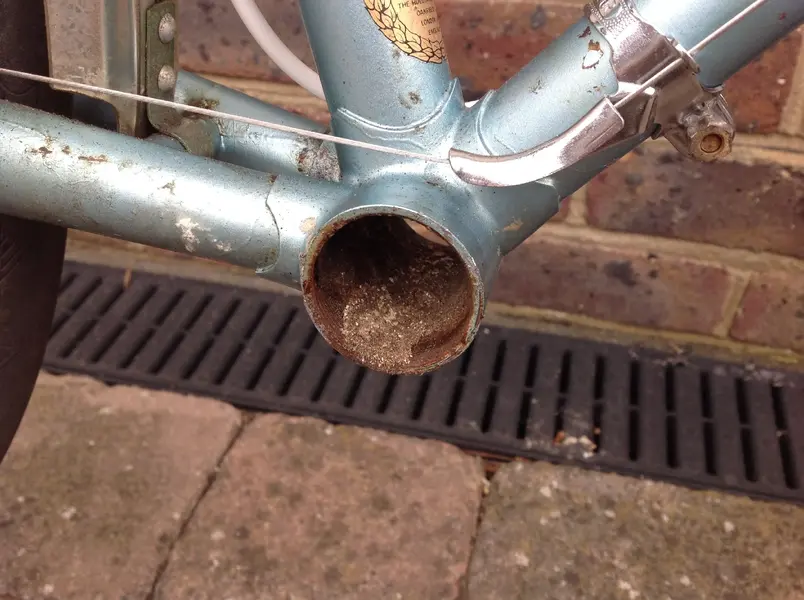

The cups themselves are in great condition but the bottom bracket looked like half of Brighton beach was in there! Heaven knows how that grit and sand gets in there (photo attached). I have since cleaned the bracket as best I can with an assortment of brushes and rags but it doesn't quite feel good enough and I would appreciate any suggestions here? Without greasing yet I can wind the cups in by hand but they are not as smooth as others I have seen.
Does anyone know what the cardboard sleeve was/is for? Does it need replacing and if so with what?

The tube is just to help keep bits of crud / rust out of the bearings. Not strictly necessary, no
I've got several 'concertina' style plastic sleeves that fit traditional BB's and help to protect against muck and bullets getting into the grease and bearings from down the seat and downtube. That's probably where your Brighton Beach grit etc. came from - although there does seem rather a lot! If you don't have a plastic sleeve (you can cut one from an old washing up liquid bottle, a card one is a last resort!) then smear the centre of the axle with sticky grease which hopefully will 'attract' the muck and hopefully stop it migrating into the bearing surfaces.
If you want a laugh, check out the price of a flimsy nylon tube that happens to have Campagnolo moulded into it and calls itself a "C Record" (everything has to have this prefix on eBay regardless to help raise the price) "Bottom bracket sleeve, used". The description may add that it is infused with genuine Italian grit.

Lots of thin oil and an old toothbrush and a bit of elbow grease will have that thread as smooth as silk, though.

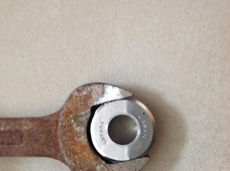

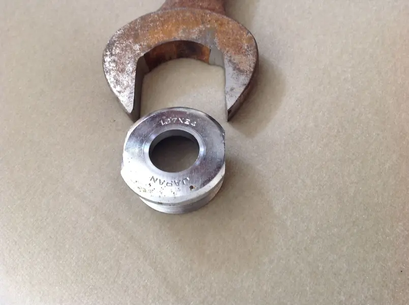

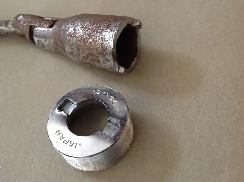

Because of the difficulty in finding a suitable spanner I decided to make a tool for use with the two pin adjustable cup. Its not the prettiest but I found an old plug socket spanner and ground it down to leave two pins which works just fine. Ditto with the fixed cup, I had an old 30 spanner and just ground it out to 35mm. Happy days!

I knew there was a use for those (otherwise useless) plug spanners. Well done!
What are you going to use for the lock ring?
