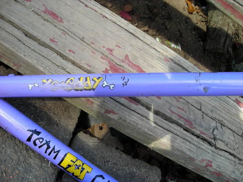

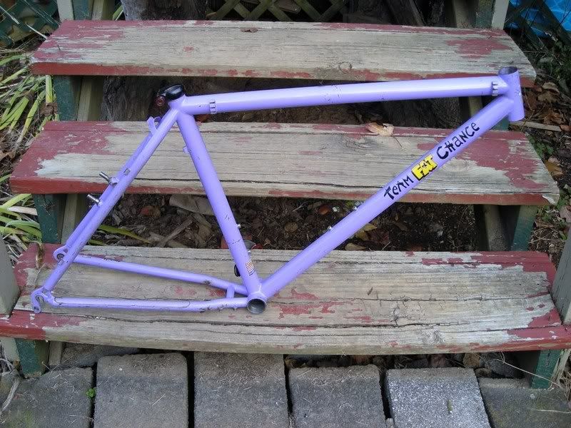

Its got a small dent in the top tube from the bars but I assume that it can be filled when it goes for new paint :?:
So, fatties - paint - who's the best lot to send it to and what sort of costs am I looking at.
Was thinking of brown with a gold overspray, fitting the RS1's up front & painted to match
Oh and decals :?:

and i like as it is.. don't repaint! the scars on it just add character. dress it with m900 xtr, syncros (tougher looking than ringle), marz bomber(coil!) and conquer the world.

A'ha frame number is 345Y4M.
so tell me, is that the 345th Yo in 1994 in a medium then :?:
Its got a 1" headset too, didn't think they would still be inch by then :?:
As goes the frame colour I am still debating - maybe I will like the violet when it turns up, dunno - but I think it deserves new paint and decals, not keen on battle scars unless they are my own :wink:

Retrobikeguy,
Congrats on the Yo aquisition...will be a lovely frame for you. A bit of info per your questions...
- yes, the dent in the top tube can be filled with 56% silver and gently sanded so that you would not even know it's there. Insure that silver is used, as the temps for brass would be too high for the thin portion of the top tube the dent is located in.
- A BOI or YO fork will run you 285.00 dollars in powder black, 315.00 in any single wet color.
- A HO Down fork, a box crown with 1.0" legs and scalloped dropouts (everything that was beautiful in a vintage Fat fork rolled into one), is 275.00 in powder black or 305.00 painted to match.
- the Team violet color is quite stunning, especially when viewed in the sun as the violet has a red pearl added to the clear coat that radiates in and sparkles to your eyes delight. I'd definately keep it for the respray. A team Violet paint is very difficult to match, however, as there were at least six different shades that I've seen as the paint was hand mixed each time. They do not differ much, but just enough that you can tell.
- Decals come in a variety of flavors/colors, and are 36 bucks shipped to the UK.
- Make sure when the frame is refinished that it is properly prepped and protected against mean old Mr. Rust...Ededwards had a thread on this a week or so ago.
Should be a stellar project...good luck!
Rody
