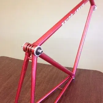

I have an HQ here with the perforated bracket, the BB is still the original ,
Serial Q4407
This HQ is made from 753, Back then Raleigh allowed Harry to experiment with 753 and then report back the results. Only thin, HQ was not allowed to put the 753 sticker on it.

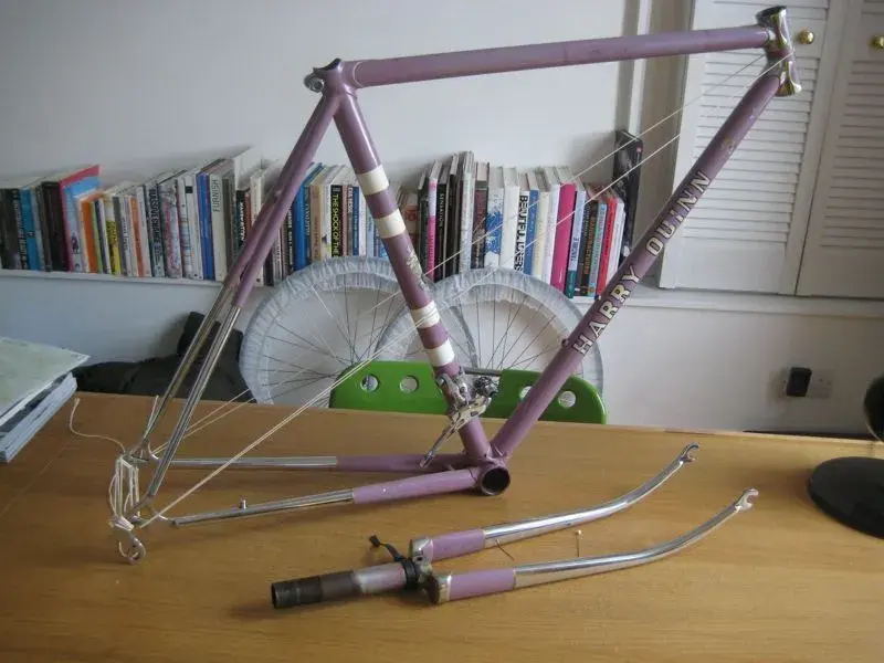

Lovely frame indeed. I was most intrigued when it was for sale on HS's site as I have a near identical frame. Albeit one struck by a shrinking ray! I bought it for my wife as a complete bike just to get the wee frame, it's only 50cm square. Tiny!
It has same lugs (sort of, read on), crown, shot in stays, chrome in same spots. Mine has rear Campag vertical dropouts and spaced about 124/125mm (maybe spread from 120). Braze on for front mech cable, but not for dt shifters. The main difference (other than no drillium / cutouts) is it has longer point lugs than yours. Yours probably had the points cut shorter for weight saving. (Unless they're a different model and I'm mistaken) So maybe the drilling was even done originally too? As if the lugs were shortened, weight saving was obviously in mind at the outset. Although I think you established that as unlikely?
Curiously, mine is drilled for allen key brakes (done later perhaps). It came with modern (ish) Shimano parts mixed with a couple bits of earlier NR Campag. A Campag Strada chainset that date stamped '73 which I've thought likely original and used to roughly date the frame. Mainly as the all important serial number is Q2914. If you check it out on the HQ registry you'll see it lands right after a 1972 frame. Interestingly, it once belonged to Southport CC as you can make out where transfers had been. Maybe it was ridden by someone here once!
I also have on the registry, well built up for my dad, Q2503. Guessed at 1963 for that one as it came with all Record from the very early '60s. It's fairly forward looking too. Sloping crown, plain prugnat lugs, fairly close clearances, and nice brazeons to suit barend shifters. Guess Harry was always looking ahead. It's over here, just put some photos up so you could see if interested - viewtopic.php?f=12&t=240112&start=10#p2189186
Anyway, not sure this helps any. But thought I'd share. I'll stick up a photo of the tiny one similar to yours tomorrow when I can take one in the light of day. Let you see the comparison.
Good luck building it up! Cheers,
Daniel
Here you go, this is my wife's very similar frame (excuse the very amateur tracking check). Head lugs are more different that I thought.
