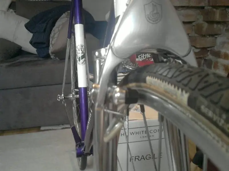

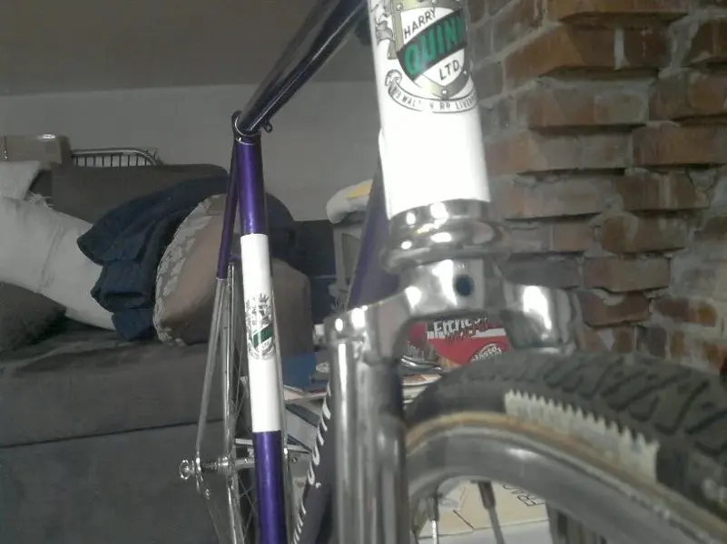

-Clearances:
On its feet with a pair of sprints (these are Campag/Mavic Monthlery Pro). Excuse the mess in my attic
Clearances are tight for the 60s and much more like current clearances. But that is in keeping with Hilary's writeup and description.
Front brake
Rear brake clearance
Front with an early 60s brake caliper (no way could I get the shoes up enough to bear onto the rim)
And with a short drop 80s caliper. Would fit easily (if I were to adapt to nutted fittings - its definitely NOT set up for allen key fastenings).
So, on balance, this seems to be a very 'forward looking' 60s frame with distinctly modern features combined with traditional wheel spacing and RD facility.

Lots of people used Weinmann 500 brake callipers for bikes like this in the 60's. They should fit perfectly. The GB centrepulls are rather deep.
Thanks Ned. The GBs were easy to find in my stash of bits, but I rather felt they weren't quite the brakes the HQ would have had. However I do have a pair of Weinmanns but they are later 70s/80s with the black plastic retaining nuts. I want some nice shiny brakes for this frame!
To be honest I'm learning fast about 60s frames and the period equipment. Bit of a learning curve but I'm enjoying it and all the comments help enormously!
HW

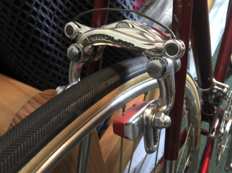

Universal Mod 61?
Mafac Racers coupled with Universal levers were a popular choice on top end bikes back in the early 1960's
Griff
You know elbow grease, a lot of... ;) and here's an example of a shiny Racer:
Universals are one of the centrepull brakes with shortest reach.
