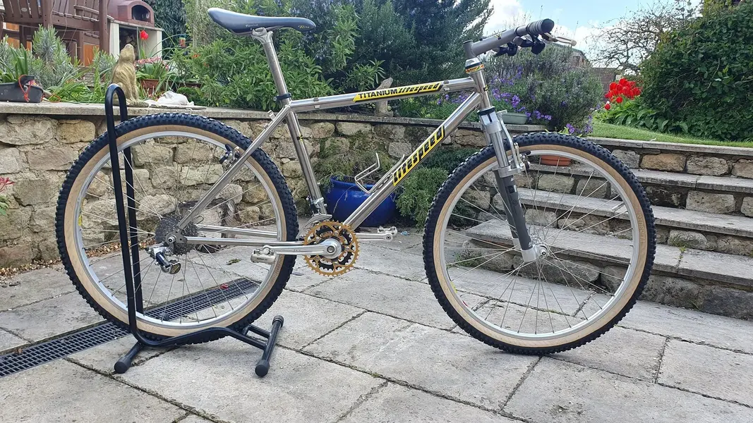

Austrian Litespeed Find
Combined trip to the tip( oh the excitement 😅) and Gil to pick up the decals...looking a bit more like it now

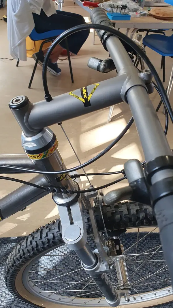

Just starting to cable up and pondering whether I should use the stem cable guide ( it wasn't used before) and how long the cable outer needs to be ( below shown for illustration so you can tell me how much I need to lop off)
I like to keep it a nice smooth curve, think you could probably take a little off that so it doesn't go too up then down, if you know what I mean :)

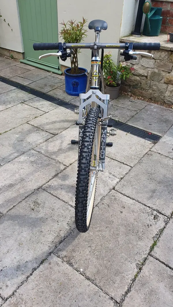

Am I being really thick?? Setting up the cantilever brakes threading the cable through the stem. When the suspension is compressed the cable tension is lost and so is the brakes...what have I done wrong? 20230909_110720.webp
