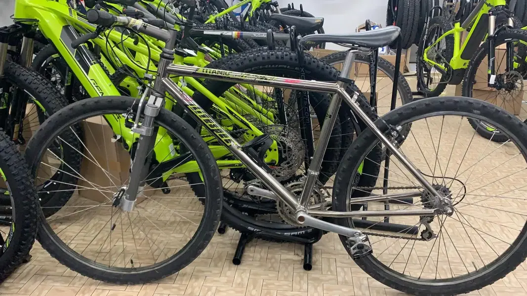

My best mate finally made it over from Austria so the Litespeed has arrived. He'd already deconstructed it for travel, so just a case of unwrapping it and checking over. 20211104_091847.webp
Apart from needing new decals the frame is in really great condition. The Manitou 1's are obviously solid so a bit of work to do. Everything else is Suntour XC pro micro drive apart from Dia compe 956 cantilevers. Looking at the Suntour Levers and Thumbies I never realised what nice bits of kit they are. 20211104_091835.webp
I still intend to replace the groupset though.
Only negative is that the seatpost is 26.8 so my nice 27.2 TNT seatpost will not fit🤔

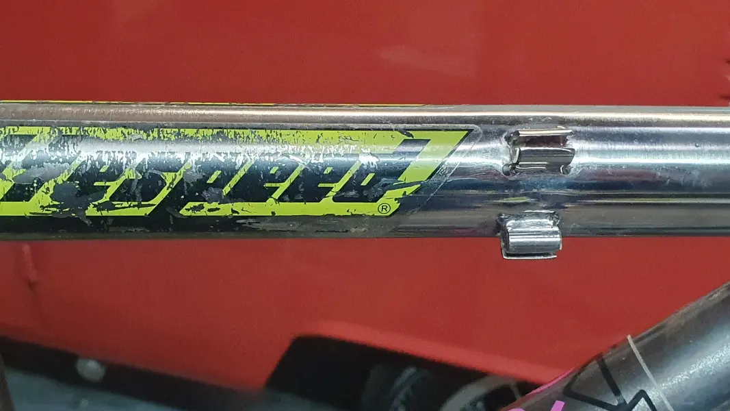

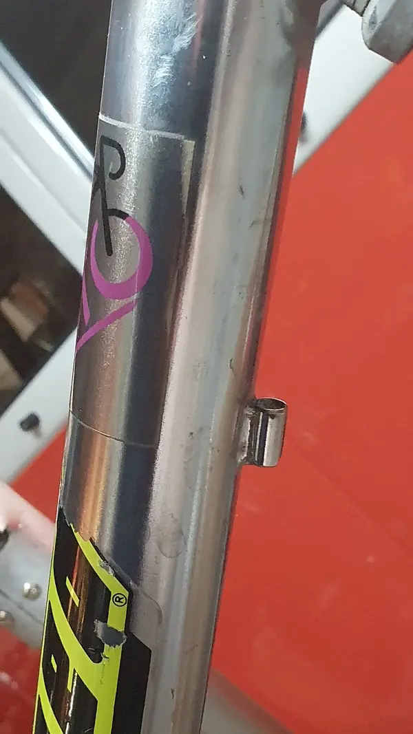

Just checking the serial number. I thought it was a 1992 but may be a late 91 or very early 1992
Cable routing doesn't appear to be the same as other 92's as the front mech cable is routed on the downtube ( I don't know if Litespeed offered different cable routing options) 20211106_145253.webp 20211106_145258.webp
The headtube is also 1 1/4" shimmed down to 11/8" for the Manitou 1's
