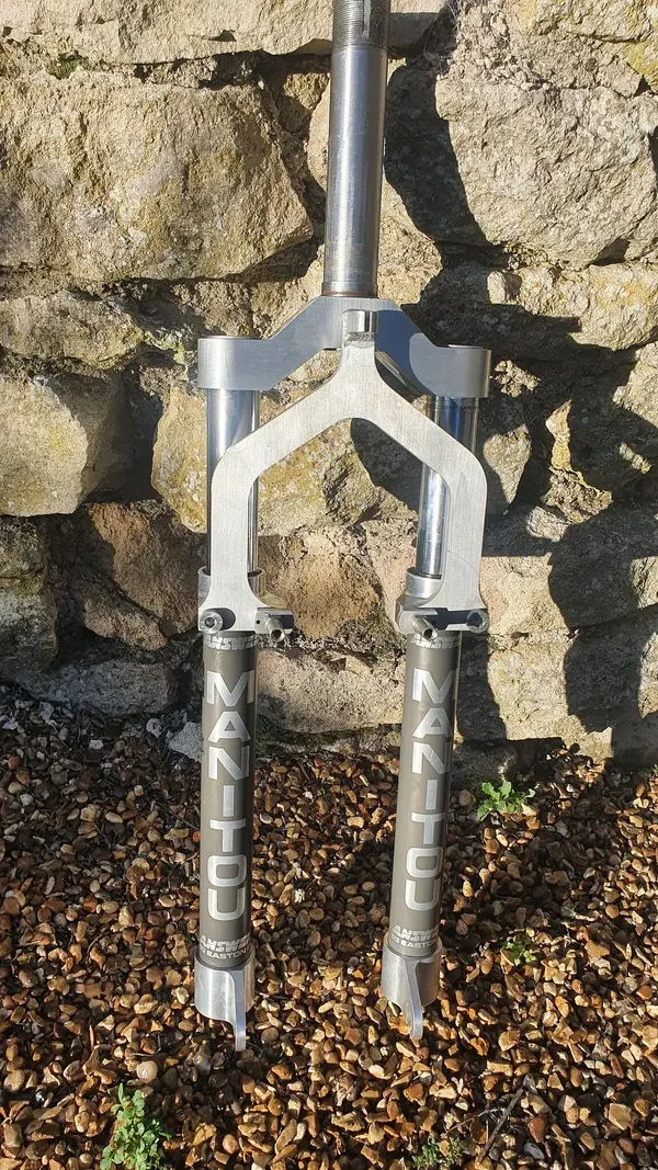

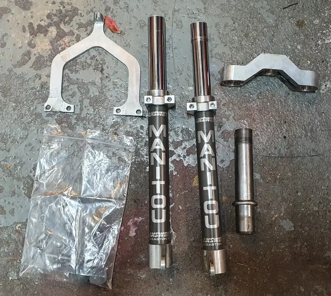

Manitou's apart, took a fair bit of persuasion, got the legs moving which is a relief. Just ordered a shock off long 5mm hex key to separate the stanchions from the legs then we will see what sort of goo the elastomers have turned too.

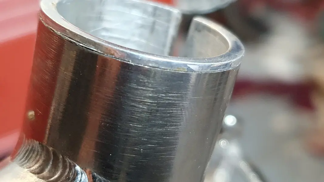

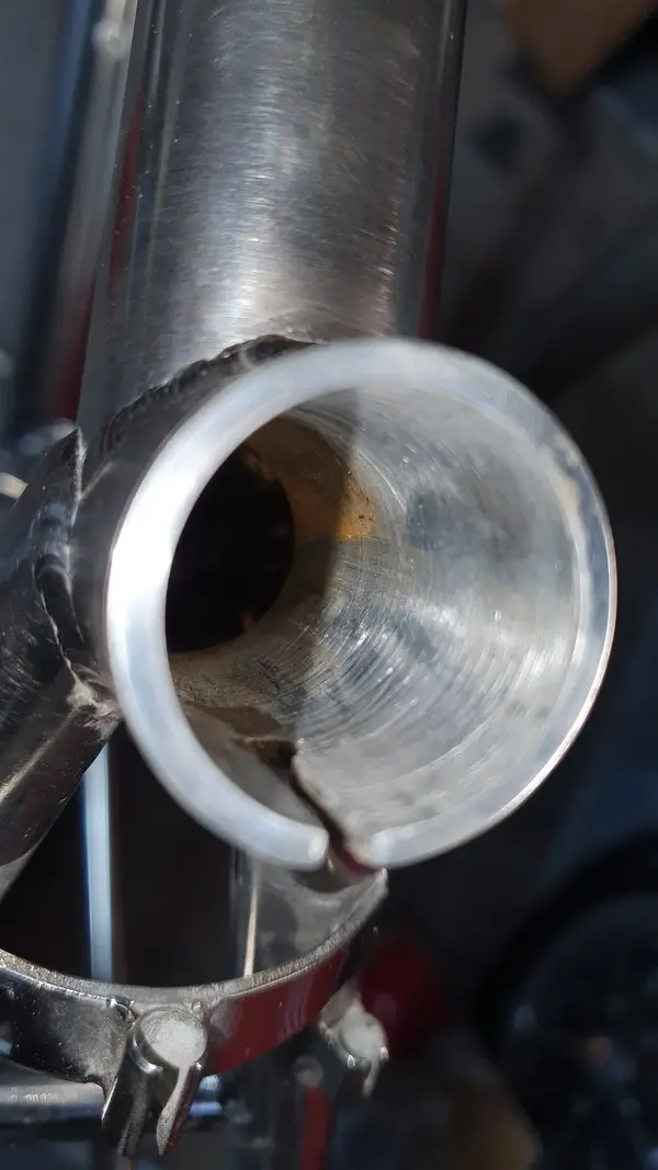

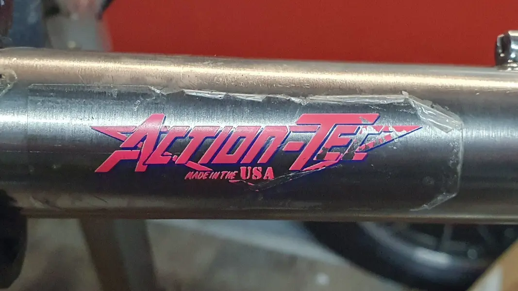

Realised that the seat tube has an alloy shim, 20211107_160016.webp 20211107_160114.webp

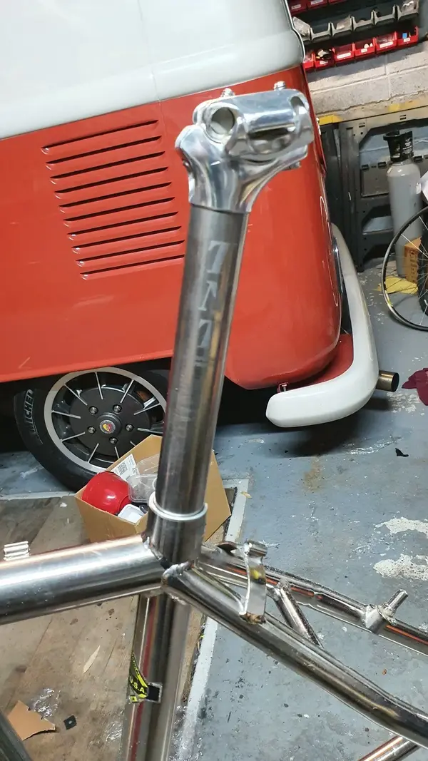

Looks like you could specify seatpost widths from the factory as I always thought Litespeeds were 27.2. The shim is about 7-8cm in length and about 1.5mm thick so I thought reducing it by 0.2mm wouldn't be a structural problem, so spent an hour reaming it out and voila...
Was a bit gutted initially when I realised this was too big, but all is well again

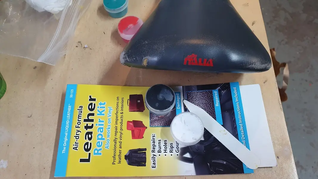

The Litespeed came with a grey Flite Ti , in reasonable condition but with a little chunk missing at the back 20211109_145155.jpg
So dug out the leather repair kit and glued in a little patch
Just got to order the right colour leather restorer next.
