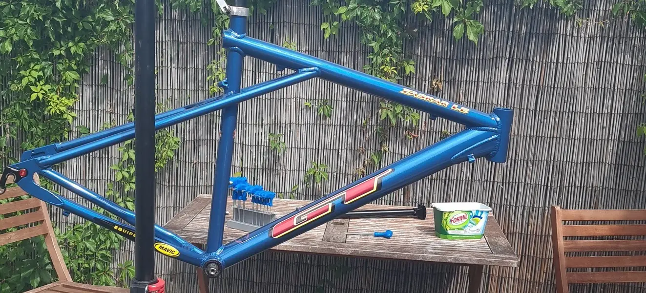

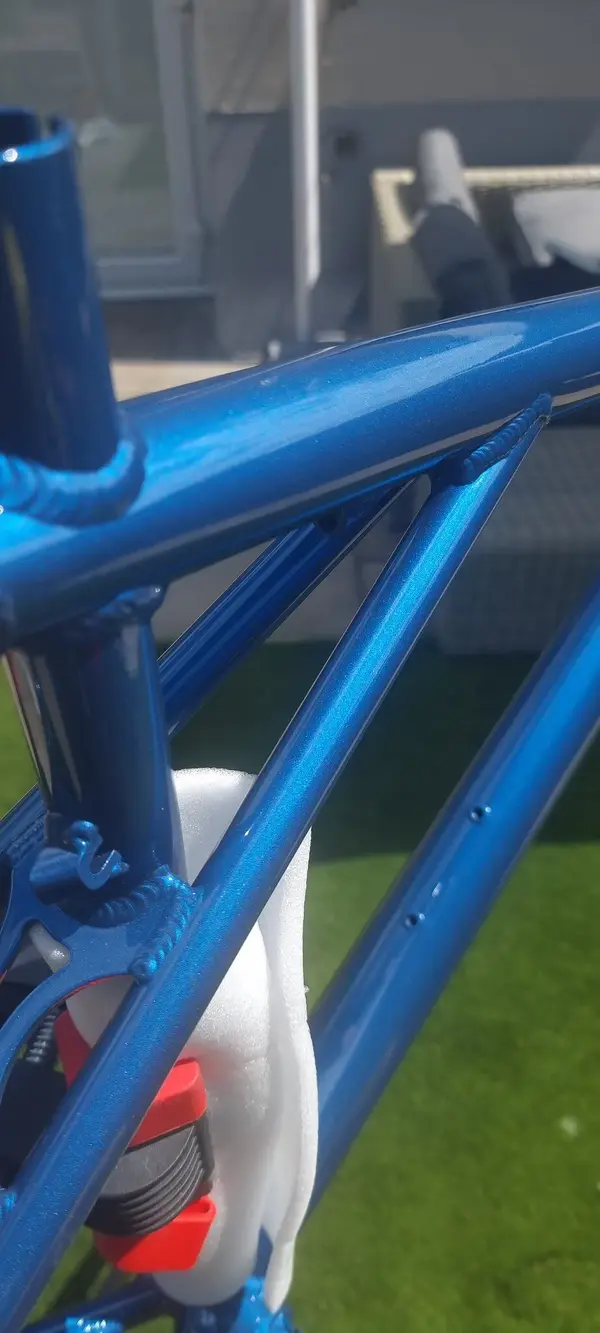

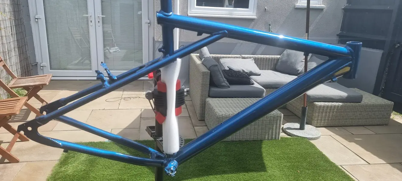

hi,can i ask what is the wet method?? i have had to apply new decals lately to a zaskar frame which i thought would be easy but the bubbles!!!!! and once they are applied thats it to late lol,a few smaller decals i have done to crank arms and bars are fine but i have another frame i need to do and any help would be great thanks
there's a guide linked by peachy earlier in this thread ;).
as for the bubbles, get a pin or fine sharp needle, prick the bubble, then carefully squeeze out the air with an old bank card or plastic filling tool.
if the bubbles are close to the edge of the decal, carefully "push" them towards the edge then outwards with the plastic tool or bank card.

ok thanks will try and will look for peachys thread
I must admit I was highly sceptical and had it not been put forward by Peachy I wouldn’t have even tried the wet method
But I did and it’s so so much easier - no more alignment problems or air bubbles as you can work the decal for a short period of time almost like an fashioned water slide decal on airfix models

The deed is done. (pics tomorrow in the light) my first attempt at this is not perfect but wet application is certainly the way forward. One CRUCIAL thing for anybody trying for the first time... as mentioned in Peachey's video ... The application of kitchen roll on the freshly applied decal to absorb excess water. afterr the initial wrapping, i proceeded to dab the decal for a minute or two just to make sure the edges were flat to the frame. Great vid peachy.
