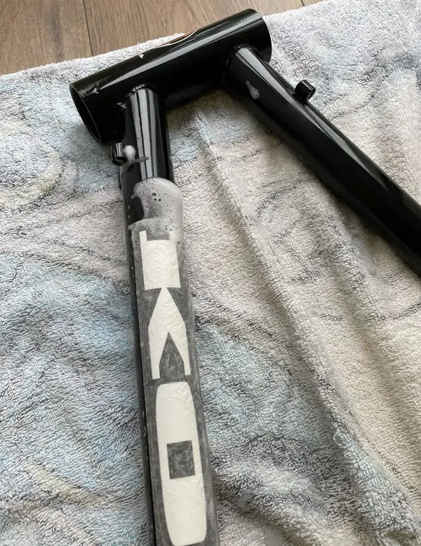

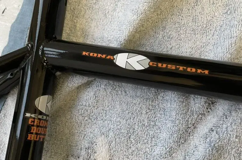

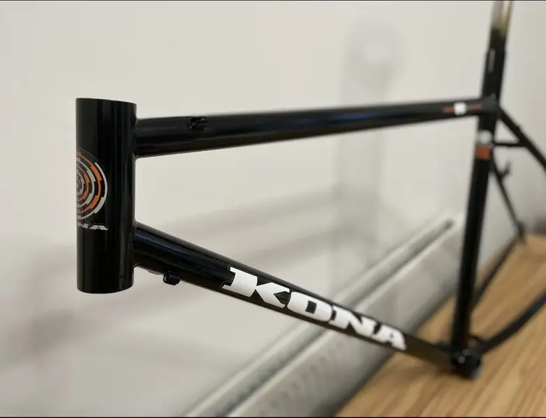

Applying decals...
Come on, photos please šŸ˜„
I’ll update the thread on the lava dome whith some better pics later but these are ā€œwork in progressā€ pics…

Did you find it a useful technique?
Oh definitely!
With the time it takes soaking the backing paper on the frame it takes 5 times longer but that's more than worth it for bubble-free, accurate placement. I still have the forks to do...ill be doing them wet 😁
BTW, how long before you can start juggling the frame around? I still have some final paint cutting to do but I'm weary of handling the frame and disturbing the freshly applied decals.
Hard to tell, but then if you do accidentally move something you can just start again & re-apply it.
