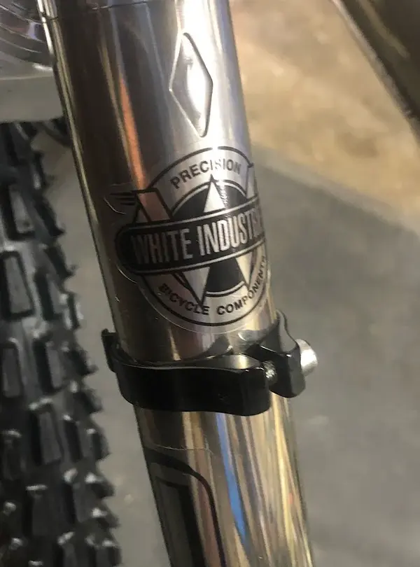

Popped back into the workshop just now to put the sticker where I really wanted it :D
