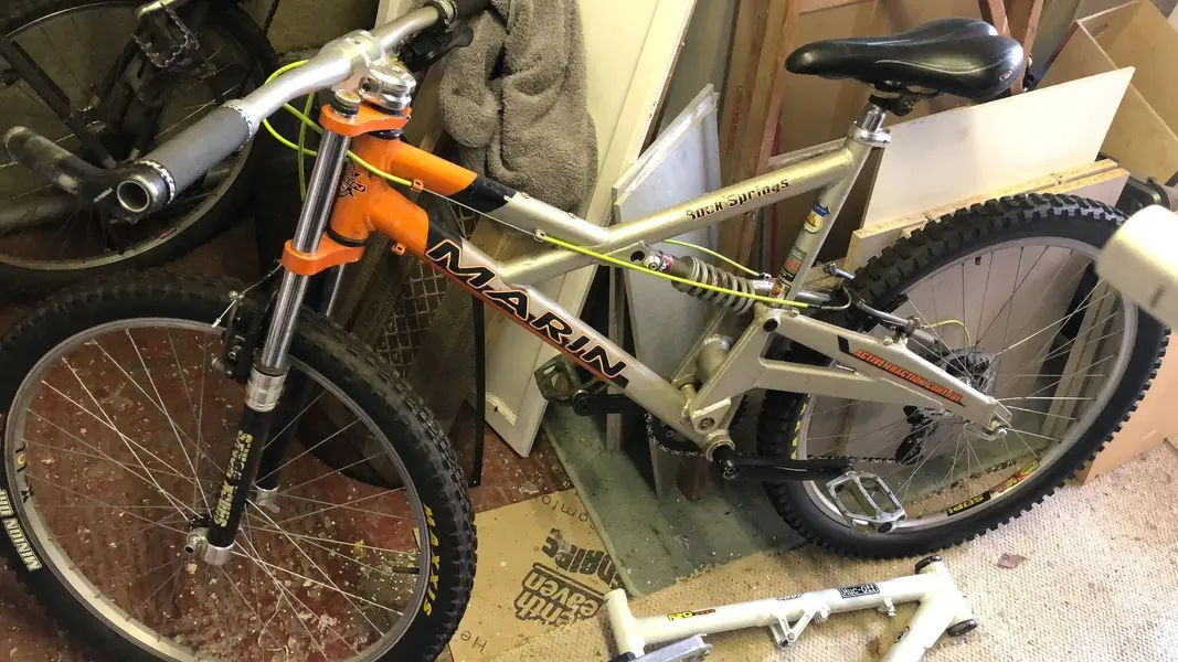

Another Marin “build” - Rock Springs (MY 2000)

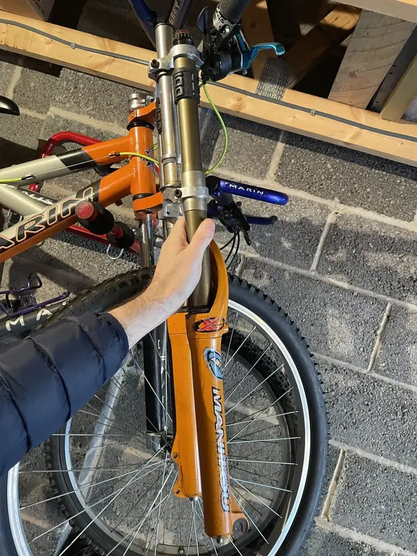

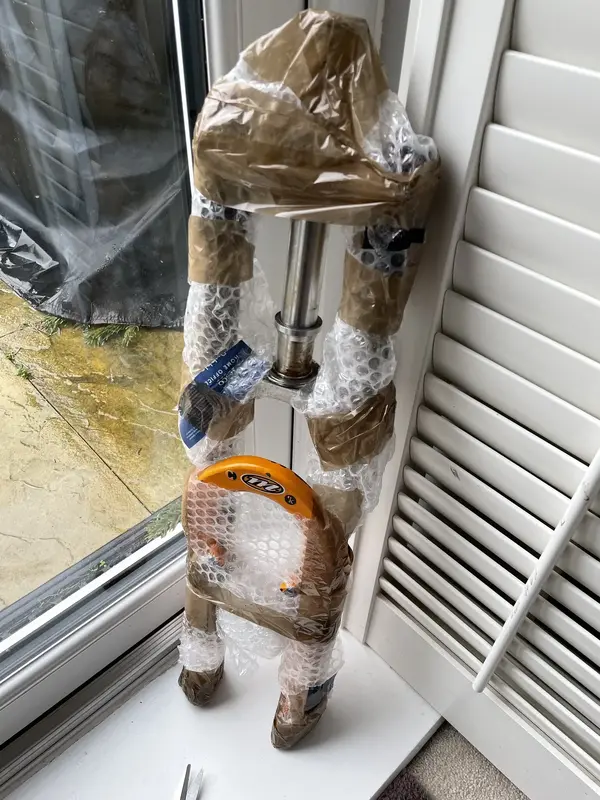

Unfortunately after a ride at the weekend (road only) and some feedback from a friend it still has some issues to fix. The most catastrophic being the front suspension somehow locking out hard at 30mm travel. Looks like they’ll have to come off and since spares are none existent might end up trashed. I have another set of forks ready to go on but they aren’t triple crown :( plus they are disc only.

Looking for replacement forks and possible a fitting WTB saddle, not sure if they ever did ones with orange edges? Or just red?

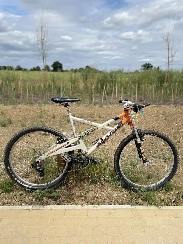

Still waiting for the new forks to go on, but getting some good use in the mean time. Love this bike!
The Avid Vee brakes are spot on and the 1x Zee just works so well. Minion Tyres are really really good too

Build spec updated…
Now fully built - updated build spec:
Drivetrain:
New Zee shadow rear mech (10speed)
New Zee 10sp speed shifter
New SLX 10 rear cassette 11-36t
New KMC 10 sp chain
New Jagwire pro shift cables
DMR V8 pedals (V2)
Shimano Tourney crank
Amazon special “snail” wide-narrow ring 38t
Frame:
Marin Rock Springs (2000) Ovation Aluminum
“Show only” Shock Works front shocks (to be replaced with a nice dual stanchion Manitou pair)
Fox Vanilla 185 rear shock with spring
Controls:
Funn 810 full on riser bars
DMR defy 50mm stem
Nukeproof lock on grips
Diddy Tioga bar ends
Brakes:
Avid Single Digit 7 vee brakes
Avid SD 2 L levers
Jagwire green cable
Wheels:
Mavic 517 on XT hub rear
Alex front on Ridgeback front hub
Tyres: minion DHF and DHR
Saddle and post unknown
Updated the build thread
