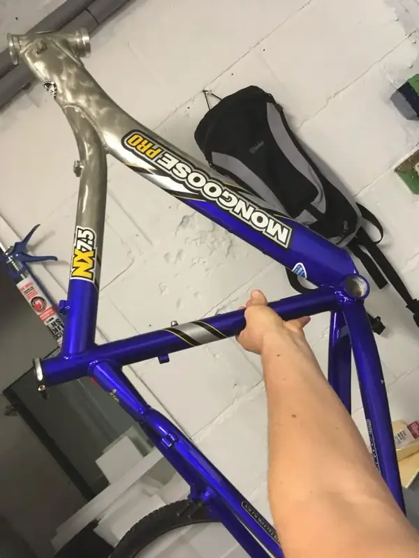

Help me spec my build… Please!
Thanks! I’ll have a look. I need to make a choice, I’m getting itchy feet. I’m already planning the next project. (I really fancy a Sun Bmix… Doesn’t really make sense to go SS on the Mongoose with this in mind)

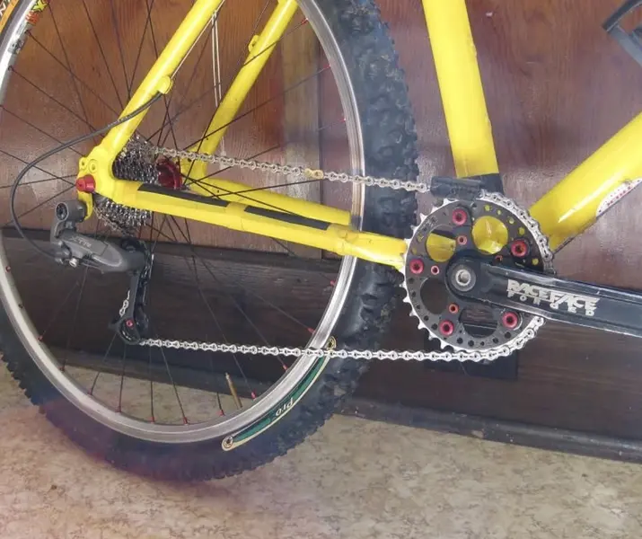

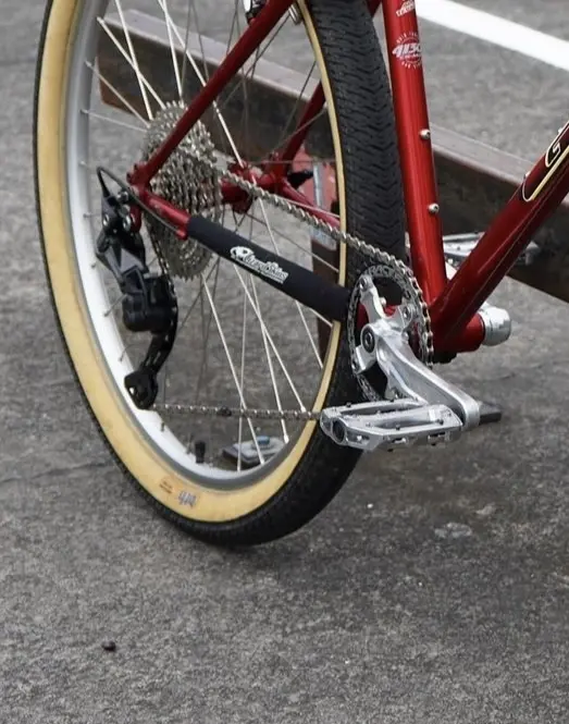

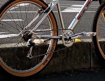

I’ve found a couple of pictures in the depths of my phone of the sort of thing I really like. I need to find some hubs first and get the wheels rebuilt. Any recommendations in the South of good wheel builders?
Apologies for stealing pictures! I’m not sure who owns any of the bikes, hopefully the owners don’t mind!
Would this sort of thing work? I’d have to get the writing stripped off but it looks retro-ish at least..?
Although I really like the idea of a modern setup now, that route doesn’t seem to be doable to a reasonable standard cheaply though!
