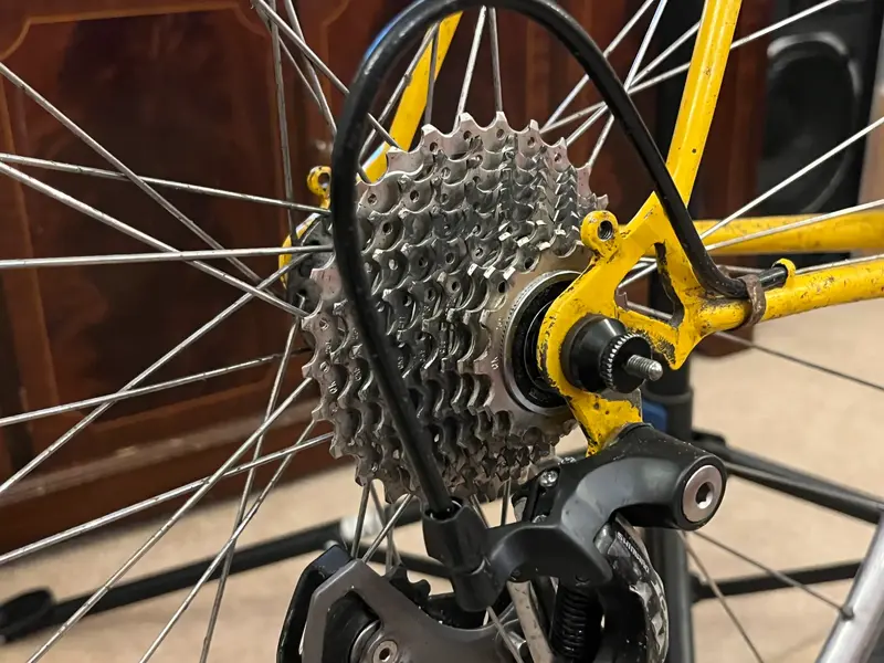

I was pleasantly surprised at the acceleration and the gears shifted smoothly with no residual clickety clicking. Changes are silent with very little re-adjustment required. I can only put this down to the fact that this is a Hyperglide cassette, narrow 10-speed chain and a hardly-used 105 derailleur. It's very different to friction shifting on an old 6-speed with a basic 3/32" chain and no ramps on the cassette.
I normally do this route on a 48x18 fixed gear which is around 72gi in old money. The gearing on the Hobbs allows me a couple of clicks either side. With the 46T up front, 72gi is around the 17 tooth cog at the back which is bang smack in the middle of the 12-25 range. As I came up the steep climb out of Weybridge up to the cricket ground, I reached down and shifted up to the 25, which made for a pretty effortless climb. I may still switch the gears around so it's got the 28 tooth I took off. It's unlikely I'll make much use of the 12 tooth to be honest.

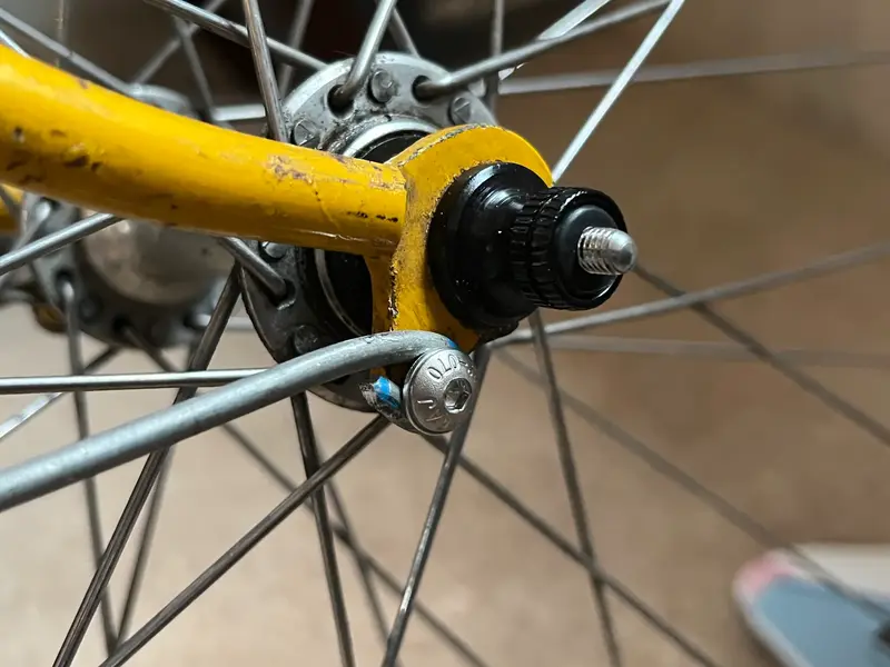

I also did a quick lunchtime mod to the mudguard eyes. They were plain 4mm-ish holes so I decided to run an M5 tap through them. Now I won’t need to use nuts on the back:

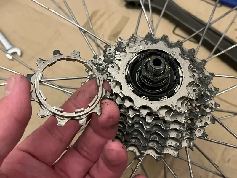

2. I will be putting the 28T into the cassette and taking out the 12T.

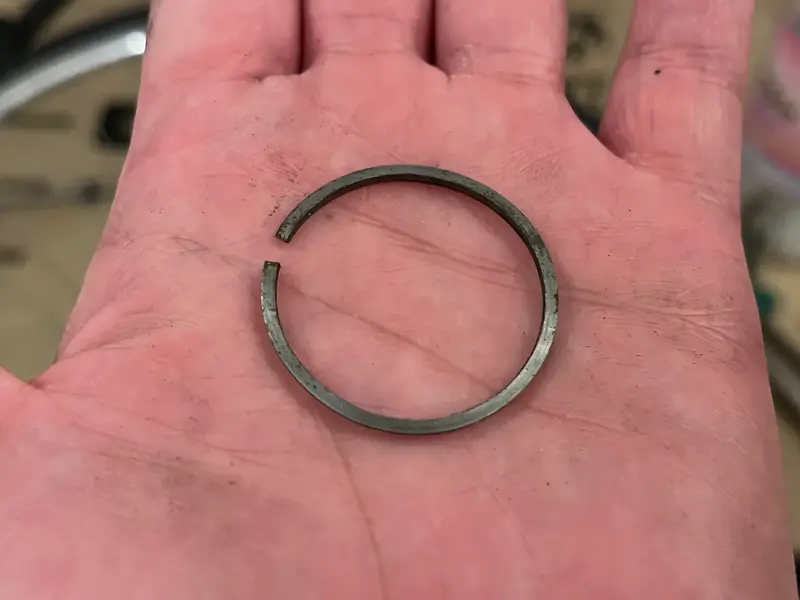

I swapped the cassette cogs round from 12-25 to 13-28. There’s a little mod you have to do if you want to do this. If you look in my pics you’ll see that the second smallest cog is grooved. That’s because the smallest cog locks into it and acts like a lock cog against the lock ring. You need to put something in that groove or the lock ring won’t tighten the cassette down. I’ve made up a ring of 1.6mm square wire for that job. Then it’s just a matter of re-assembling like usual.

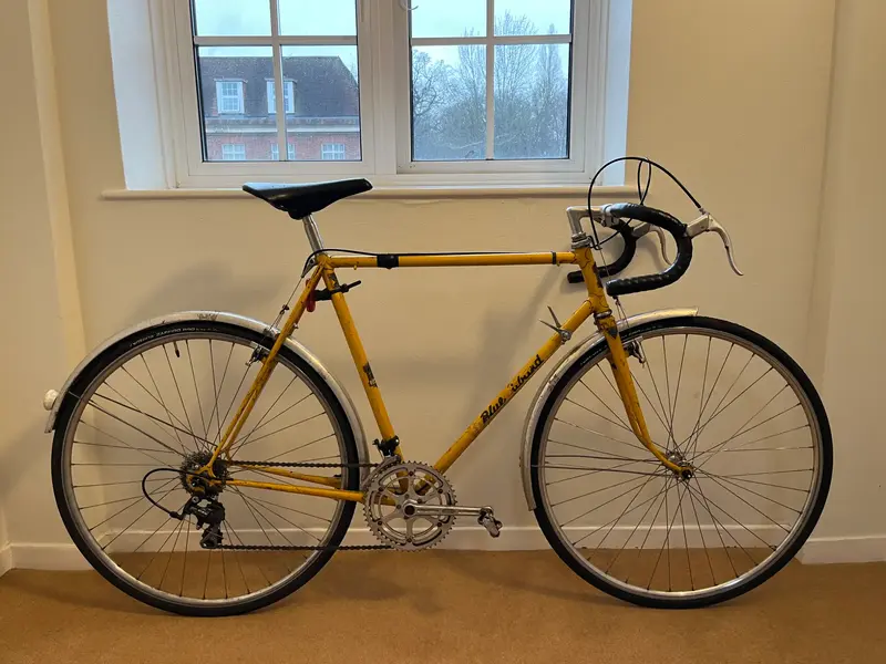

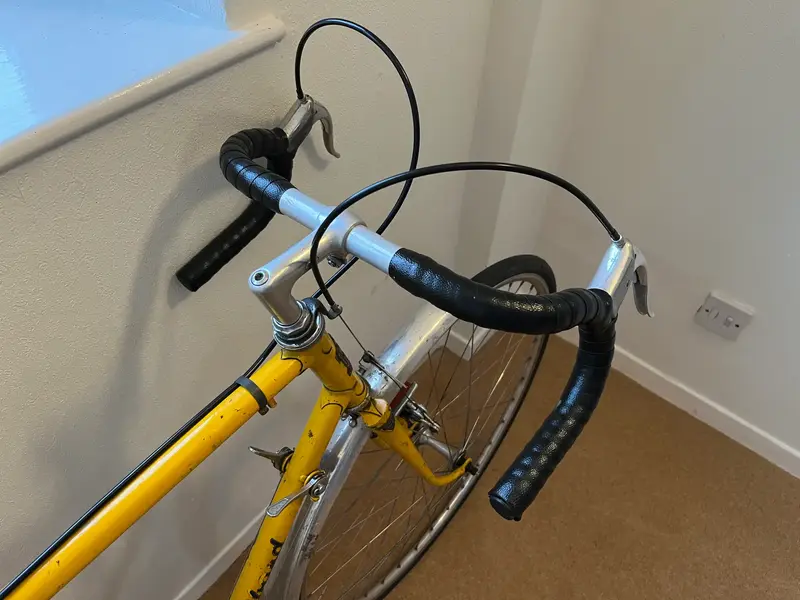

Wider bars and mudguards are on!
I’ll get some better pics later. The bars I had on originally were some narrow GB bars I’d had knocking about for years. They were comfy enough on the drops, with a bit of back sweep, but way too narrow on the tops. I was looking for some 80s or early 90s drops in plain aluminium, which tend to be wider across the top and a lot squarer at the top bend. These kind-of looked like that in the listing and were a nice dull-looking earlier alloy with an early-style bulge at the clamp area. They are actually an almost identical bend to the GB bars but a few cm wider. Same back sweep on the drops, so they should be comfy to ride.

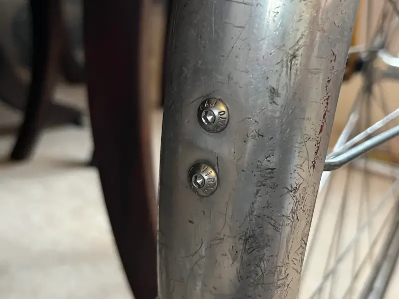

For the mudguards I had to cut the stays down and re-form the loops on the ends because they’d come off another frame. This was challenging because the stays are 3.5mm steel rod! Two came out well and two just ok like this one:

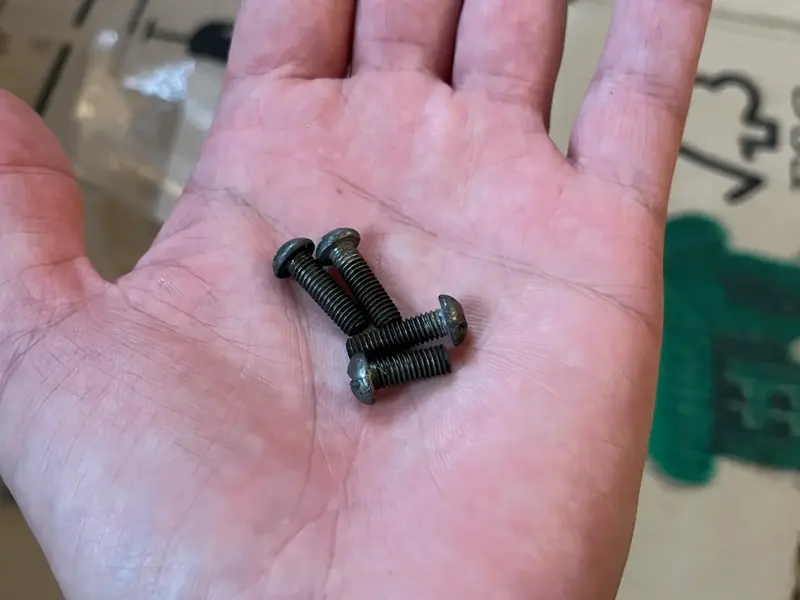

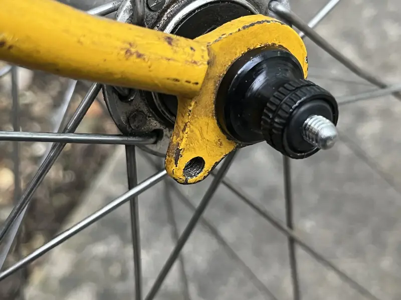

I don’t think I’ve mentioned that I’m allergic to old, mashed up slotted screws. I took the opportunity to get rid of the ones in the guard mounts and replaced them with stainless button heads. The originals seemed to be about 4.7mm with the same thread pitch as M5, whatever they would have been? So I just chased the threads out to M5:
Overall I’m fairly happy with the fit. I think I might space the back of the front guard back a bit to match the fit of the rear guard.
