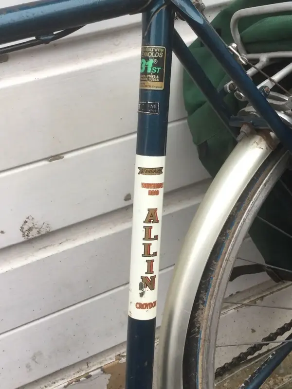

having done some reasearch myself I believe when peter cobb retired, frames were still made at the shop but by ray moore, maybe he would of tried to copy peter cobbs wrap over stays but still badged them as Allin's?
chris
Could well be correct. Whoever made the frames - even if they were bought in - they still would have been branded 'Allin'. The 'Standard' model on Ebay does not have components anything near as high quality as yours. Assuming that the parts on your machine are original (and it would be surprising if they were not), you must have a 'Special' Model.
Lloyds have the correct decals in stock along with the appropriate Reynolds decal should you wish to replace it
The OPs bicycle is not a Special - the bicycle on Ebay does not have the full decal that would show Standard.
Jon.
N.B decals do not always a bicycle make.
i have seen this bicycle, and the standard in the swag has been cut from a completely different decal - I know my Allins and the various models and the correct decals that are used on the various models.
The ebay Allin looks like a post Peter Cobb Allin to me, there are certain signature features that are missing.
Jon.
I see your point. I misunderstood your previous post.
Presumably Allin continued selling these machinesm (Stan Butler models) after Peter Cobb died - hence the relatively poor quality of the frames ? Did they make them - or were they bought in ?
