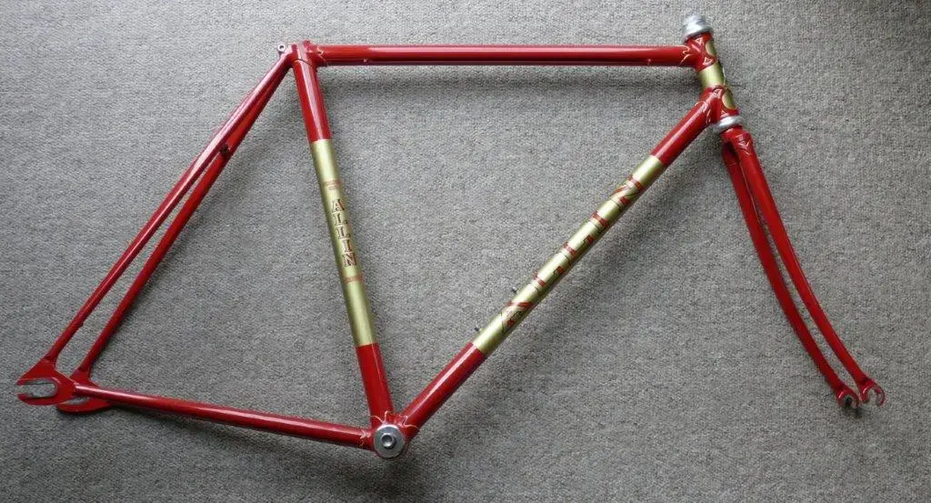

Hi I have an Allin,Frame No 2528,its a Special I had built,I think around 1984. I had it built as a fast tourer. 531c and 74 degree angles 40" wheelbase. A real work of Art,I put many miles on it,Touring North Wales and the West Country,allways starting from My Croydon base. Over the years,the only thing I have changed is the Saddle,its that good. Dispite its milage it is still in very good condition,though I admit that these days I find the handling,a bit sharp! Still love it to bits. Late 70s early 80s I was a "Hangaround" at Allins,never belonged to a Club.
Would love to see pictures of it. I have a track frame number 2514 which I had previously dated to about 1985. It has some quite unusual features and is a great pleasure to ride.
(see picture) I was in contact with someone who worked at Allins at the time this was made. I wondered whether it had been built by Cliff Shrubb but the opinion is that it was one of Ray Moores. I also had seen recently a frame branded 'Whitehorse' which had me baffled. I learned that, again in the 80's, Allins bought in some frames and branded them Whitehorse rather than Allin which was only used on frames that they made, or had made for them specifically.
