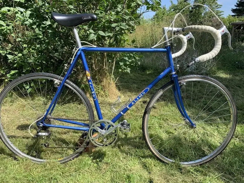

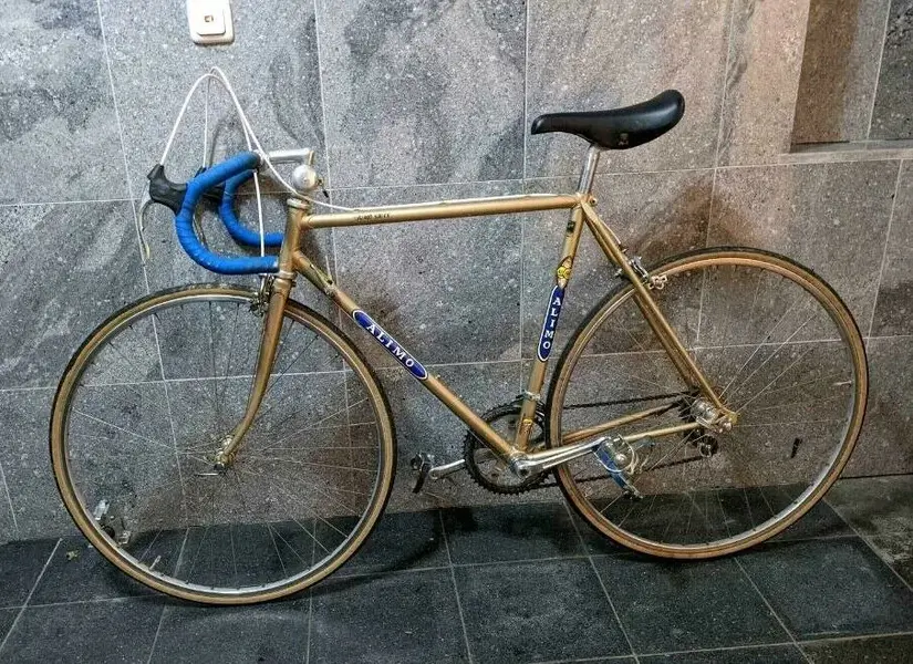

I am new on this forum and don't know how to pm you. I'd like to send this file to a decal producer and ask him to make me a decalset. My first 'serious' road bike was an Alimo 600EX/AE (this was also on the top tube). I was lucky to have a dura ace crankset on my bike which gave me a real pro feeling.
I found a frameset that resembles my Alimo, so a new project has started, building my old bike again.

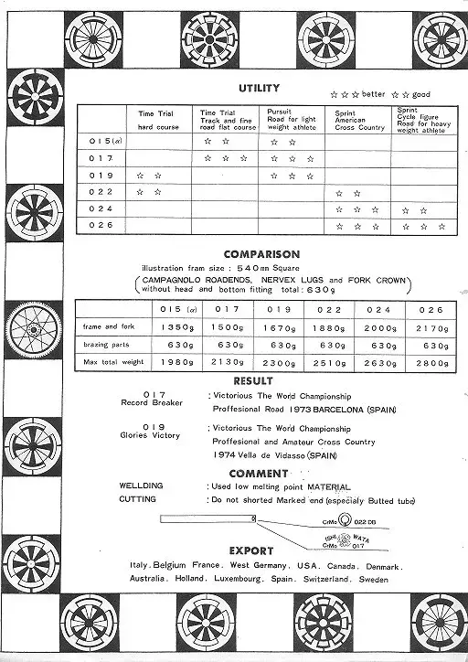

The Ishiwata 019 "Glories Victory" tube set is in the same weight range as 531 Professional and 531 SL!
Typical frame + fork weights with Campag lugs and Ishiwata tubesets:
I'm really impressed with their 015 tubeset, that was really light, I haven't seen many frames using it.

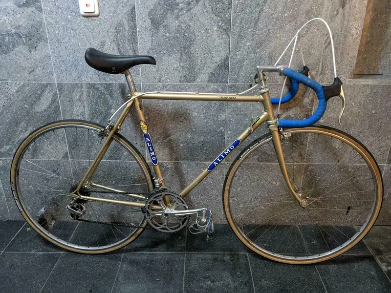

My brother informed me that he remembers that our bike had an "ALIMO NUOVO" sticker on the top tube. It sounds like they were all parts bin builds. The above pic confirms that this label wasn't just for the Japanese framed versions.
I also posted some pics of a red framed Alimo with stickers that say "ALIMO 600 AE"
