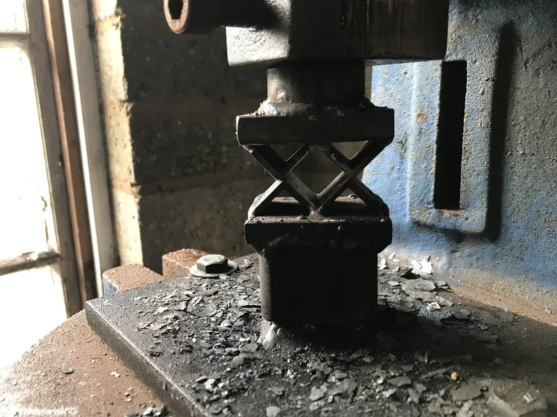

yep. Spent an hour or so today making some dies for the flypress, which should help... Some of Shimanos finest chain is currently hanging up to dry after a rather vigorous cleaning. Tomorrow may see my first attempt at canister damascus!

Can you weld? I've spent more time than I'd like to admit making dies for it, and lots of welding was involved... they're useless without the dies.

Dies made; The plates are 10mm steel.

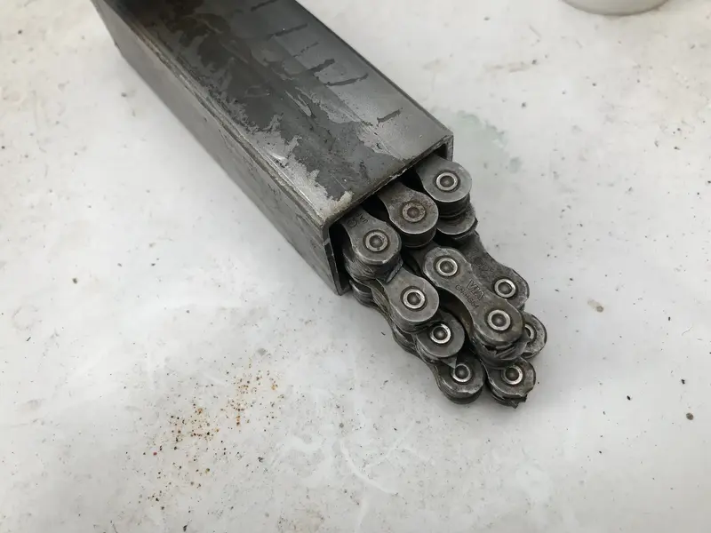

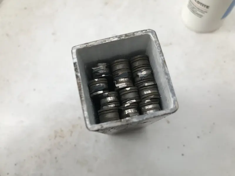

Made 2 canisters - 30mm box with 6mm stainless end plates;
And I've finally managed to make this thread vaguely bike related!!
1000 ball bearings & some old shimano chain!
