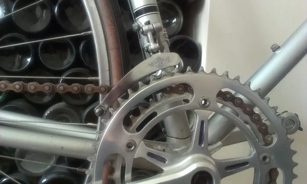

Nearly there, cabled up and bars taped with 25mm cotton ribbon off eBay, it's thicker than the cycle specific stuff and easy to handle when wrapped wet. Cleaned up the chain that came with the bike and found a sedis oro hiding underneath the grime. Just need to order hoods and straps, and planning to polish and perhaps drill the brake levers. The wheels I've stolen from my SBDU with the addition of a 126mm axle and curved skewers from the wheels I picked up on eBay for £12.50!(gp4s on record hubs). Had a little ride round the block, feels a nice fit, looking forward to getting a few miles in. :)

That sure us a fine looking bike, cracking position of the front mech, lots of people have them half an inch above the ring ! I see the second pic seems to have the brake cable around the right way :)

Shaun, I took your advice on front mech position and mine shifts up and down with ease, which is more than can be said for the modern bike I was messing with yesterday. :facepalm:
Went tight as possible on the front mech I hear that was the done thing ;-). The bike came cabled that way and I thought I'd like to try something different and they do look better.
