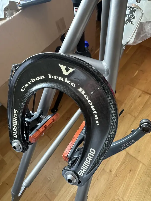

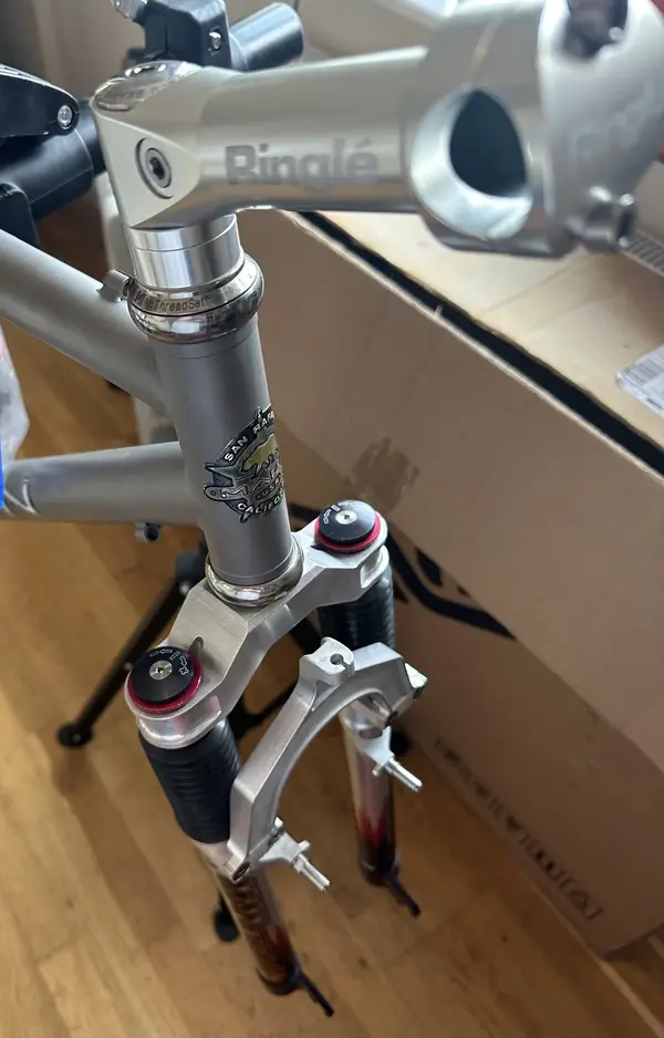

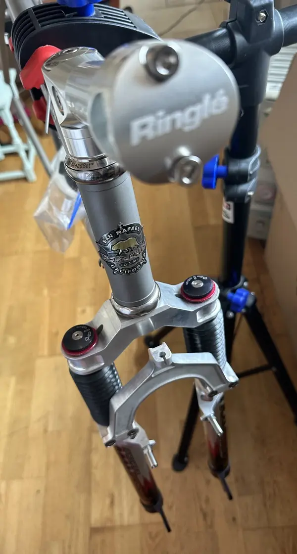

The M950 brakes are mightily close to the front fork brace. No idea how you would get the front wheel on and off without taking the front brake off - anyone else found this ?
Guess that’s the problem of fitting v brakes to a fork designed for cantis.

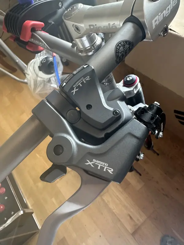

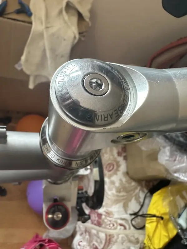

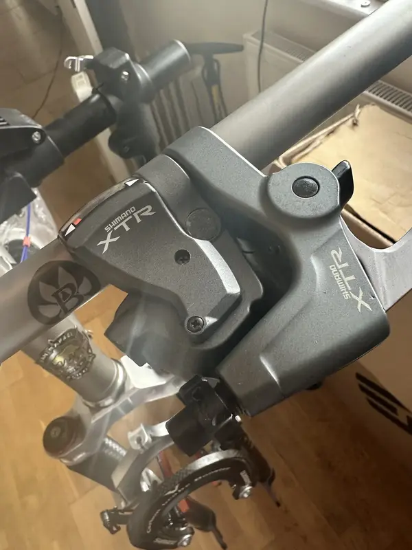

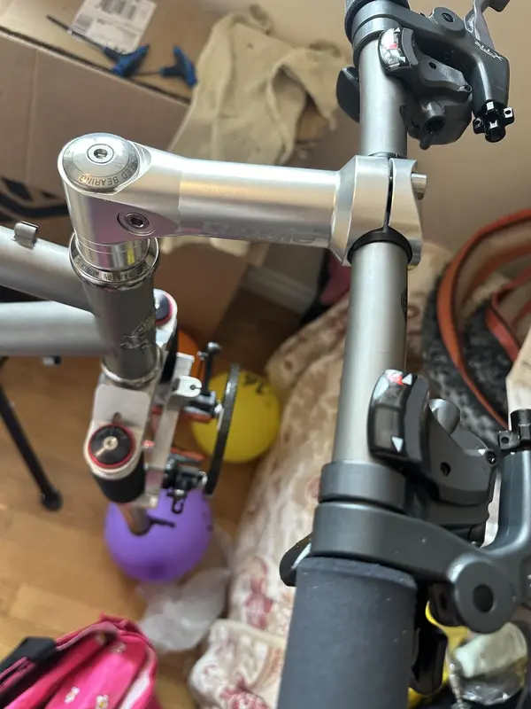

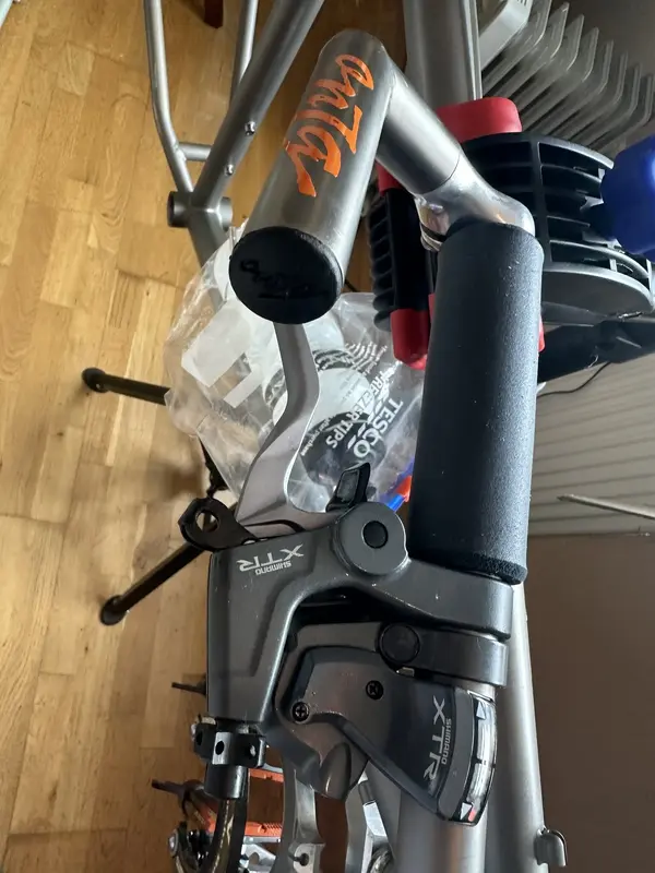

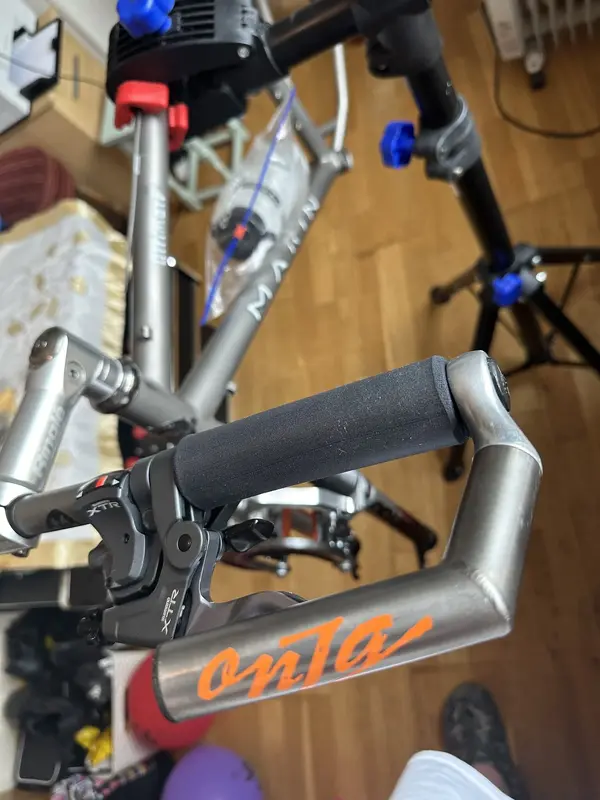

Handlebar, levers, shifters, grips and bar ends fitted.

Brakes and brake boosters.
Lovely build, but the brake boosters spoil it in my view. They're not exactly delicate looking!
I removed my M739 brakes from my manitou4 as they had the same issue. One arm even got wedged behind and ended up slightly stuck. I ended up putting M737 cantis on.
Yeah I know what you mean. This is going to be a bit more of a showy bike and I’ve had the brake boosters squirrelled away for a while.
They are expensive and hard to find.
I’ll see how it looks when it’s all together.
