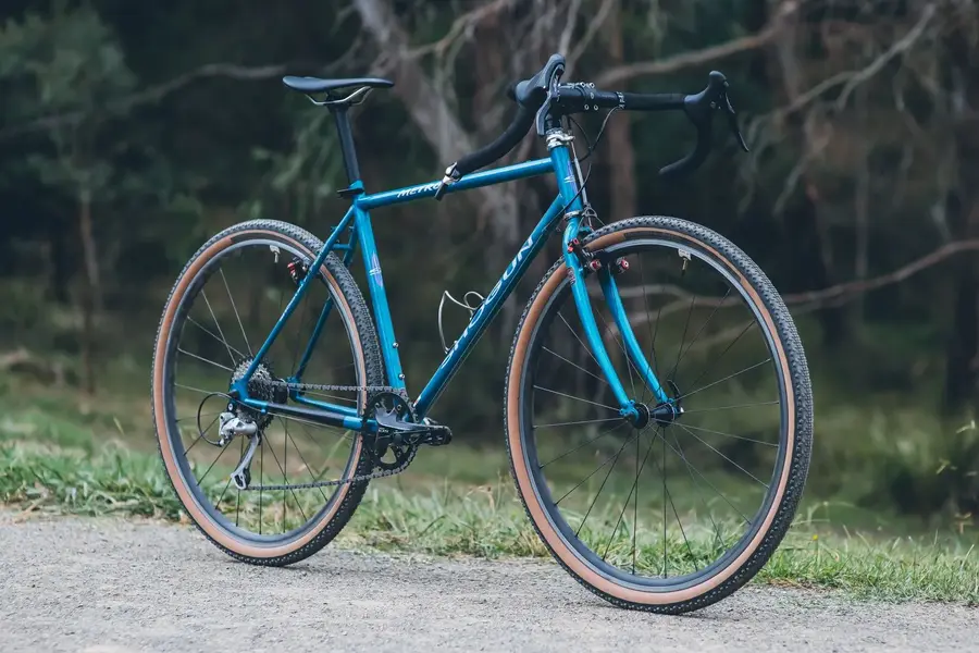

Shogun 'Dad Bike' - gRaVeL cOnVeRsIoN
These Templite frames are a thing of beauty IMO good on you for saving it, should ride lovely.
Thanks! It rides very nicely indeed! Incredibly glad I stopped to take a closer look at the pile of hard rubbish on the side of the road!
My favourte feature is the wee chain peg on the seat stay; a small and long forgotten courtesy / detail on modern bikes.
What a transformation!
If anyone needs me I'll be on eBay looking for sorry looking 700c hybrids
Ha! Get on it! They're criminally underrated.
you hit the nail with this build - wished I would have kept my Trek Multitrack 720 - it would be a nice base for a similar conversation.

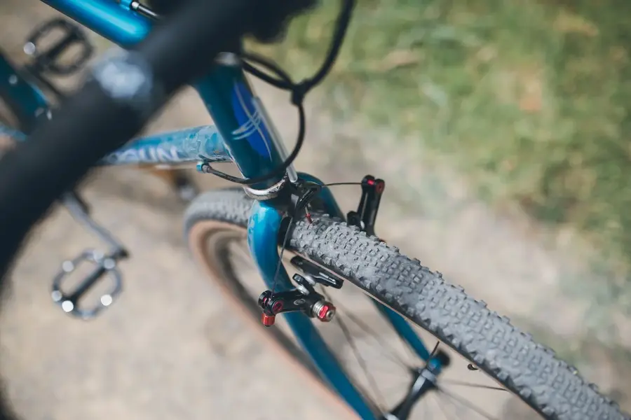

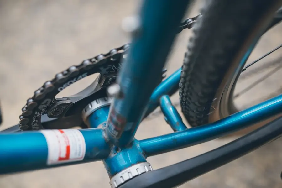

Little update: knobbies!
Tyres are Innova Pro Stampede in 700x40c, sourced from PRC on recommendation from a fellow tinker-er.
A few notes:
  • For a budget tyre, first impressions are very positive. Despite being quite tightly wrapped for shipment, they mounted up just find without strange bulges.
  • On these rims, measure exactly 40mm across.
  • Weight isn't fantastic at about 560g per end, but that's about the same as (OEM) WTB Nanos in 40c.
  • Non-directional tread pattern.
I've taken a few snaps in the event someone looking to re-tyre a Shogun Metro needs an idea of clearance. I'd say 43c would be the absolute limit (and even then, it would depend on the tyre and the rim width). 40c seems appropriate for this bike and rides fast / comfortable enough.
