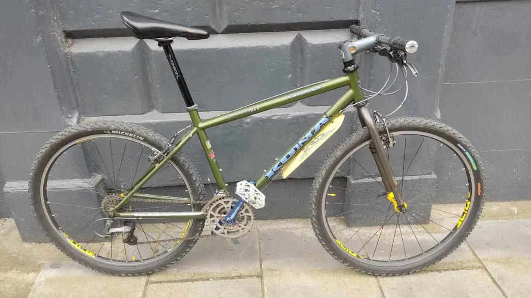

Definitely too much black going on here. Saddle is creaking. Still no sign of a single m960/70 brake to make a pair. Grips still ripped and need swapping out however the bar plugs were installed with a lot of swearing if memory serves.
Front mech still is not happy in situ and shifter not indexing. Considering again to remove the xtr entirely as I'm unconvinced of its compatibility.
Steerer is too long and I am reluctant to cut this down until I find an 18" frame to swap out. Also feeling a lot of drag from the back hub. Feels like the brakes are on! Service time.
A few observations that I hope are helpful.
- Raise the saddle nose and / or lower the seat-post a touch. A lot of your weight is going on the front end in that set-up, and it doesn't necessarily need to do so. It may be a contributor to the creaking but be aware, it may be the saddle anyway. The flex/quality can be a cause.
- Sub-point, if the steerer is too long, then you'll end up with a bigger saddle to bar ratio, even more bum in the air, face in the ground position.
- The front mech looks too low/too close to the big ring. This can cause shifting issues.
- The rear mech/chain length might be too long. In that current gearing, I'd expect the spring to be more stretched if that makes sense: more tension.
- Drag on the rear hub sounds ominous. I run the same on the Team Explosif and they are butter smooth. Definitely need a service but check for the obvious; alignment in the rear triangle, brake set-up, etc.
