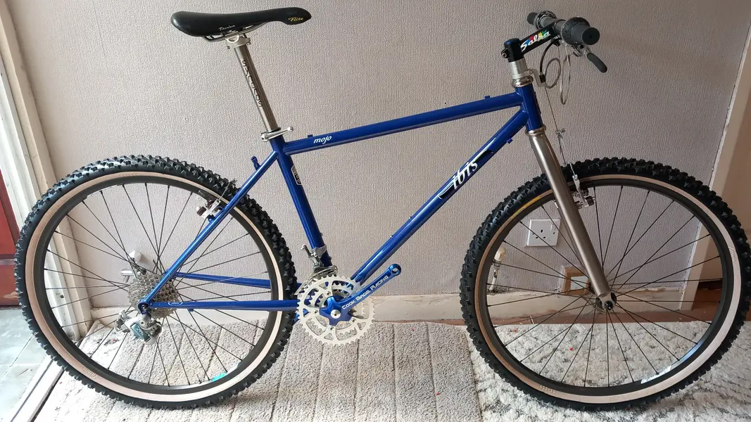

Bit of a mock up to see how things look
waiting for the Ibis Ti stem to arrive ,still in the US so the Salsa is going and will see what Silver Chris King Wheels look like they should be here next week from the builder
The fork is a Burls Ti fork 420 A/C ,for now to help things along it might be a little short on the Axel to Crown length but lets see ,but as i said only a mock up things are likely to change a little

Check the bb height against Ibis specs. It's all about that number. 420 is ok. I would look for 430 but 420 could be fine.
Stem is too short. They used 120/135/150 mm. A 71 degr. head angle w that short stem will make the front too nervous. A longer stem will calm things down.
