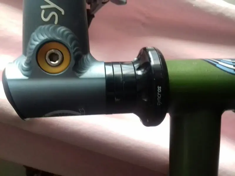

Headset, is it just getting a cup out (picture?)
Do you have the splayed pipe to hammer it with?
Issue is that the headset has a wedge built in to the top, the cups aren't alingned. It's stuck fast to the steerer meaning we can't knock it down to take up the slack.
Only thing I can think of is to rotate the cups, aligned them properly.
Hopefully that frees it up enough to be knocked down...
