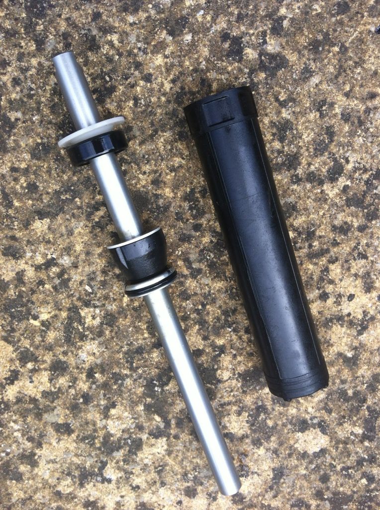

Nope, there's definitely no adjuster rod in it, it's been removed at some point.
I'm thinking I can just bolt the rod into the outer leg in a conventional manner and have them as non-adjustable. Looking up in the cartridge damper rod, I can't even begin to see (or workout) what it might do or how it might work..
Might just go without it..

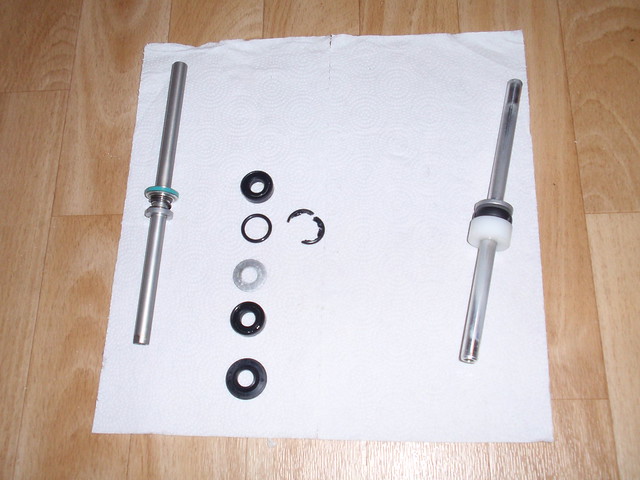

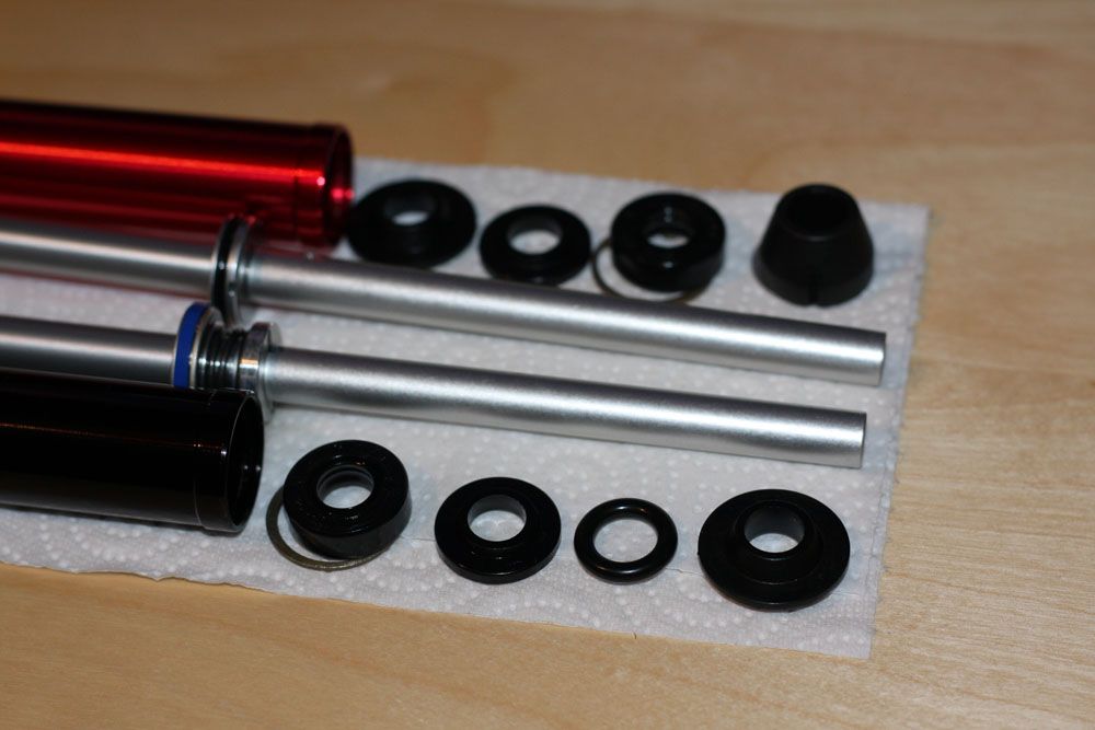

The damper doesn't look right, I would say someone's half converted it to a dummy leg but for some reason left the casing there and seals.
Reason I say is the large rubber triangley bit bit it the top out bumper and should not be in the cart.
Given you say there is no adjuster in there then it would make sense it was not used as the oil would not stay in it.
also all the bits it moves are not there (the mylar, rubber , spring, metal rods)
In fact the round disc in the middle reminds me of the inside (from memory, will search later) of a DownHill compression cartridge
Yep, mine's almost the same as the one on the left of the top pic, but like you say, there's loads of bits missing. The rod has the chamfered ends (on the last 5-10mm), tho, whereas the dummy leg rod is just rounded.
The big metal spacer is definitely not there, and neither is the spring... :cry:
