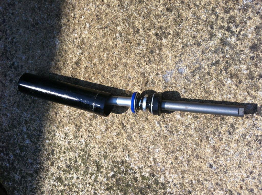

I was looking at this picture of yours, notice the o-ring around the metal disc, which looks like the compression rod one (red cart) in my second picture)
http://i662.photobucket.com/albums/uu35 ... 366583.jpg
If you run without the damper, which you can do, you of course have no forced damping and they do work (ask chirsv40) but once I'd rebuild and fixed his damper, going over a rutty tree route downhill section near us was so much nicer and controllable.
Yes, I noticed the O'ring, should it be a blue one like yours?
It's not a super tight fit, but it does 'whistle' when you stroke the damper, and once it's all the way in, it's totally air tight (I blew through it and nearly passed-out at the pressure I was blowing at, only for no air to escape). I did try an ever-so-slightly thicker Oring on it, but it was impossible to get in the cartridge.
yes it should be blue or at least a plastic glide ring thing.
What happens is the allen screw you don't have pushes up the smaller metal plate, this compresses the spring a bit more and places more force against the mylar (assumed mylar) dis, meaning more force is needed to start the oil surge on rebound damping so slowing it all down. Not the most sophisticated setup. Similar to a MAG21's principle, but oddly not quite as sophisticated.

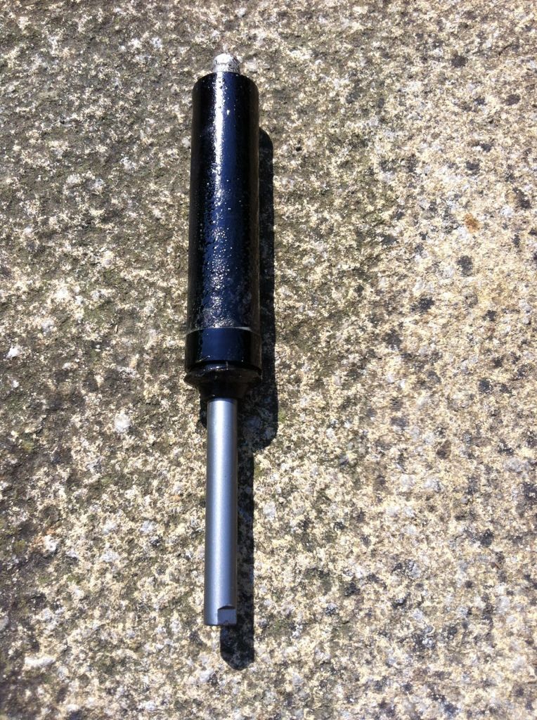

So today I opened up my spare set.....
And this is what I found:

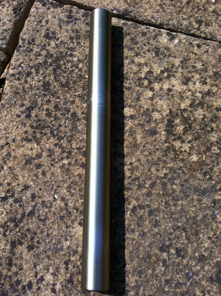

An almost perfect stanchion, with almost zero wear.. 8)
A cartridge (metal, this time, not plastic like the previous one.. :?
And inside said cartridge....
All the bits I could possibly need.
Today is a good day... :lol: :lol:
