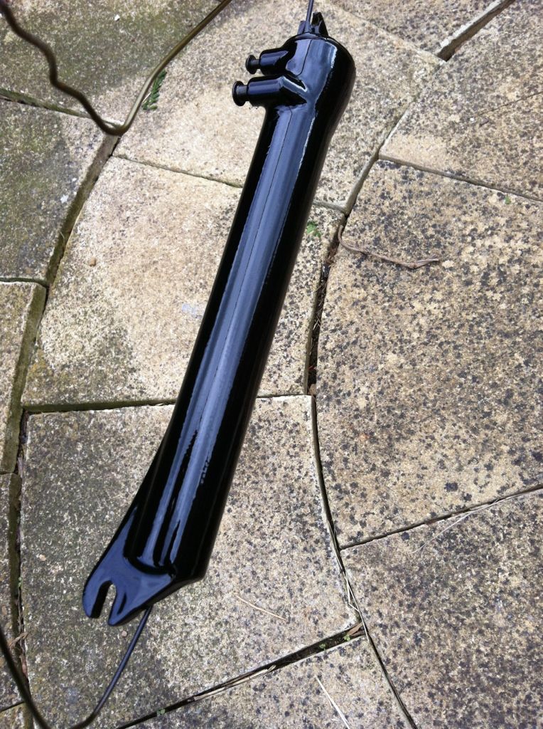

So this evening I've gently sanded the inner stanchion outer surfaces smooth (only where the wear/damage was) and they've polished up a treat.
So tomorrow if the sun's out and shiny-happy, I'll be spraying them up gunmetal, or black depending on how I feel when I wake up.. :lol:
Then it's just a case of waiting for the springs from Kronos and I'll be putting them back together.. 8) 8)
So today the black hammerite (smooth) came out whilst the sun was shining...
Much fresher..
Did an old set of Judy T2`s in black hammer finish a few months back for the girlfriends bike, they came out really nice, i`m pretty sure the hammer finish has some kind of silver effect in it as well.
Did an old pair of Rockshox pilots in black smooth Hammerite for a mate a few months back.
Done a pair of Rockshox Psylos for my FSR in smooth white, and did a pair of Marzocchi Z1 Dropoffs in black hammer for my FSR just a couple of weeks ago.
Never had any trouble with tightening the QR`s on mine!
Yeah I'm please with the finish and it should be quite simple to maintain..
