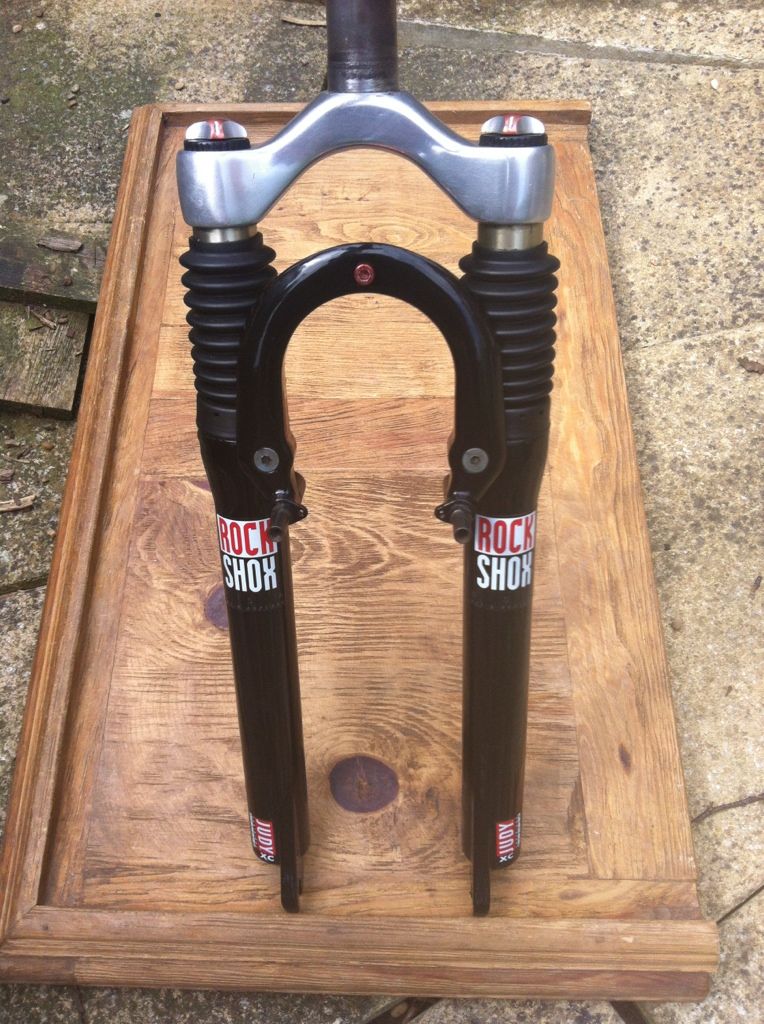

Nex job was to fit the inners into the outers, so I constructed a contraption consisting of a toothbrush taped to a long allen key, so I could get grease right down to the bottom bushing.
Once both bushes had a thorough coating, I slid the inner leg in to place, and conected it at the bottom with the allen bolt.
I repeated this for the other side.
Next I cleaned and greased the inner pafes of the dust seals and slid them over the inners and into place in the top of the outers. I thin slid the ruber boot over the inner leg.
I repeated this for the other leg.
Then I took the crown, and using a flat blade screwdriver, I eased oper the hole for the leg to slot into, and slid it in until the top was flush with the top of the crown, Then I took two bolts and bolted them into the side of the crown, loosely, just to stop eveything falling out..
Then I took the brace (V-Brake in this case) and bolted it into position.
Then I took two brake bosses and slid them into place..

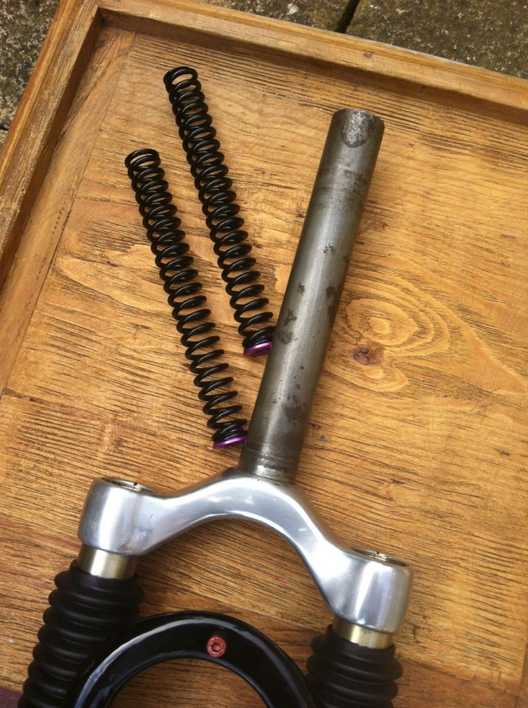

Now that eveything was in place, I could fit the springs.
Firstly I greased the bottom mounts (purple ano) on the springs, and then wiped a coating of grease all over the rest of the spring. Then it's just a simple case of plopping them down into the top hole.
Repeated this process for the other leg...
Once the springs were in, I ran a thin smear of grease all round the inside of the top caps, just to be sure. Then I screwed the top-caps all the way in, backed the adjusters all the way anti-clockwise until the marks both pointer forward (anal, I know :oops: :lol: ) and the screwed in the crown bolts real tight, to stop anything coming loose..

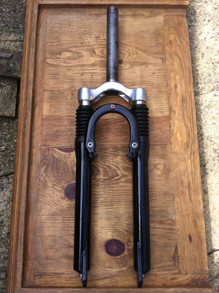

So a rebuild wouldn't be worth doing if it wasn't for the little touches, so last job of the day was to apply the decals (and very top quality they are too...
So all in all, the rebuild today took me about 2hrs, and that includes taking a load of phone calls, re-reading the instructions on this thread a million times, and a couple tea-breaks.
The cartridge literally took 10mins max, to rebuild.
I'm very happy with the end result. I'll probably put them on a bike tomorrow and go for a spin...
Thanks to everyone on this thread (and spacehopper) for helping me through it.. 8) 8)
