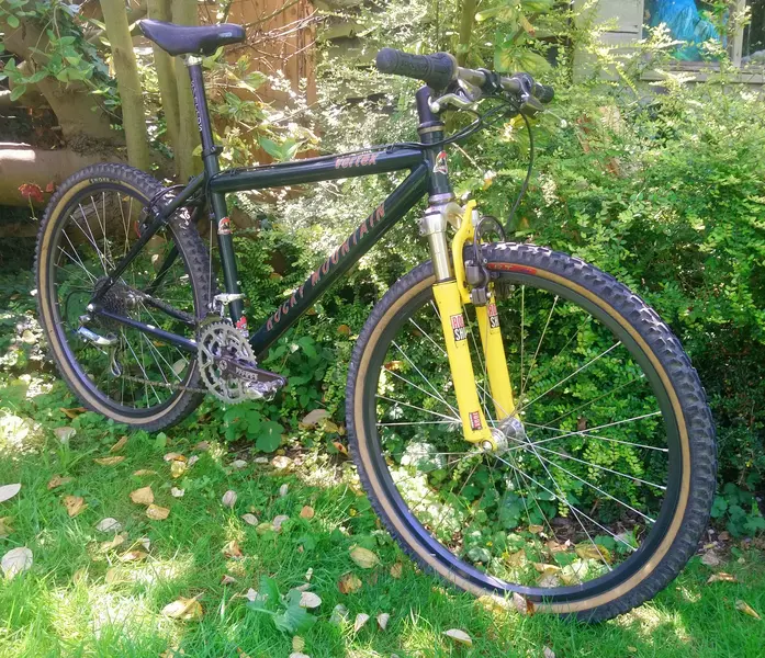

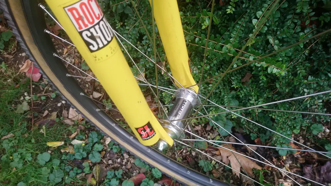

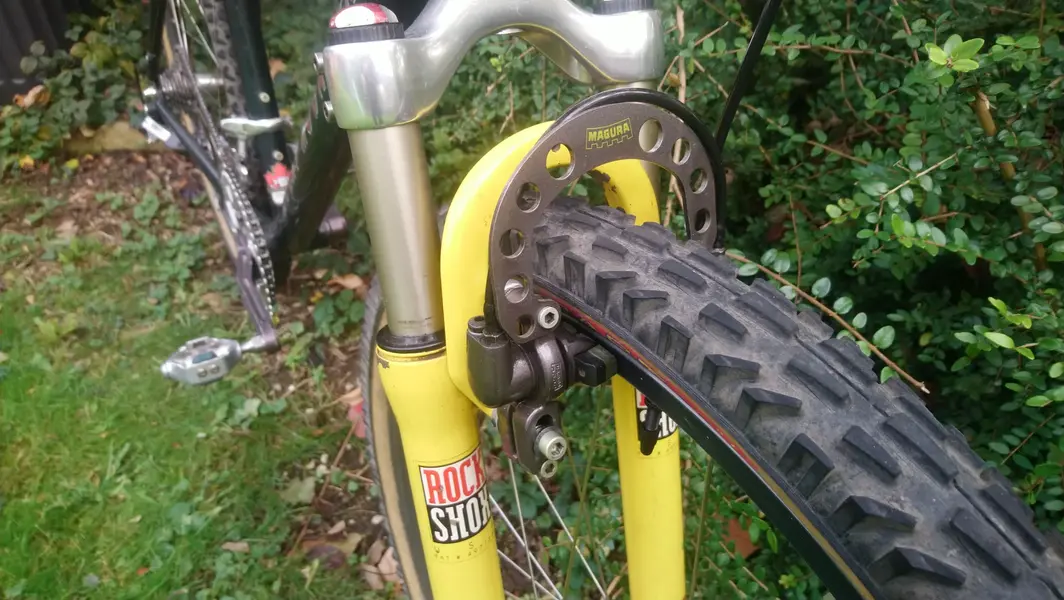

That's better. What did you do about the fork internals?
This fork is in excellent shape internally, apart from the all too common crumbly elastomers. Replaced them with some coils of unknown origin that I found lurking in the garage. Also fitted new seals and fresh oil in the damper. A shedload of Slikoleum grease and all should be good till the damper inevitably shits itself again! :)
Nice, I put Speed Springs in my '96 SL, worked out pretty good. Do you have the ti bolts on yours?
Yeah, springs are a nice upgrade, ride nicer, aren't affected by temperature and won't crumble. The only downside is the added weight, if that bothers you, they're not really 'SL' anymore. :)
Yep, they have the Ti bolt kit.

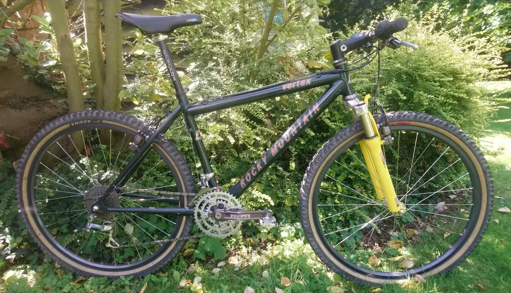

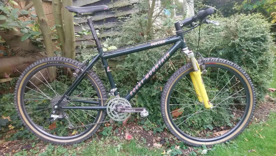

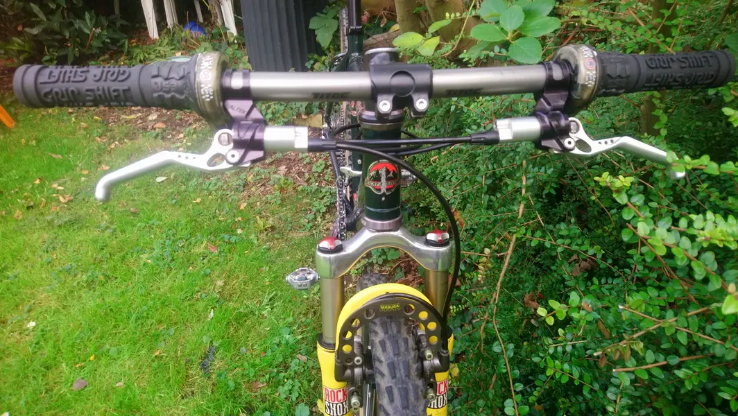

Finally got this one where I want it, for the moment at least. 👍 😁

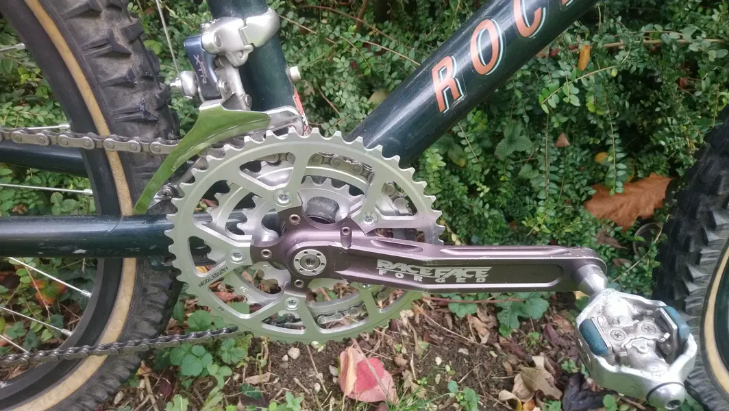

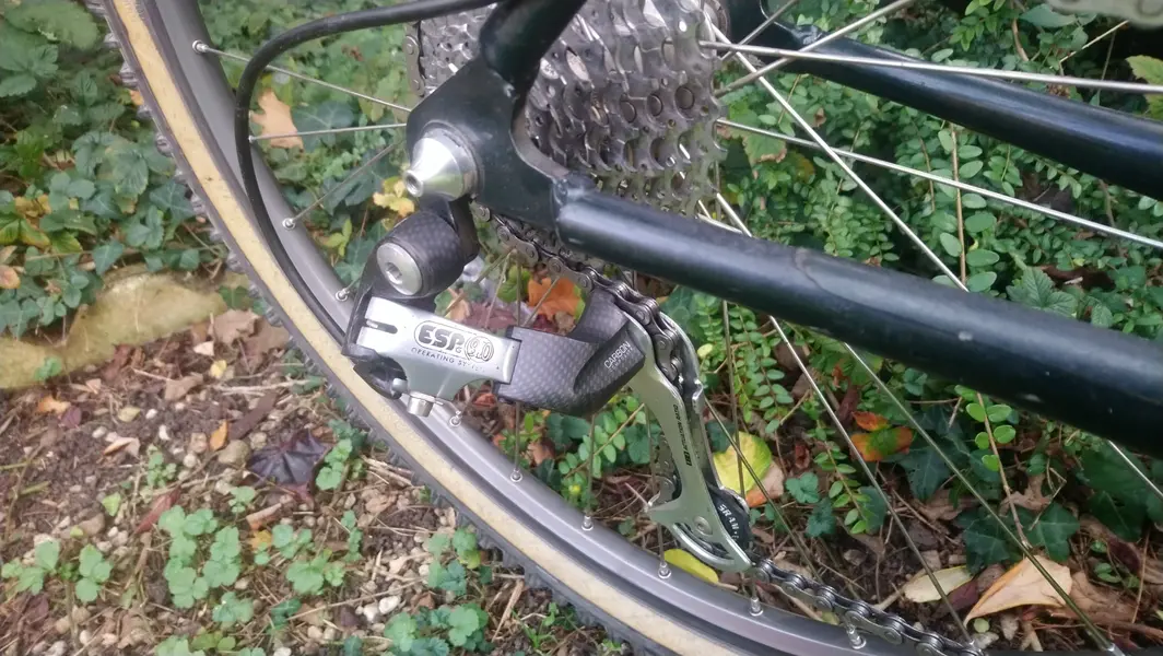

ESP 9.0 mech and shifters, Altek levers, got the inner ring spacers sorted, changed the fork to a 63mm travel 96 version which got rid of the canti stop.

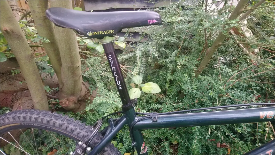

And finally a ti railed Bontrager saddle. 👍 😁 DSC_0124.webp DSC_0125.webp DSC_0126.webp DSC_0127.webp DSC_0128.webp DSC_0129.webp DSC_0130.webp
Love it mate
