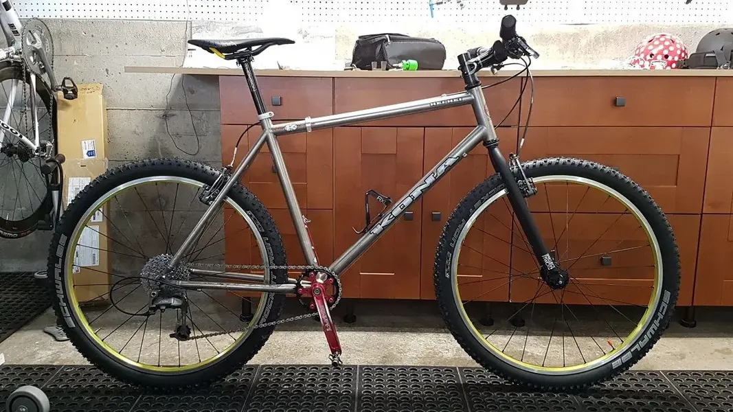

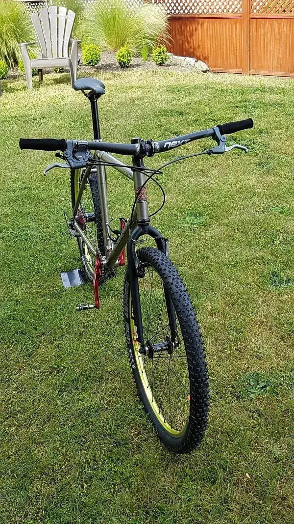

Hope you enjoy my recently completed pseudo-retro build! Admittedly, it is not period perfect, there are some mixed years, and some strange outliers (carbon bars?) but I like it! A good mix, in my view! For those WW amongst you: 20lbs on the nose, with cage and pedals!
1995 Kona Hei Hei, 20"
Project P2 410mm cta fork (to match original Marzocchi XC600 geometry as best I could)
CK Sotto Voce 1 1/8" HS
XTR M960 V-brakes
XTR M950 Levers
XTR M952 RD
XTR M952 shifter (R only)
Race Face Turbine crankset
Race Face BB
Wolftooth Components 32T narrow-wide chainring (minor drilling req'd for crankset bcd)
SRAM X9 cassette (mainly for the lovely red matching colour)
SRAM PC991 chain
Mavic Citron rims
Chris King hubs
Schwalbe Rocket Ron EVO TLR tires
Race Face Turbine (new) stem
Race Face Next SL CF riser bar
Ritchey WCS Ergo grips
Thomson Masterpiece 27.2 post
Fizik Tundra 00 saddle
Crank Brothers Egg Beater 2 pedals

Perfection right there.Those P2s really complement the build more than what I would've initially thought.Bet it climbs like a demon.
The P2s sure are nice. Track super well, and you're right--as built, this thing climbs like a billy goat.
Or more accurately, a billy goat if it were carrying an out-of-shape 40+ year old dude on its back (that's me, hahaha!)
