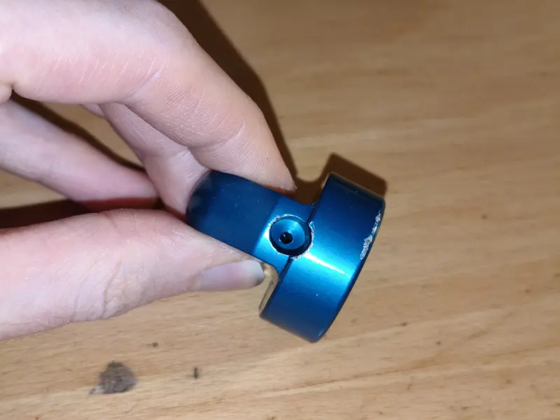

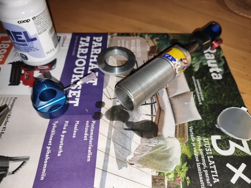

Starting off, bleeding the rubber bead-sealed IFP with a needle and opening the thing up, first hick-up was the wrong end of the damn thing unthreading
Gonna need to stick the IFP end cap on with some red threadlock, and try again with more heat.

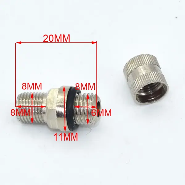

I don't fancy the rubber bead style IFP sealing on these Fox shocks, so I drilled the cap out and ordered a schrader valve for the thing. Guess I'm gonna tap some M8 thread on the end cap and seal it with JB-Weld.
