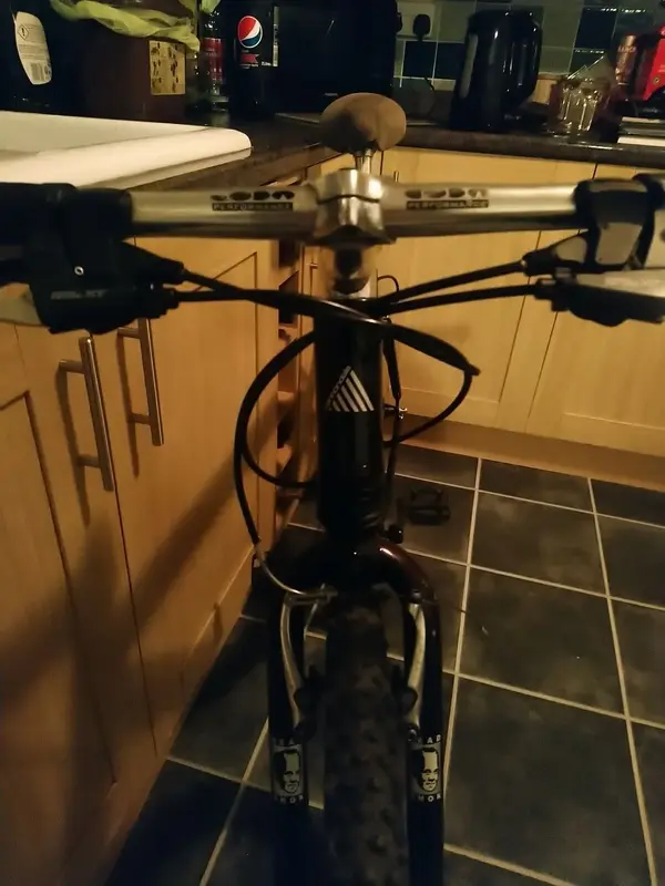

Picked this up a couple of days ago.
Always thought they were a good looking bike back it the day.....but out of my price range at the time.
Its been updated tastefully over the years by the looks of it with XT V's, rear mech and shifters.
I've chucked some old Porcs on as it was shod with some Schwalbe items made of lead.
And a temporary seatpost and seat as what was fitted was too small for the hole.....ain't it always the way!!!
Its too cosmetically challenged to warrant a full resto so i will give it a spruce up, well it is almost christmas, and use it as my pub/sunday morning coffee run bike.
I would like to source a non drive side crank arm for the Coda/Sugino compact M500 chainset....or maybe fit an M739 chainset in keeping with the other upgrades/modernisation.

Looks better in the sunshine.
Rear M750 brake is a bit of a mystery. With the caliper pins in the middle position there's not enough spring tension on the arms. The top position isn't really an option as then they are over tensioned.
Is it just a question of tweaking the springs to suit or is there some other mystical crap going on here??

I had this issue just put them on the middle hole and when you set in you can add tension by screwing in the little screw on the outside of the V's
I tried that earlier. Didn't seem to improve things.
Its like something isnt seating properly as the arms lock solid when i tighten the mounting screws up.
