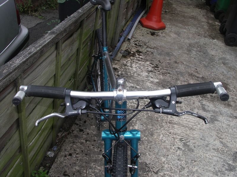

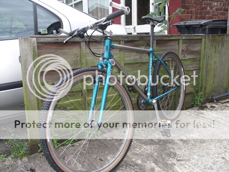

Right then, I've indexed the gears, sorted the brakes, tightened up the spokes and checked everything, and had a very quick spin. After an all too brief whizz ( to keep the tyres looking new until next Sunday) I can say that this is a LOVELY little bike. Really light on it's feet and responsive. I love it. I don't know how it will handle the rough stuff yet, and may do a further post after taking it off road, but for now, short of a chainstay protector ( looking for an NOS or close XT Sharkfin for it ) I am calling the bike done.
As you can see I went for the 91-92 look on this 94 machine simply because it was less work/expensive to do.
Here's the spec sheet:
Frame: Raleigh Dynatech Bonded/Brazed Titanium and Cromo Composite
Fork: Raleigh UGLI ( Uncle Gerald's Latest Invention ) Bonded Alloy Crown CrMo blades
Headset: Unbranded ( Original in excellent cond )
Stem: Marin Lite 130mm 195g
Handlebar: M-Wave Alloy 580mm 215g
Grips: Cassano Ergo Grip (original)
Barends: Unbranded light alloy
Brakes: Shimano STX
Brake Pads: Clarke's
Brake Cables: Shimano
Cantilever cable hangers: Shimano
Brake Levers: Shimano STX
Shifters: Shimano STX
Front Derailleur:Shimano STX
Rear Derailleur: Shimano Deore LX
Derailleur Cables:Shimano
Cassette: Shimano 7sp
Chain: KMC
Cranks: Shimano STX
Crank Bolts: Shimano
Chainrings: Shimano
Chainring bolts:
Bottom Bracket:Shimano UN52
Pedals: No Name Alloy with Toe Clips
Hub Skewers: Shimano and, er, whatever that front one is.
Rims: Bontrager BCX3
Hubs: Shimano STX
Nipples: Brass
Spokes: SS 15g
Tyres: Charge Splashback
Tubes: Continental
Saddle: Madison Flux
Seatpost: Tioga 27.2mm
Seatpost Binder:5mm Bolt No QR
Weight: 25lb
And here are the last pics :-)
http://i10.photobucket.com/albums/a145/ ... avgzgx.jpg
As I have said before I'll probably eventually put a shorter stem and even some slightly wider risers on for comfy all day pootling, but you can tell when you get on her that she's a racer :-)
