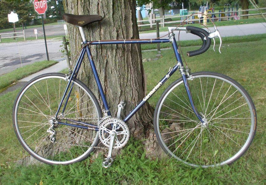

Well, I took it all apart and put it back together and took another photo of it, and it looks pretty much the same. The "Italia" seat is off an old Motobecane I used to have which was about the same year as this bike, and I put Velox black cotton bar tape on the bike. Also got rid of the self-extracting Shimano crank bolts and put regular crank bolts in and covered them with a pair of Sugino covers I had in my toolbox. Tires are a used pair of Conti gatorskins. I hung the bike on a scale with some old alloy road pedals installed and it was 22 pounds dead even. I think I would like to get a shorter stem for it at some point in the future if I am going to ride it regularly, as the reach to the seat is further than I am used to.

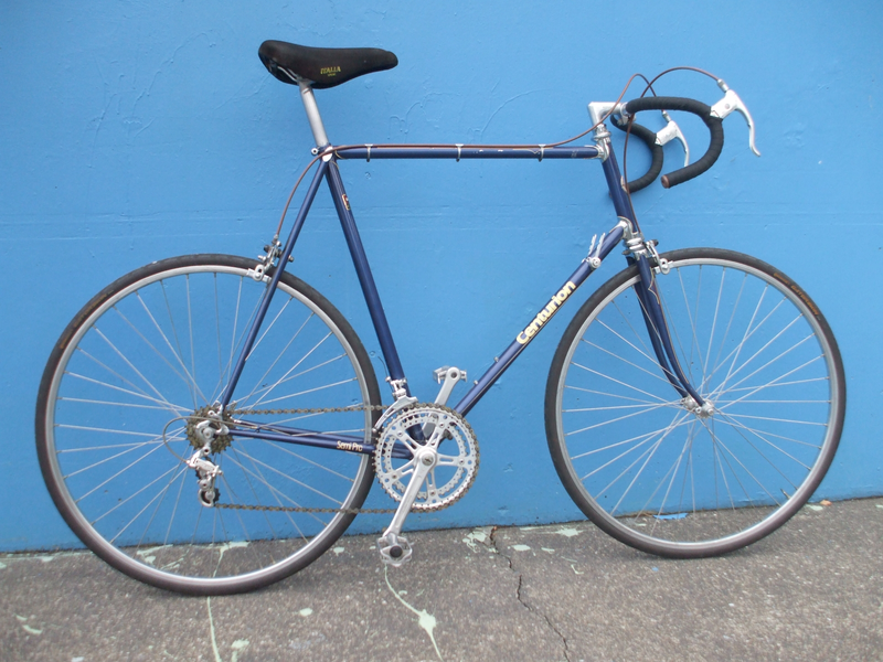

The after-after photo. I swapped in a different seatpost and stem to make the bike more comfortable for me, so I would not be stretched out on it like I was on the rack in the Spanish Inquisition.
