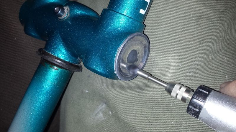

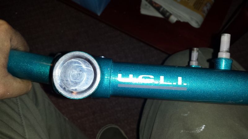

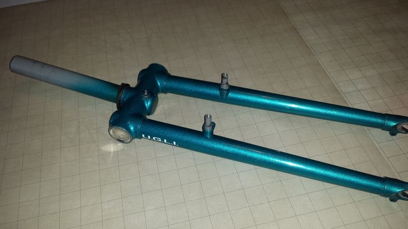

Evening all. I have been polishing. I decided to start easy with the fork and as Rampage so rightly predicted the laquer from the remaining laquered end cap came off in one neat piece, the oxidisation having worked it's way under the clear coat. ( see the pics in the first post. )
Polishing alloy is new to me apart from shining up the odd chainset, so it was clear to me that the end caps on the fork would need a bit more than my usual fiddling around with a rag and Autosol in front of an episode of Buffy.
So, I gave it a good clean and had a think, stuck a brush in my trusty fake Dremel and put some Autosol on the brush:
And gave it a bit of a seeing to :
Which gave me this:
Then went over the whole thing with polish and then waxed it, which gave me this:

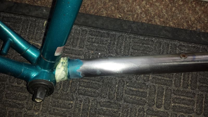

I have been removing the coating from the main tube: It's going to take a while.
The plan is to start with 120 grit then progressing down to 2000 grit wet and dry paper. I tried some of Halford's emery cloth today and it was hopeless: it pretty much self destructed which was a bit of a surprise. I am still vacillating between re-spraying the colour fade and just leaving it like a pre 92 model. I suspect it will be decided by whether I can get a good colour match for a reasonable price. I think it will look pretty good either way :-)

I must suggest chemical paint remover if I haven't done it before. Trust me it will save you loads of time!
Re: 1994 Dynatech Diablo STX.
Cheers Si :-)
Dare: I had thought of that, but I am worried about it getting on the lugs and attacking the bonds. Probably being a bit over careful, but I actually quite like sanding. I find it soothing, especially when you get to the stage of the tubing looking better than it did when I started. :-)

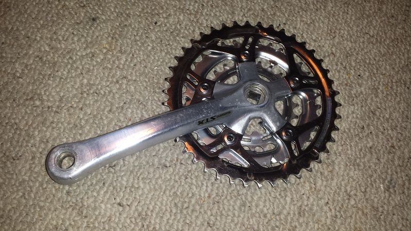

I was a bit short of time today to I just finished off the chainset: I think it looks quite nice, but there's some oxidisation I just cannot get rid of, even after a few hours with Autosol and a dremel-a-like.
