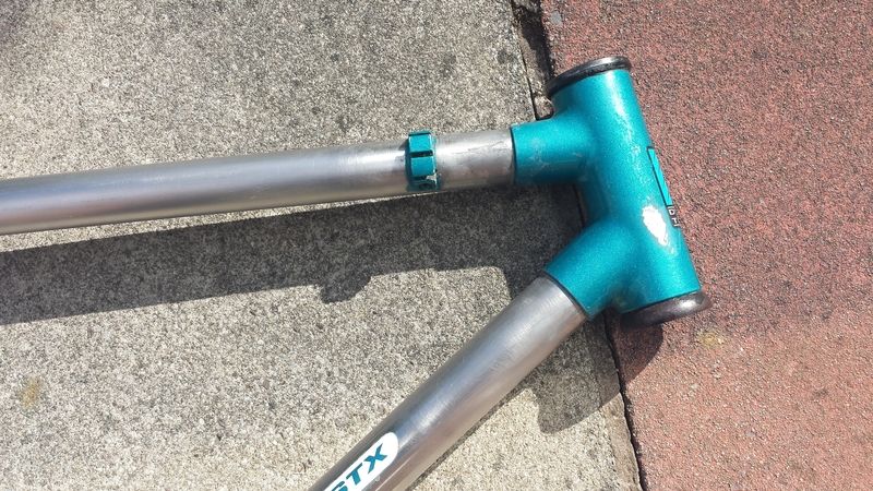

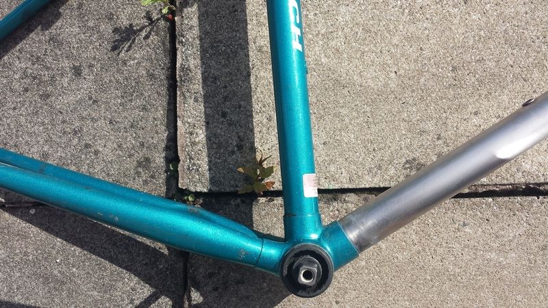

Right, I did a bit of gentle footling today : the paint is all off and I have got the frame ready for the next stage of fettling: more abrasives and then some Autosol.
So far it's been very gently sanded with 60 grit, 240 and 400 grit wet and dry: the 60 just to claw some of the really thick stuff off then going straight to 240 when I could see metal. After that, 400. Next will be 1200 then 2000. I am going to try using some Autosol on the actual wet and dry before a final polish with cloths.
I have left the cable guides blue, because I quite like them like that. I dunno if they look a bit tacky though.

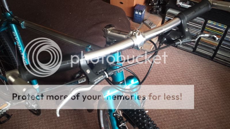

So far I have replaced the bar, the stem ( with a Marin one I had kicking about: gives the same riding position, but together the two save about 400g from the stuff on the bike when I got it. )
Wheels from Rampage. The previous owner clearly decided he likes red spoke nipples, so got him/herself some Humbrol and set to. :shock: :shock:
I don't have time to get all that off before Warwick sadly but hey: the rims and hubs are as originally specced on the bike and nice and light.
I had a 94ish LX rear mech, so that's gone on and everything's been given a good scrub/degrease and regrease, new bearings on headset and wheels.
All reassembled except grips, bar ends, chain and cables, then a good fettling.

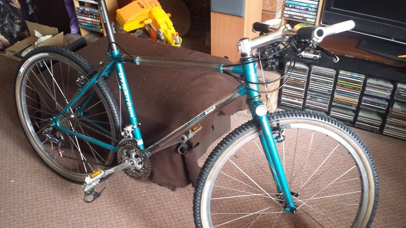

I WAS going to post some pics tomorrow, and I will, if nothing else because I want some pics of it in the sun, but I went ahead and did the main stuff - installed all the remaining bits and set up the brakes and gears.
It's completely rideable now, but I am going to keep the tyres nice and clean for Warwick ( yes, I know it's just a mid range mass market jobbie, but it's the only 94 Dyna Tech registered at last look and I think they were terrific and underrated bikes that tried something new. )
Anyway, here she is for now:
What's left? I am going to put a chainstay protector on, a little more touch up, a frame protector patch on the part of the headtube where the paint has completely gone ( one of those fake carbon ones) and get rid of the red paint on the spoke nipples.
And after Warwick I'll probably put a shorter stem and some risers on it :-)
I think it'll make a really nice towpath cruiser.
