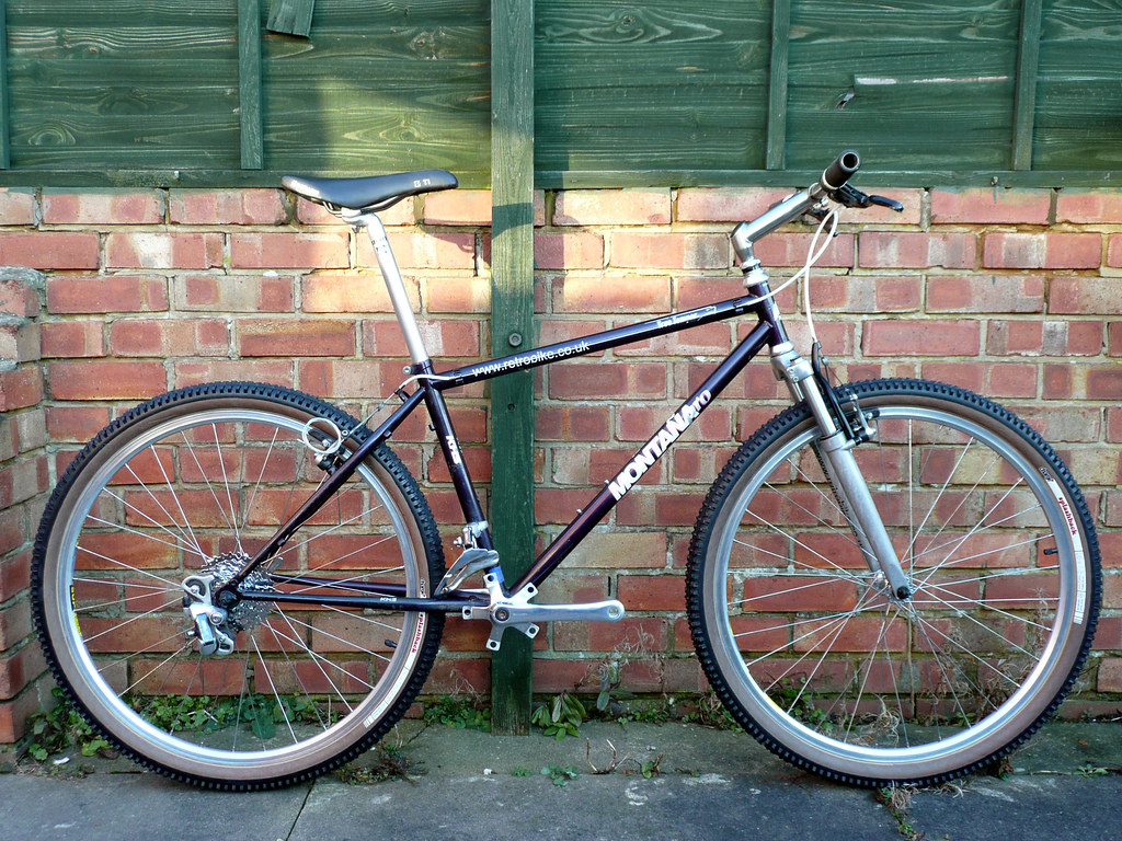

1993 KHS Montana Pro, virtually catalogue spec :D
Had to wait for the camera battery to charge :lol:

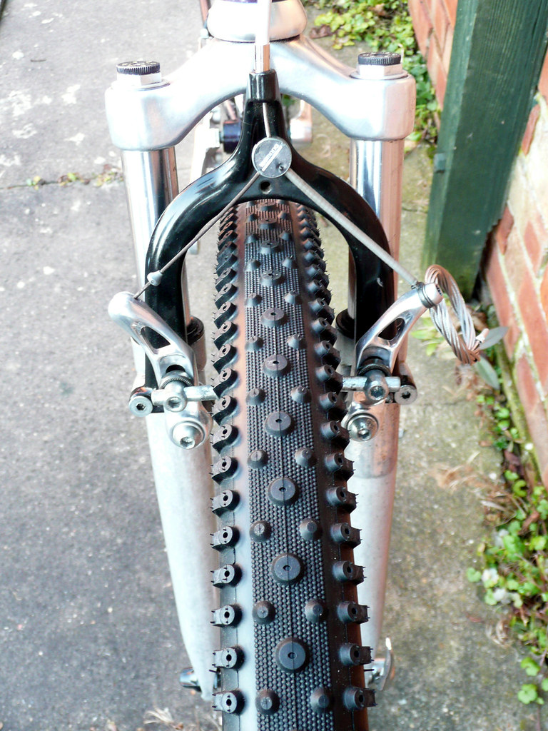

Anyhoo, new pics with modern Charge Splashback 1.8" tyres
Tyres are not as amberwall as the Tioga Psycho's in the background

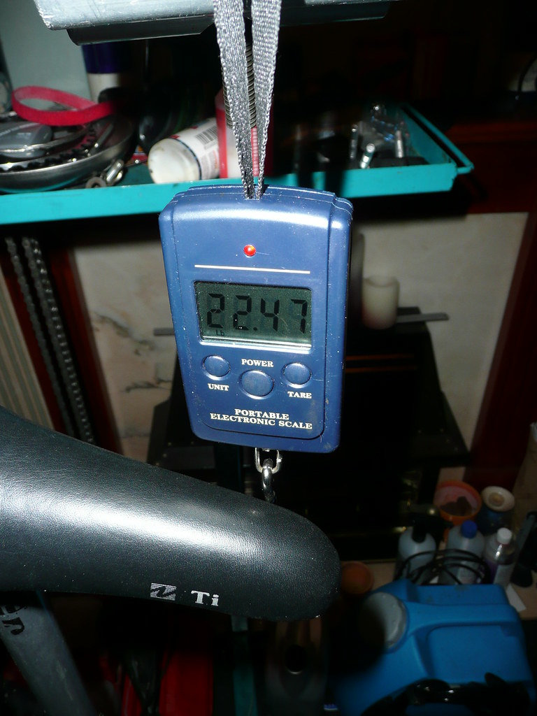

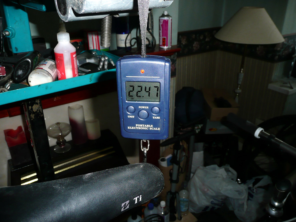

Yup, that's under 22.5lbs!
OK so there's no pedals on the bike, but the LX flatties only take it up to 23.35lb ;)

Looking good Andy, how much do those tyres weigh?
Shame to get it mucky tomorrow :lol:
Tyres are a claimed weight of 450g for the 1.8" ones, I weighed the pair at an average of 482.5g, so 32.5g over the claimed weight, still pretty light though.

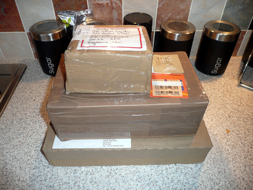

More parts have turned up today, it's like Christmas all over again :lol:
3 parcels to open
containing a new chain & cassette

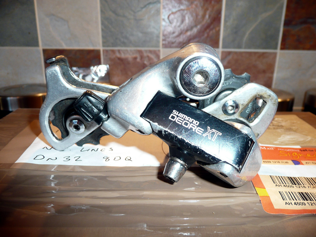

a usable rear mech which will be thoroughly cleaned up

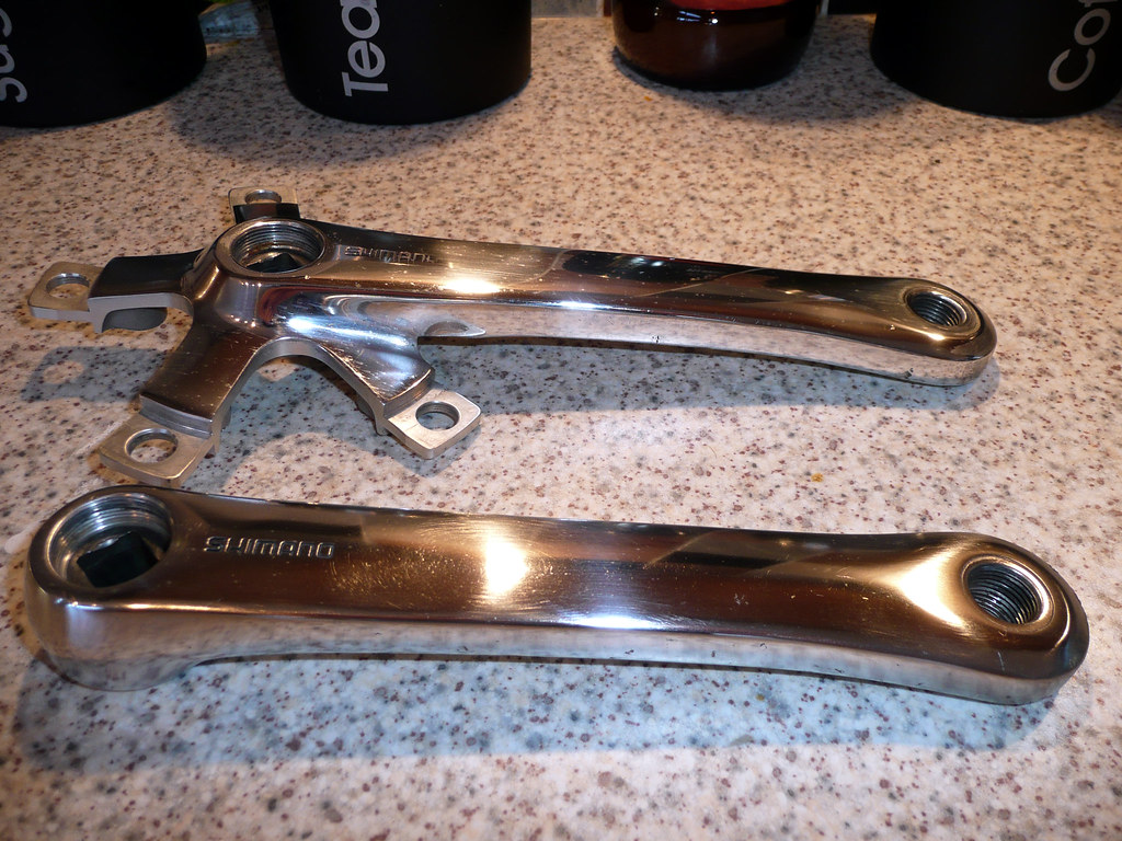

And these beauties
I've fitted the parts to see what they look like on the bike, the rear mech will be cleaned up & I managed to get outside in the daylight to snap a few quick shots

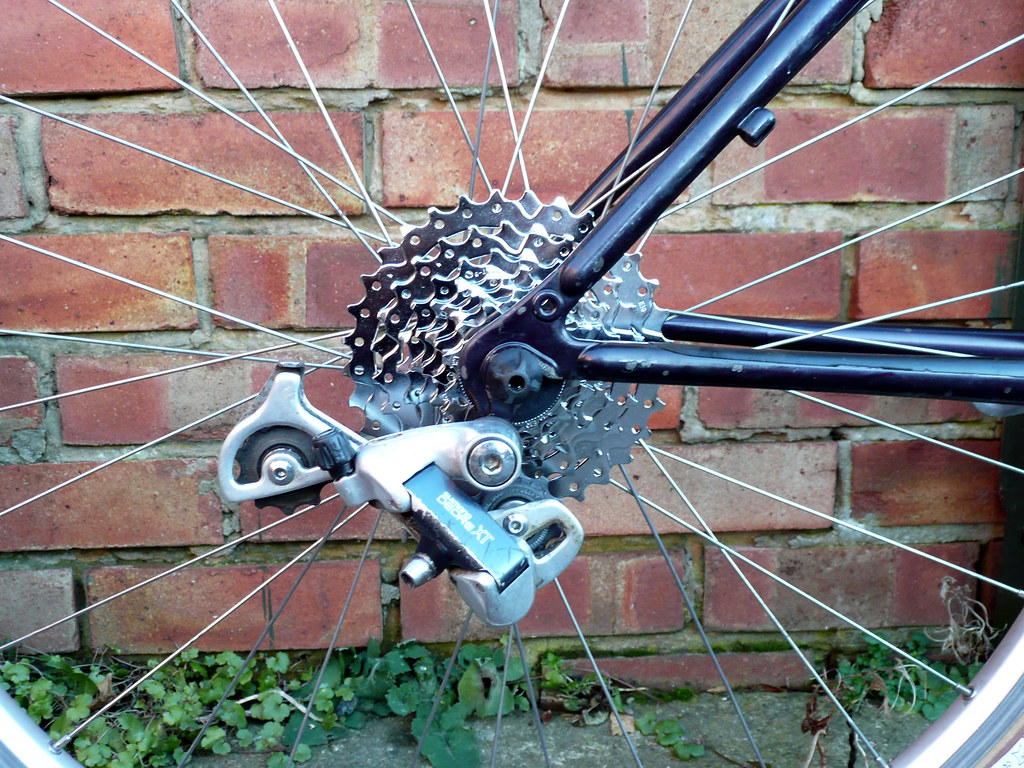

Rear mech and cassette

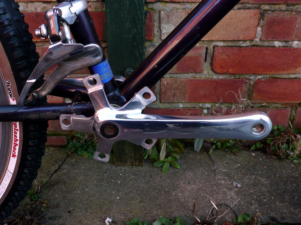

Cranks
Tyres & quickly polished canti brakes
Weight (without chainrings, chain, gear cables, gear shifter pods & pedals)

Keep the cantis by the way - they're actually lighter than the M734 ones! Interestingly enough the Roberts Dogs bolx SE was fitted with exactly the same if I remember right (there's an article on this site somewhere) so the bike will be in good company 8)

I quite like the canti's when polished up they look pretty good for Alivio :lol:

Just measured the chainline & it appears to be ~45mm (cranks not fully tight on BB) so I think I may need a new BB that's longer, Sheldon reckons it's a 122.5mm BB for a M730, no idea what's in at the mo but Sheldon reckons it should be 110.5-113mm as it was an Alivio MC10 RH crank
Anyone used a 122.5mmBB with M730 crank arms? Does it work as it should & give the right chainline?
Coming on really well andy,, pleased the cranks arrived :) , if its any help I run a 125mm square taper on my Look with XT cranks :)
