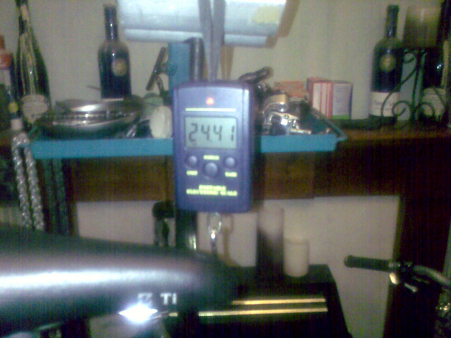

Just done a final mock up with a 2 x 7spd set up as I'm awaiting delivery of the inner bolts I just ordered
Weight @ 23.6lb without pedals
No pics until she's stripped down and thoroughly cleaned ;)
Indeed, pretty lightweight, especially considering the total build cost of ~£400
Reckon with modern XT pedals & inner chainring it'll be about 24.5lb
We do have some very nice lightweight Xpedo SPD's @ work 275g, compared to XT's @ 352g, might just have to try them ;)
I have now fitted the inner chainring and a pair of SPD pedals, the KHS is ready to ride!
Only one teaser of a pic as I now need to get polishing her up before doing proper photo's
Ready to ride weight of 24.41lbs/11.07Kg
Really should clean the lens on my phone :lol:
