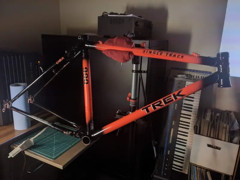

Here it is cleaned up and stripped of parts.
I was going to build the bike up with as many neon orange parts as I could find, since I don't like 3DV or Turq ano, or most flashy ano for that matter. The early 90's neon is more my style.

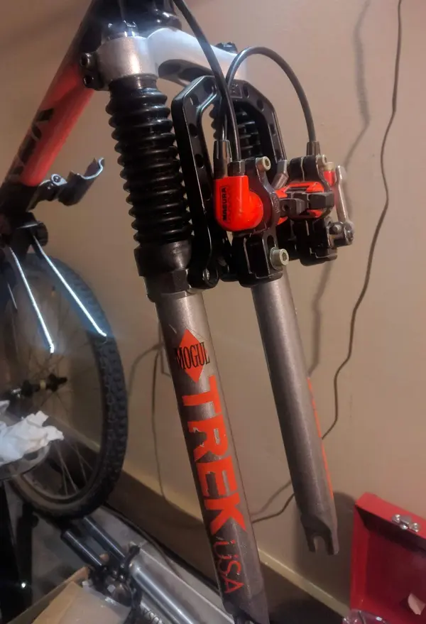

I found a matching Mogul, and some Maguras, even a Taper Lite, but after I started fitting parts, I realized that I was going in the wrong direction, and needed to find a more simple theme. I already have a '94 Marin Pine Mountain that I have fitted with my favorite fork, and my favorite cantis, and it's the perfect platform if I want to try out Maguras. I needed a simple 1991 high end bike, not an upgraded to 1994 standards bike like the previous owner did.
I stripped the bike back down, put the Moguls back together, and let the bike sit in my stand for a few weeks while I thought things over. In the meantime, I bought a matching Tange Big Super Fork, with a perfect length steer.
Over the next two years, I worked on other projects until I found the theme. I started sourcing Tioga parts, after I found a NOS black T-Bone seatpost in a rare 29.8mm size. The bike was already fitted with a Tioga headset and stem, and I just recently discovered the Tioga catalog from '92, as well as the video catalog that was posted in late 2020. After I realized they made a lot of neon orange accessories, as well as sleek black parts, I settled on an all black with subtle orange accents, courtesy of Tioga! I will be posting more about some of the parts that I have selected for the build in a little bit, after I clean them up and take some photos.

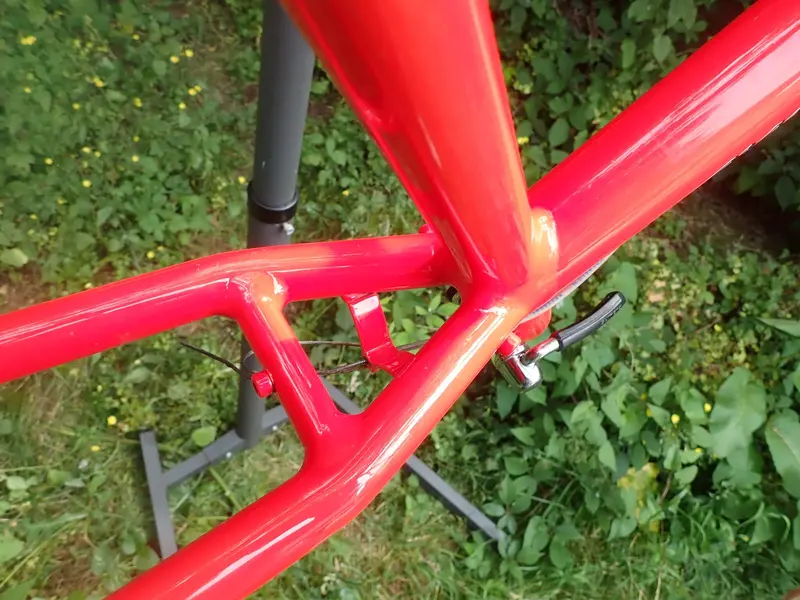

It took a few months to go over the frame and touch up all the blemishes. I didn't do a perfect job, and the Testor's model enamel I got was not the exact same black. I can only tell under direct light, so I'm not worrying too much about it. It was super thrashed, and could have easily been tossed instead of donated to a thrift store, so this is worlds better than it used to be. I think that maybe the white primer and orange paint under the black has something to do with it. There's also clearcoat over everything.
How the chainstay looked after cleaning only. Previous owner tried to touch it up at some point, before more chain suck caused this.
This is after some wet sanding and a little bit of filing, to take off the high spots. I would go on to sand a bit more, mask at the lug, and at the top and bottom of the stay, running down the side to cover some of the smaller, thin sections.
This is after two coats of paint, lots of wet sanding, polishing, and finally a coat of carnauba wax. You can see where I wet sanded through a bit down to orange, on the underside below the left light glare. Whoops! 😬 Too late to go back and do another coat. I can barely notice it, and I've already rubbed through one other touch up, so I guess my blemishes on this bike have already begun! Whatever, it adds more character.
