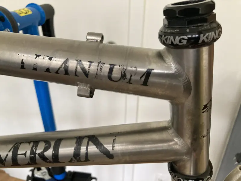

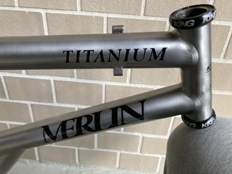

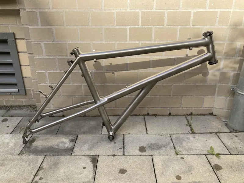

Next up was to apply the nearly 30 years old decals. This became the most nerve-wrecking job! Stickers wouldn‘t stick, the appliqué wouldn‘t loosen. It seemed impossible to complete and the instructions not matching the type of decal (use water to loosen and hair dryer to melt the glue into the surface). And only one attempt! It took all my patience but after two days of sweat and tears with a few minor glitches it was done :oops:

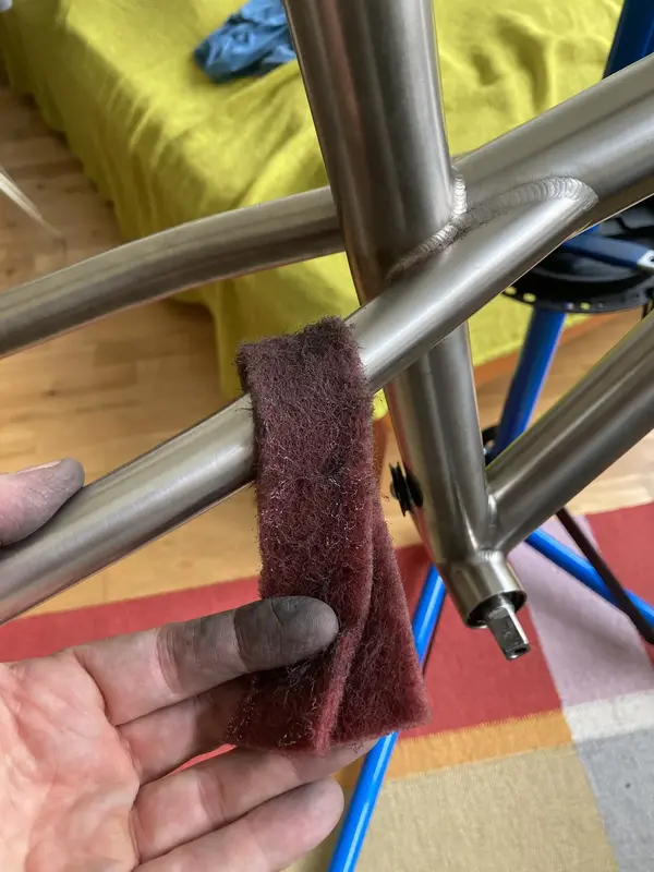

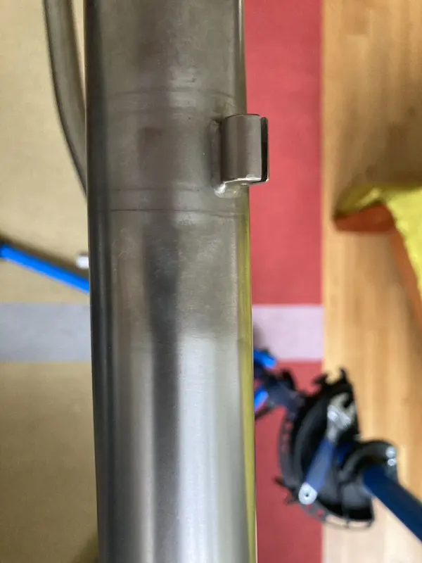

The manual suggests to finish the frame with Lemon Pledge which seems unobtainable here in Germany. A guy working on a titanium frame on Youtube suggested to use WD-40. This stuff works like it was made to finish a titanium frame (seems like in a way it actually was).
Great work!
And yeah, WD-40 for the win.
I use it to finish all my titanium bits and pieces. And a bunch of other stuff too! It's actually better as a cleaning product than anything else.
I first got it to use as a penetrating oil to treat stuck cranks and bolts.

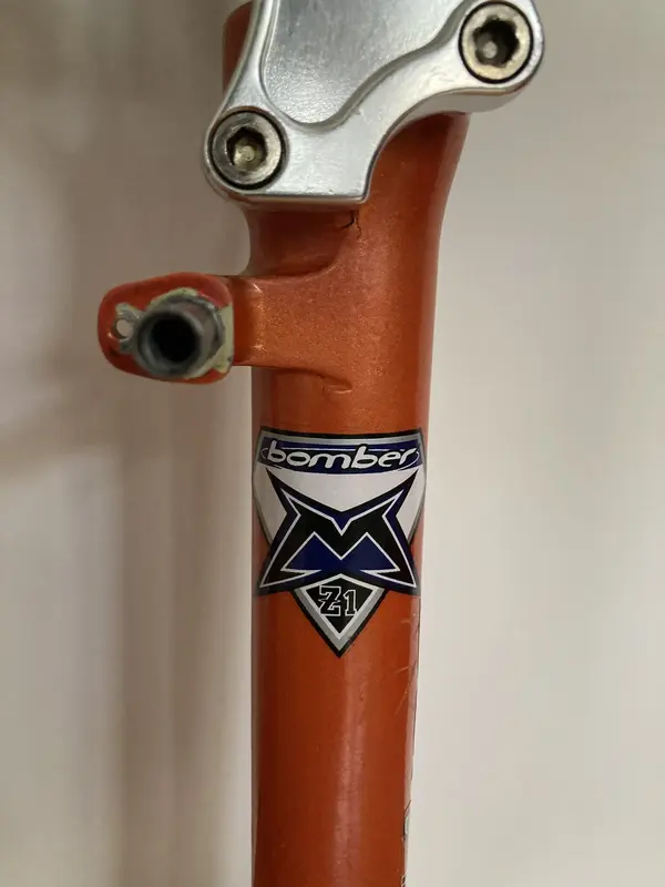

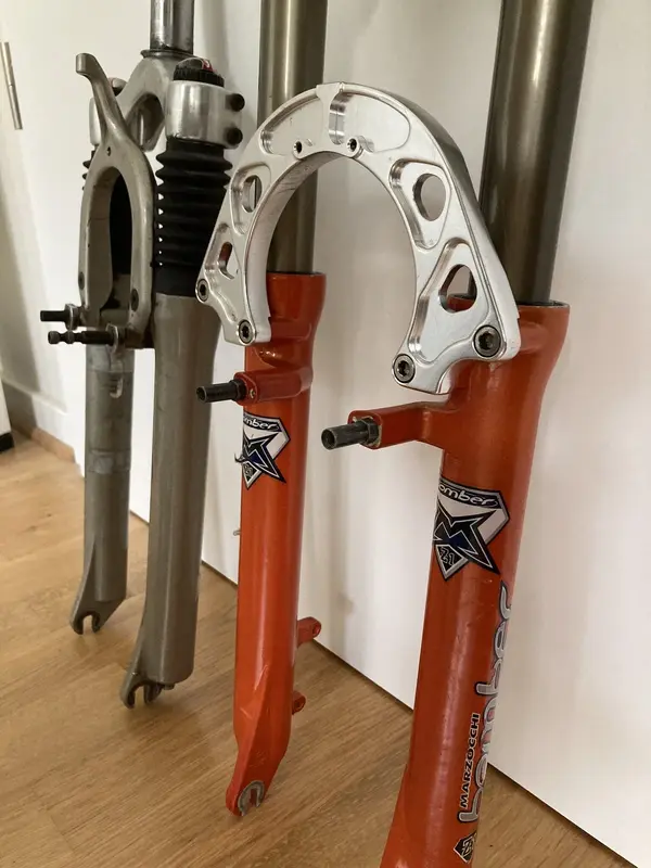

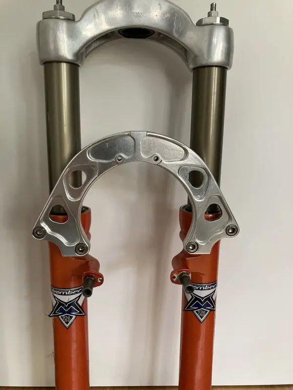

Coming back to mountainbiking after a 15 years hiatus and having relied on my trusted bike dealer in the past, it’s amazing to see how bike technology has evolved over the years. The plan is to fit a late 90s Marzocchi Bomber to the Merlin replacing the Judy. The Merlin being from the early 90s requires a 1“ steerer tube. Pretty much all Bombers that I‘ve seen in the market place have 1 1/8“ steerer tubes. Even though the old catalogues list 1“ steerers as an option, there probably weren‘t many being sold.
I‘ve reached out to Dr. Zocchi to buy a rebuilt Bomber from him but was told that he‘s currently or no longer doing rebuilds. So I‘ve decided to get a fork and service/rebuild it myself. Replacing the steerer tube by a 1 incher (pressing it in) can still be done by Dr. Zocchi.
I‘ve gotten a Bomber Z1 so far and since it’s really hard to decide based on pics and numbers, I‘ve also secured a Z2 bam in black. The Z2 to arrive next week. When comparing forks, weight, bike geometry and color all are concerns 😗
Opinions, ideas, hints are appreciated…
