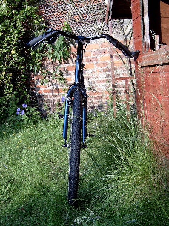

Finished
Well, as of tonight it's finally finished. Here are some photos that still don't do the paint job justice - it's really hard to catch the colour of it:
I know it's hardly a traditional build, but it's been built to match my requirements as much as my taste.
Any feedback, good or bad, gratefully received.

Looking great Will 8)
My 1990/91 & 92 Karakorams all take 26.4 seatposts despite changing to True Temper tubing in 92.
Thanks Chris. I've ridden it in to work today and it's really smooth, plus the amount of feedback and handling is feeling really good.
