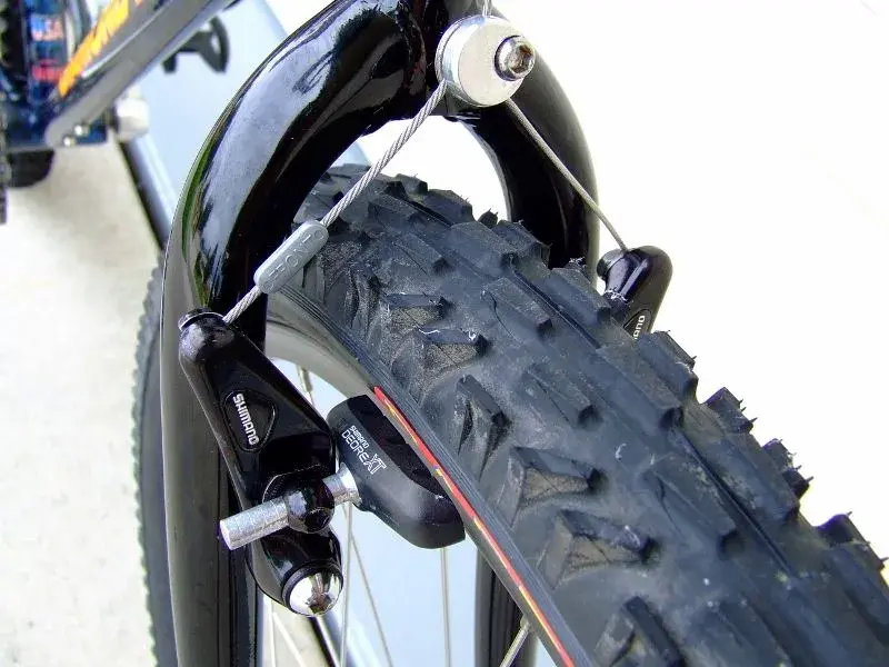

Can't believe you caved on the valve caps... :lol:
Quite a result, you've every right to be proud of that!
(the brake pads don't really hit the sidewalls do they, it's just a funny angle...?)

It is a funny angle, the brakes work perfectly.... We wouldn't go to this level of detail without making sure the brakes were dialed. :xmas-wink:
Awesome bike! I have the same magazine, although with a torn cover :( Being a stickler for attention-to-detail on my own builds, found a couple areas to improve as you tweak your build over time:
The brake straddle cable is backwards, as the word "front" or "rear" should be facing outwards. Also, the ones on your build are from the DX & below brakes, as the XT ones had an allen bolt that recessed into the front of the holder, like this:

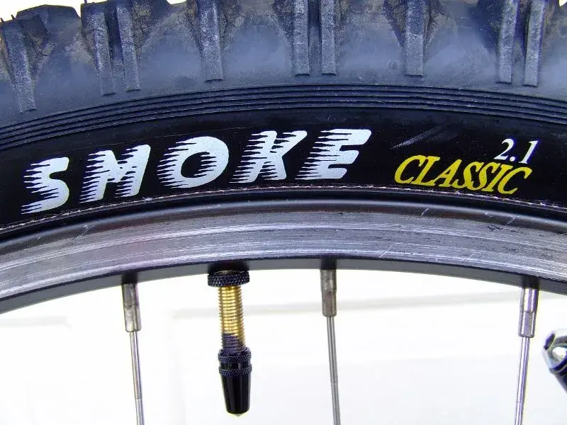

Also nice to see you caving in to use the valve caps as a finishing touch, but I would use a collar also, as this would cover up the valve hole & center the valves a little better. If you want to go all out, I would recommend some anodized aluminum covers & rings from Purely Custom: https://www.purelycustom.com/c-38-prest ... llars.aspx I use them on all my builds & I really like how it gives that finished look, like this:

Also a detailing tip: one way to get rid of some of the rust from the inside of allen bolts is to take a corner of a scotchbrite pad, twirl it around in there a few times, & finish it off by dipping some Qtips in rubbing alcohol & cleaning it out :D
Great "tip'! No pun intended.... will definitely take note and make sure to do this.
Thanks for the feedback!
