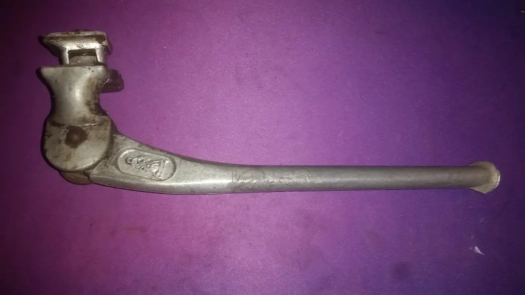

Just ordered a new kickstand thanks for the link middleworldbiker I'll be getting new tires, inner tube, rim tape and brake cable so I can get him on the road again and ride it safely.. I didn't mention it but there was a R.I kickstand on the bike... it's beyond repair though.
