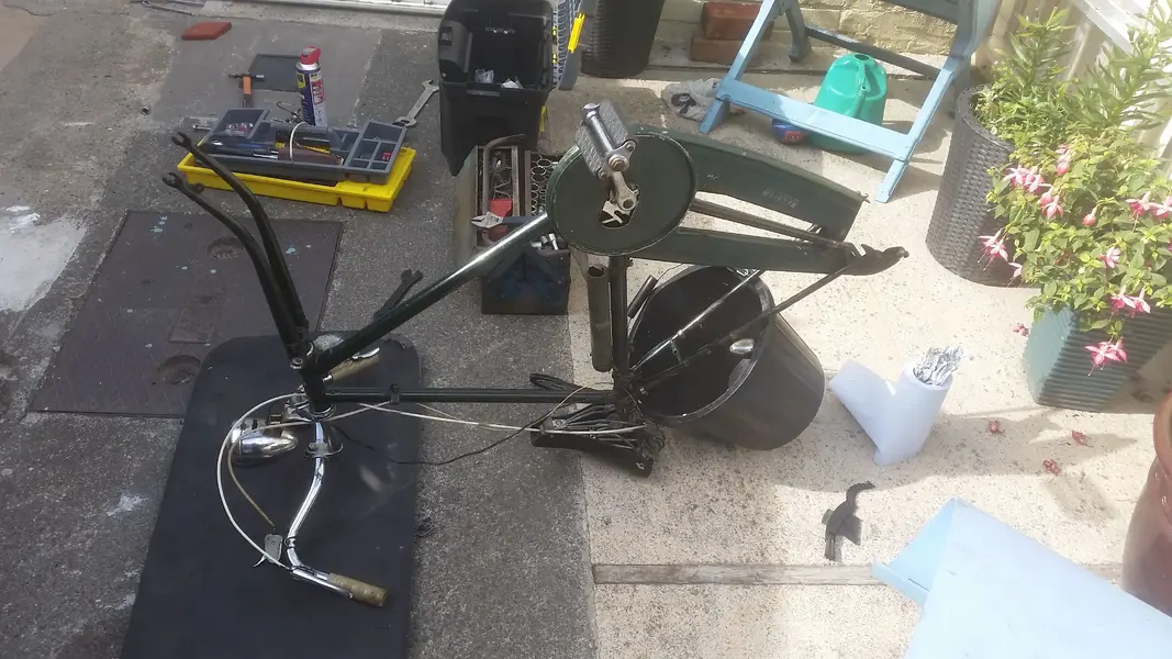

karinexmachina
Re: Raleigh 1961 superbe
I had the bike apart to clean but my chain tools are crap so I've left the chain as is.

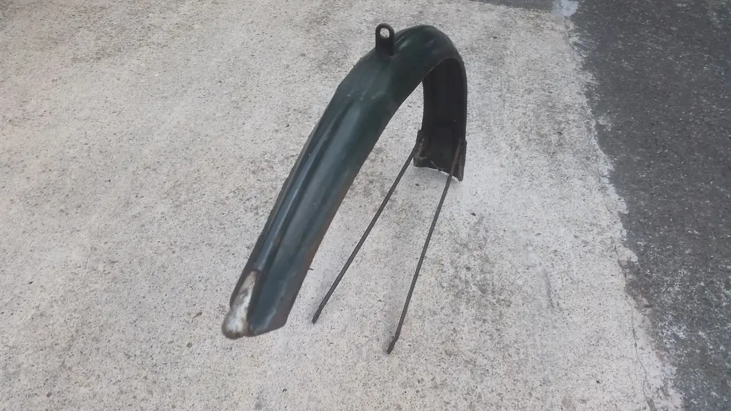

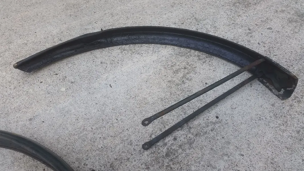

Re: mudguards
Mudguards... possibly the first things to go on these bikes
