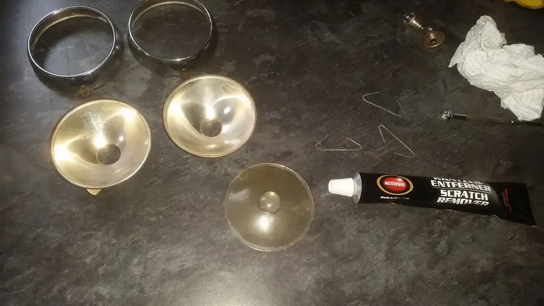

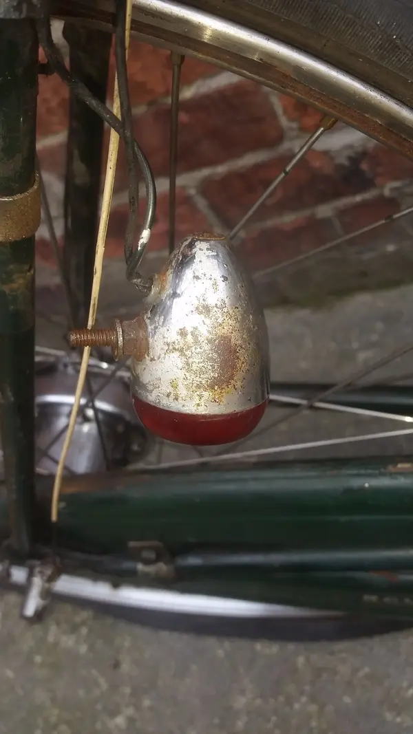

Thanks Keith. I'll be taking some pics of the bike in a bit I took the lamp to bits as I have some spare parts. Anyway I can clean up the mirrored metal without damaging it, it appears to be plated. I was thinking of using scratch remover on the plastic. I've been apprehensive with these parts

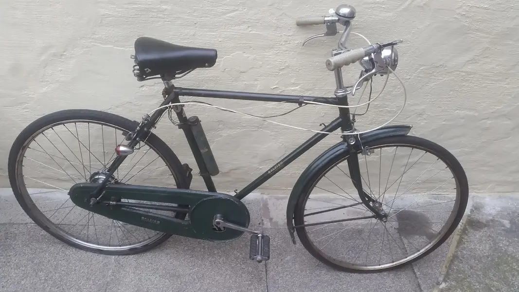

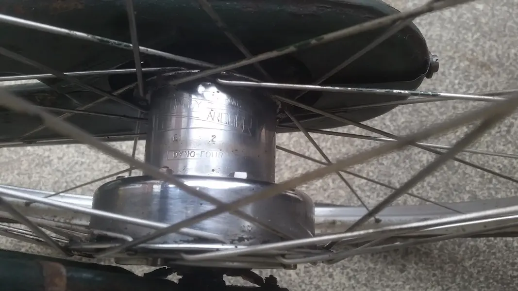

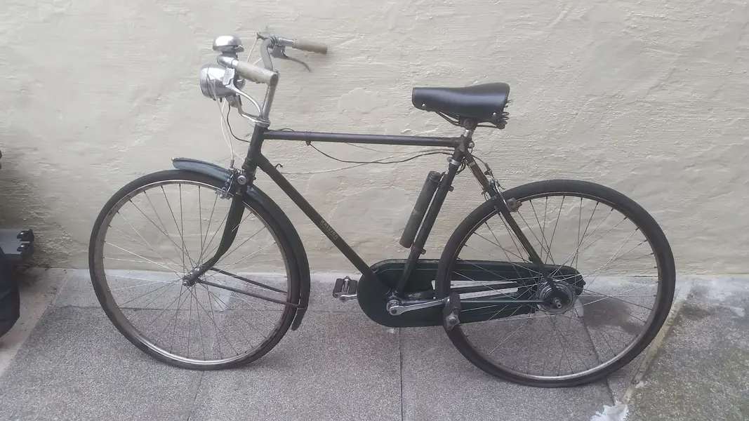

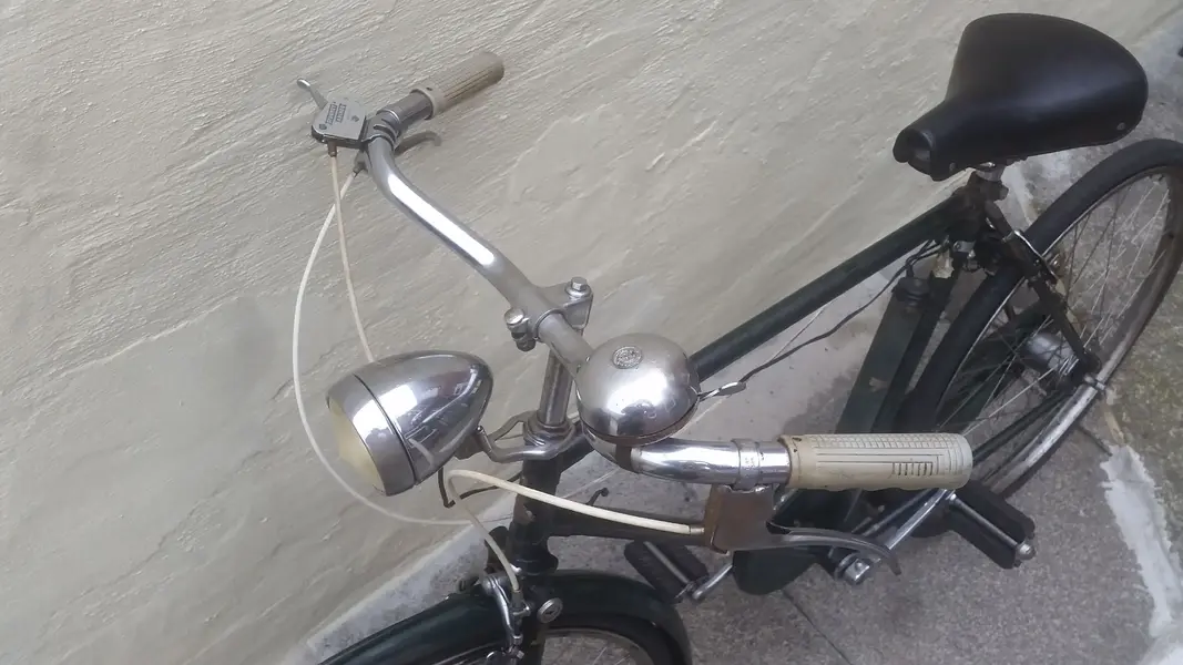

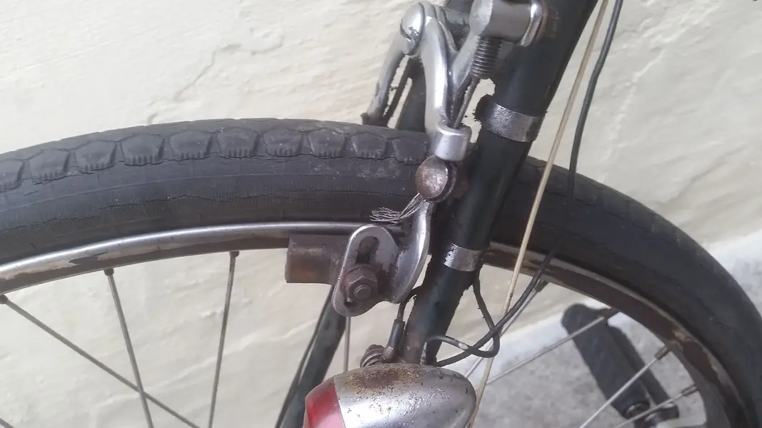

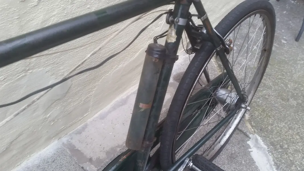

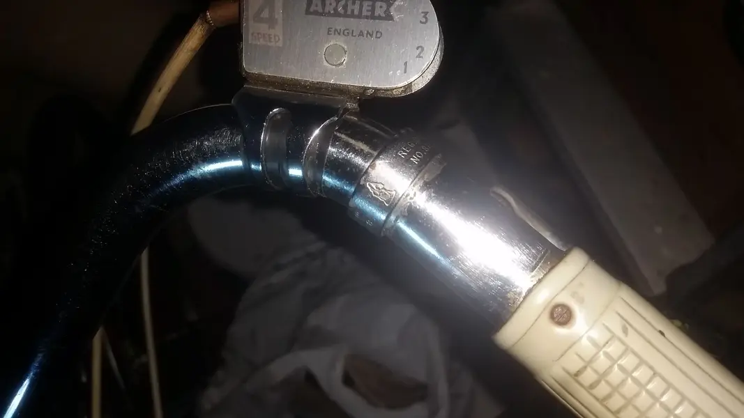

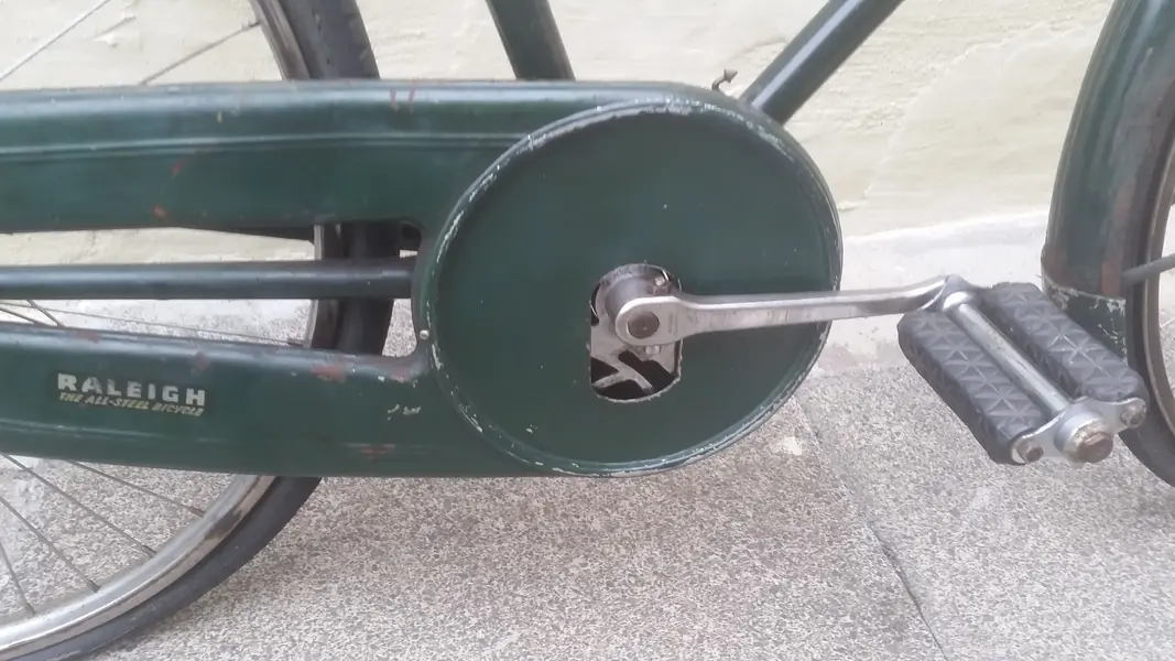

Here's a few pics of the bike partially built. Still working on parts the cable clips are hanging around still.

Re: 1961 Raleigh superbe
The lamp reflector was silver plated. The brake levers do not look anything like Raleigh. It is easy to solder the brake cables, but more difficult on an old cable. The chainwheel cover is the wrong way up.
The rims are stainless steel, you will notice that the spokes from the inside of the flanges face opposite directions. All professional wheelbuilders did this as it is the easiest and fastest method. A factory time for lacing a wheel would be around 2.5 minutes.
Keith

Looking closely at the superbe in the 1962 catalogue the brake levers do look matching.

Hoping to seal up the lamp after getting the parts cleaned. Using rubber seals and silicone grease. As for the hole where the wire goes I thought of possibly using a cross slit valve and attach it inside the lamp... not sure if it's a good idea but it's an idea..

So the front lamp has cleaned up pretty well. It's still cloudy and yellowed and the tail light... I don't know how I'm gonna get this apart
