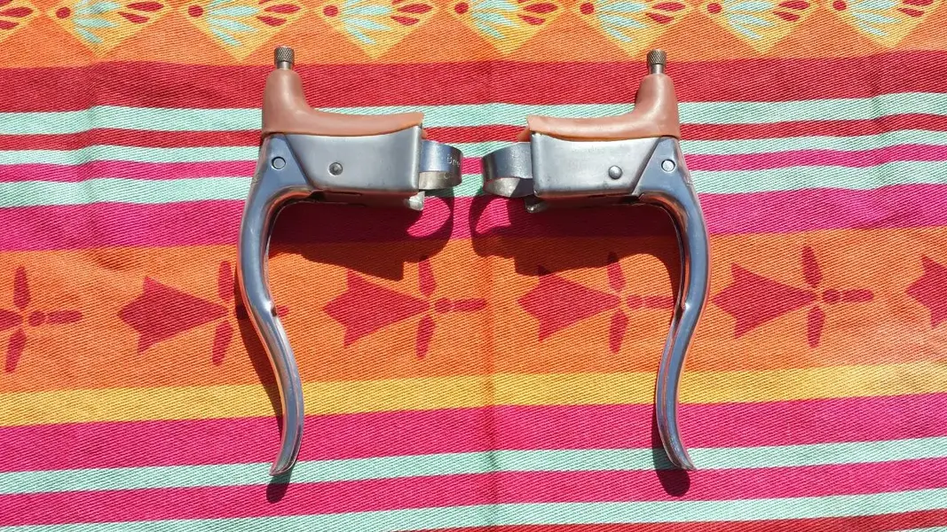

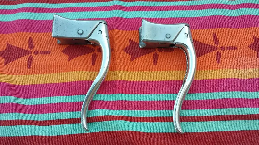

1960 Peugeot PX10.

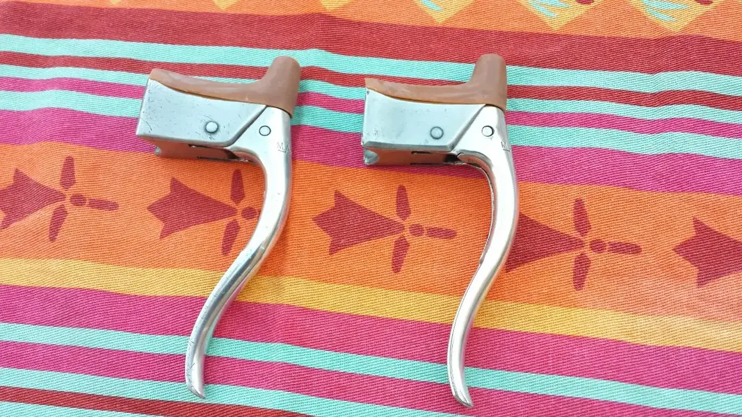

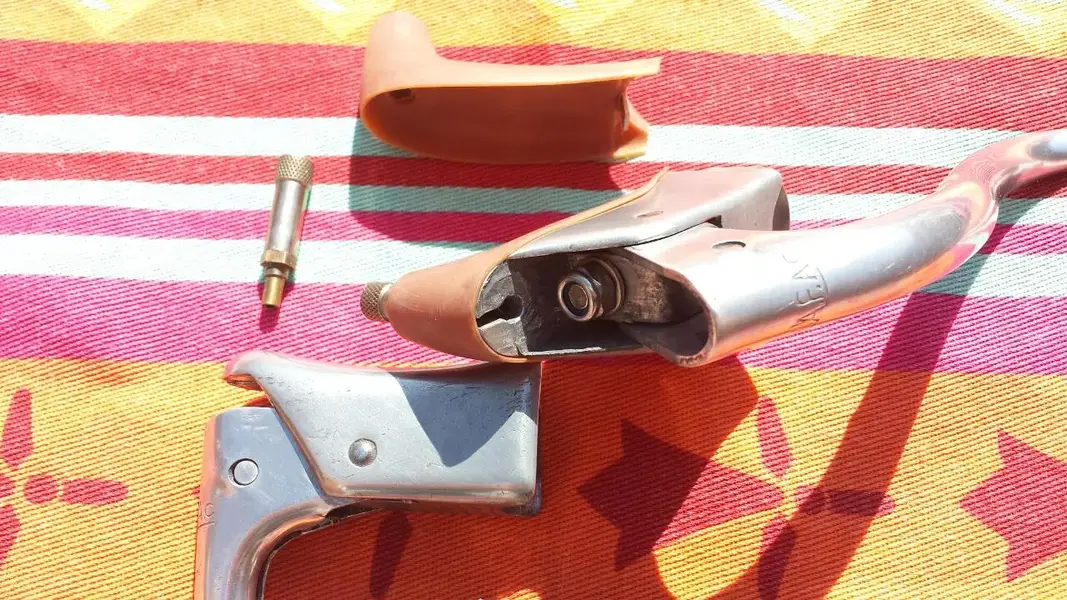

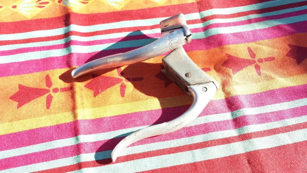

Mafac brake levers are the 3rd generation type with half open back to the lever. Polished these up same as bars and stem with wet & dry paper followed by a good buff with Solvo and new stainless nuts & washers fitted. The original blue half hoods were shot so I've used some gum hoods by Rustines... at around £25 it's a shame they're not half the price. :roll:

You’ve done a great job with these as they have come up really nice. I like Mafac brakes both for form as well as function. These fit with the rest of the build for sure
Jamie

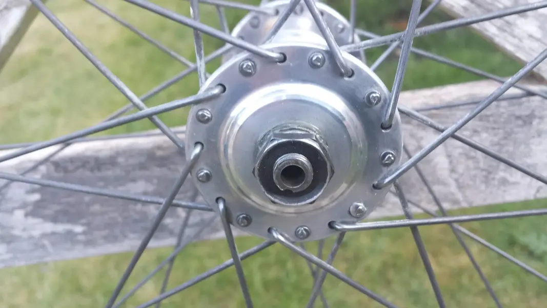

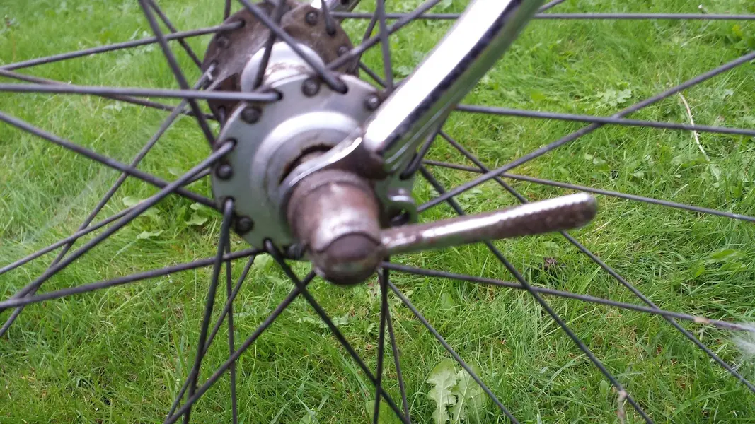

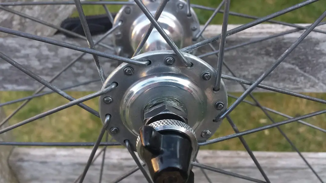

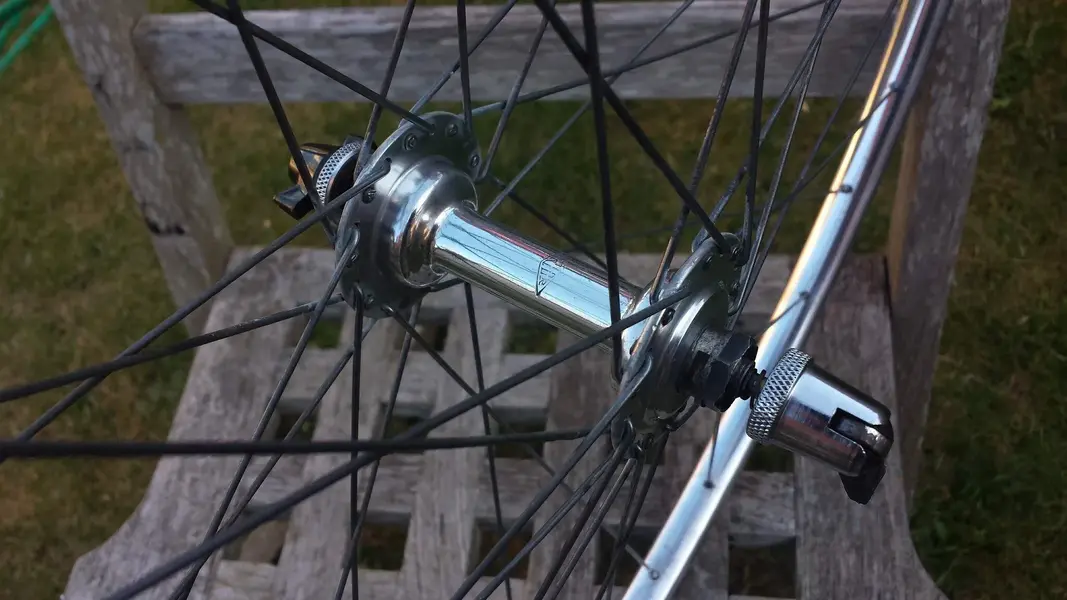

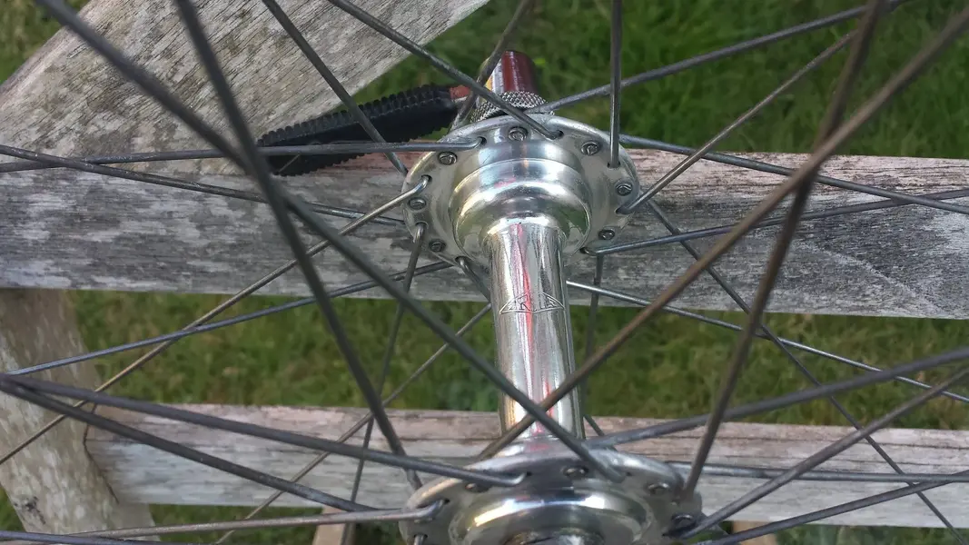

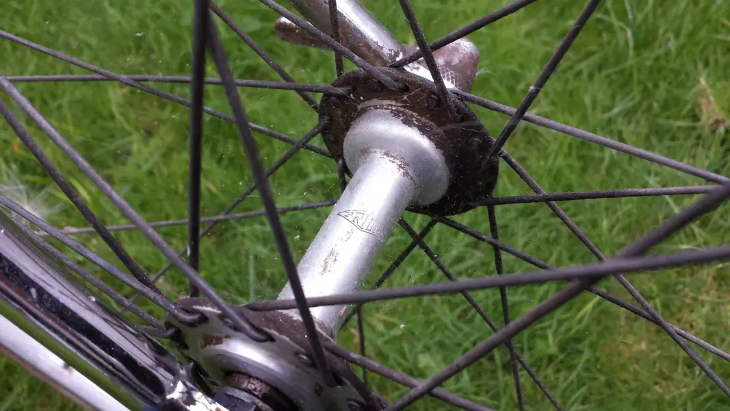

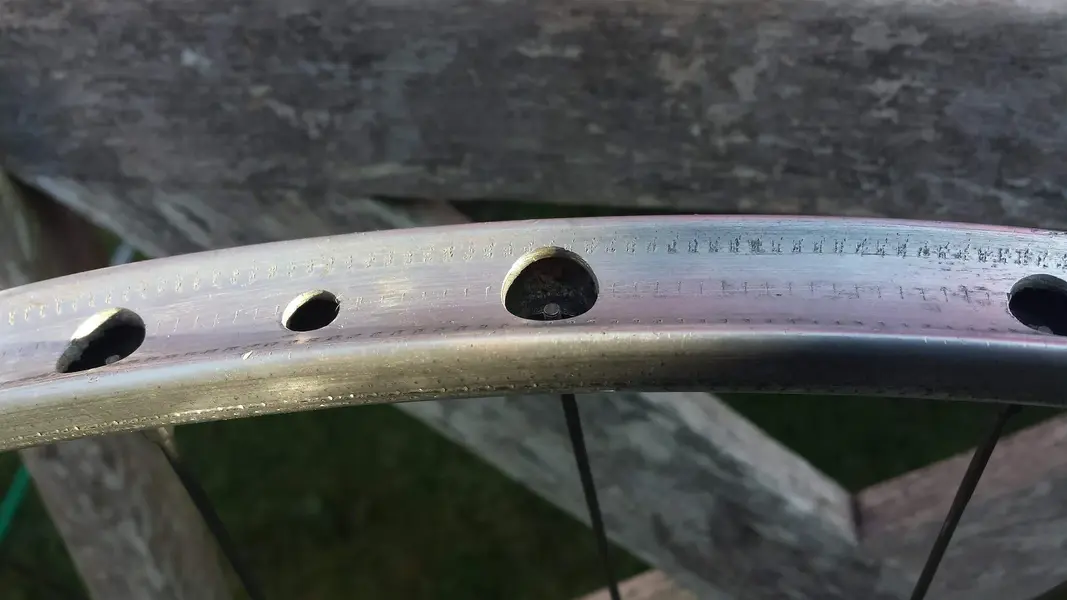

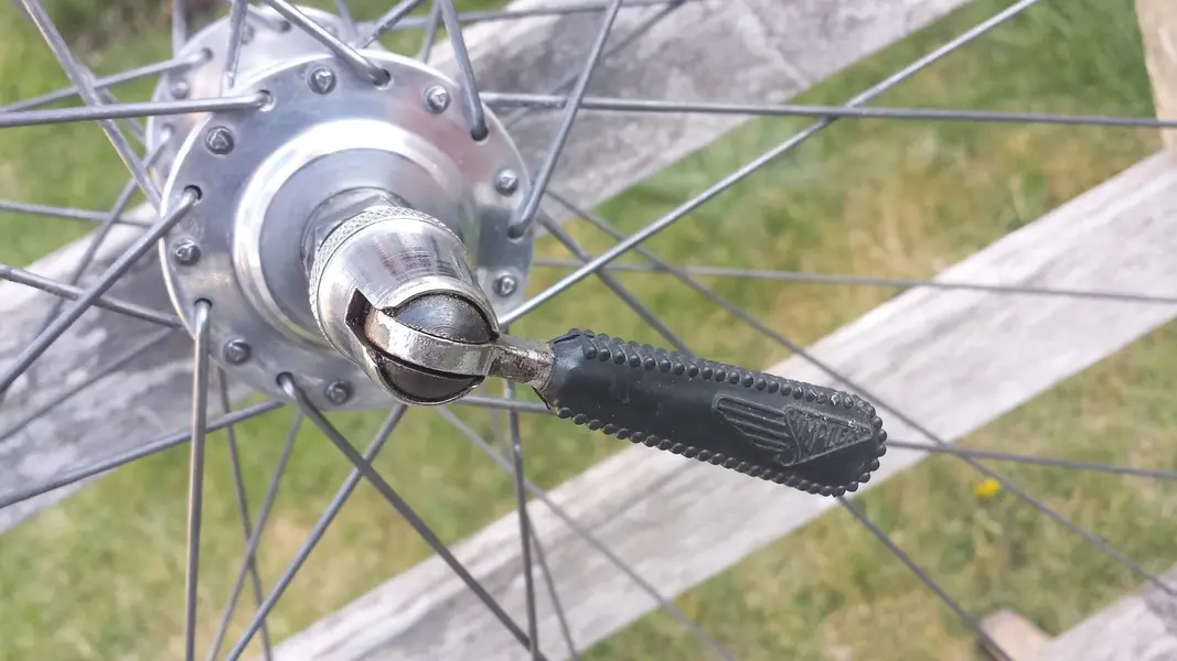

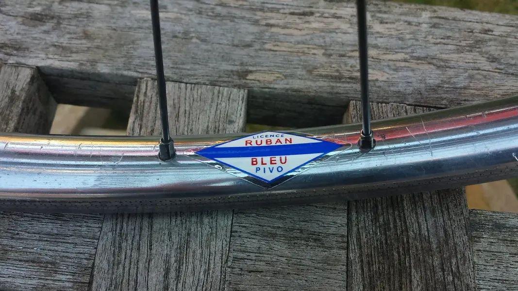

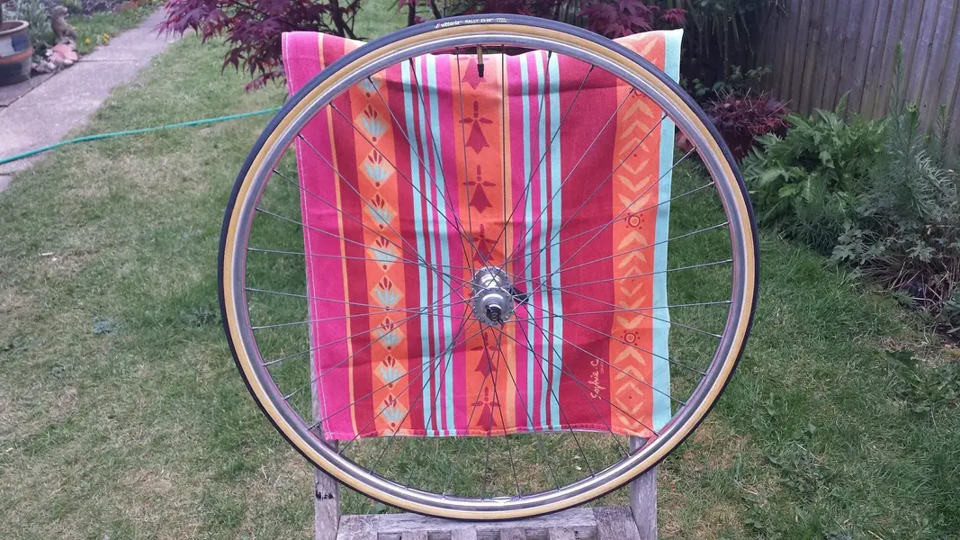

The original front wheel looks to be in good condition with all of its original rustless spokes so I decided just a clean and polish would suffice rather than a full rebuild with stainless steel spokes. The 36 hole Prior hub was striped and degreased again keeping the bearings and cone's for each side together to ensure smooth running. A soft toothbrush was perfect for getting into the difficult area around the spokes with Solvo Autosol polish. With a final regrease the mint condition Simplex skewer was fitted. 20170928_173747.webp 20170928_173948.webp 20200416_181452.webp 20200416_175122.webp 20200416_175221.webp 20200416_175303.webp 20200416_175344.webp
That came up mint ..this is gonna be a beautiful time warp machine 👌 can sense it’s getting close to the final build & test ride.
Cheers scooter, pleased you like it... not too far away from my favourite part of the restoration.. the build up. Just got to re-grease and finish cleaning and polishing the rear wheel which will hopefully come up as nice as the front...☺
20200416_175232.webp 20200418_190815.webp 20200418_190920.webp 20200418_190733.webp

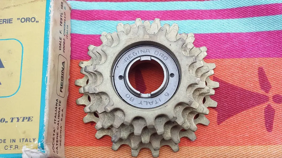

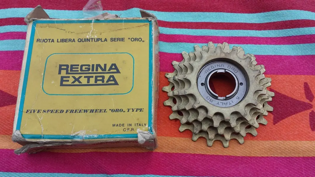

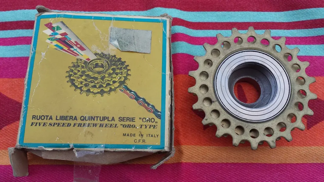

The original freewheel that I'd striped and cleaned was showing signs of wear in the bearings and on the sprockets, would have probably ended up sliping with a new chain so I thought I'd treat Pugsey to a new one.... Okay I know it's not French made but finding the correct French threaded NOS freewheel is getting harder. This Regina five speed 14-22 came up on eBay in Spain.. won it at thirty quid, a bit of bling but as it's a service item i hope that's okay.☺
